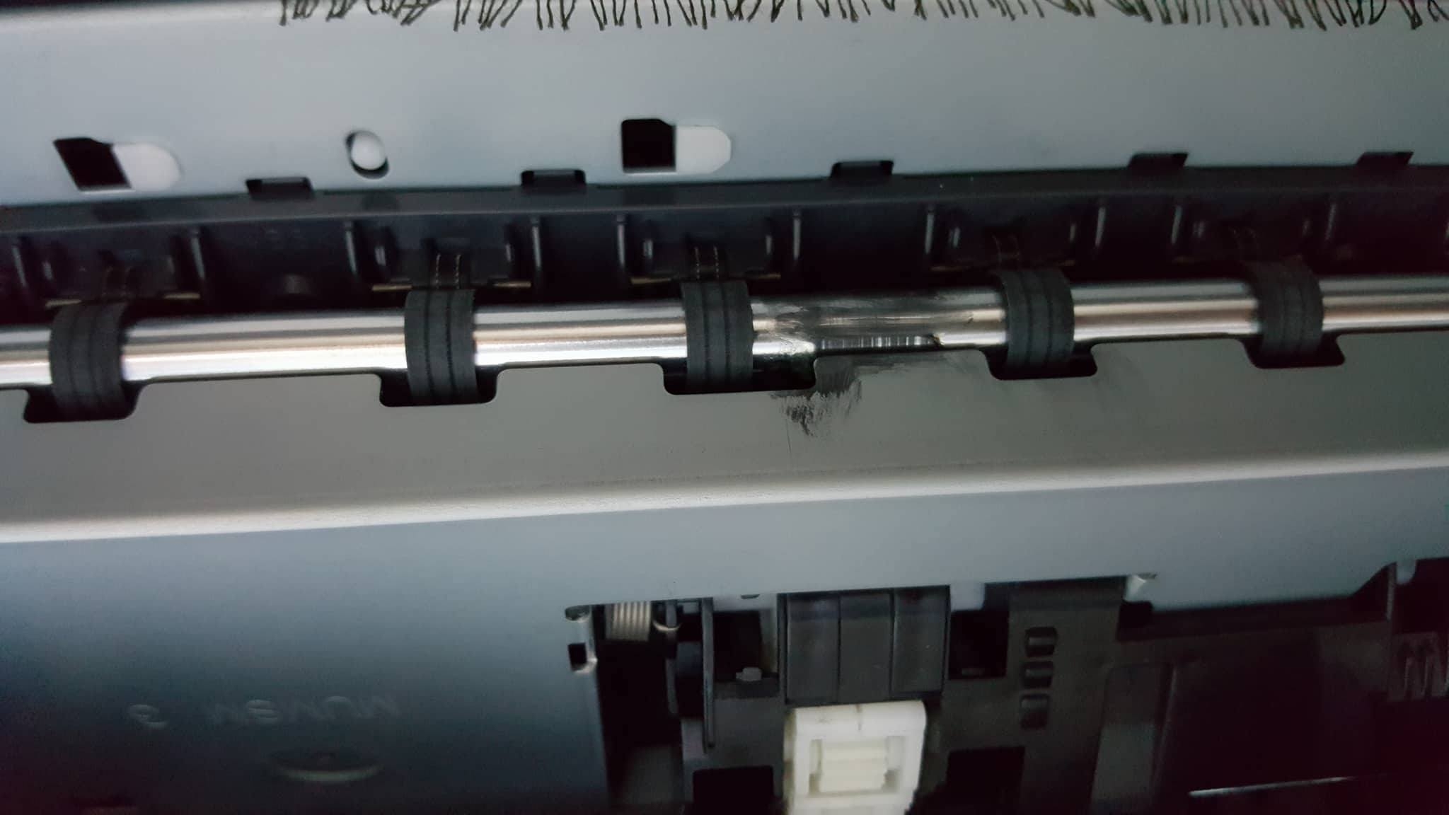

    The printer printed about 10 pages in black on Monday.
    I couldn't print anything correctly on Tuesday, what does that mean? Black ink did not print the middle, i.e. if I wanted to print the text, only the top and bottom of the letters came out of the printer, when we say that I wanted to print a man, I got something that has only legs from the knees down and the head, and the whole body got stuck somewhere.
    After a few attempts, nothing was black at all.
    I have cleaned the printer system many times but it doesn't work, I changed the ink to a new one, still nothing ...
    Today, after two days when I did the test print, half of the black went, the second and the next time not anymore.
    Is this famous head still clogged? If so many people have seen that he pours the solvent with a syringe to help. I have never repaired a printer in my life, what solvent, how much to pour it and where?
    How to check in a simple way whether this black ink gets from the container to the place where it is picked up and followed by printing?
    PS. I also noticed something black on the "cylinder", maybe it has to do with this problem?

    Look for "Brother head unblocking fluid" there are quite a few products for this purpose, buy a syringe, a piece of hose and act.
    The topic is quite well described, among others here: https://www.elektroda.pl/rtvforum/topic1844500.html, there are movies on the net.
