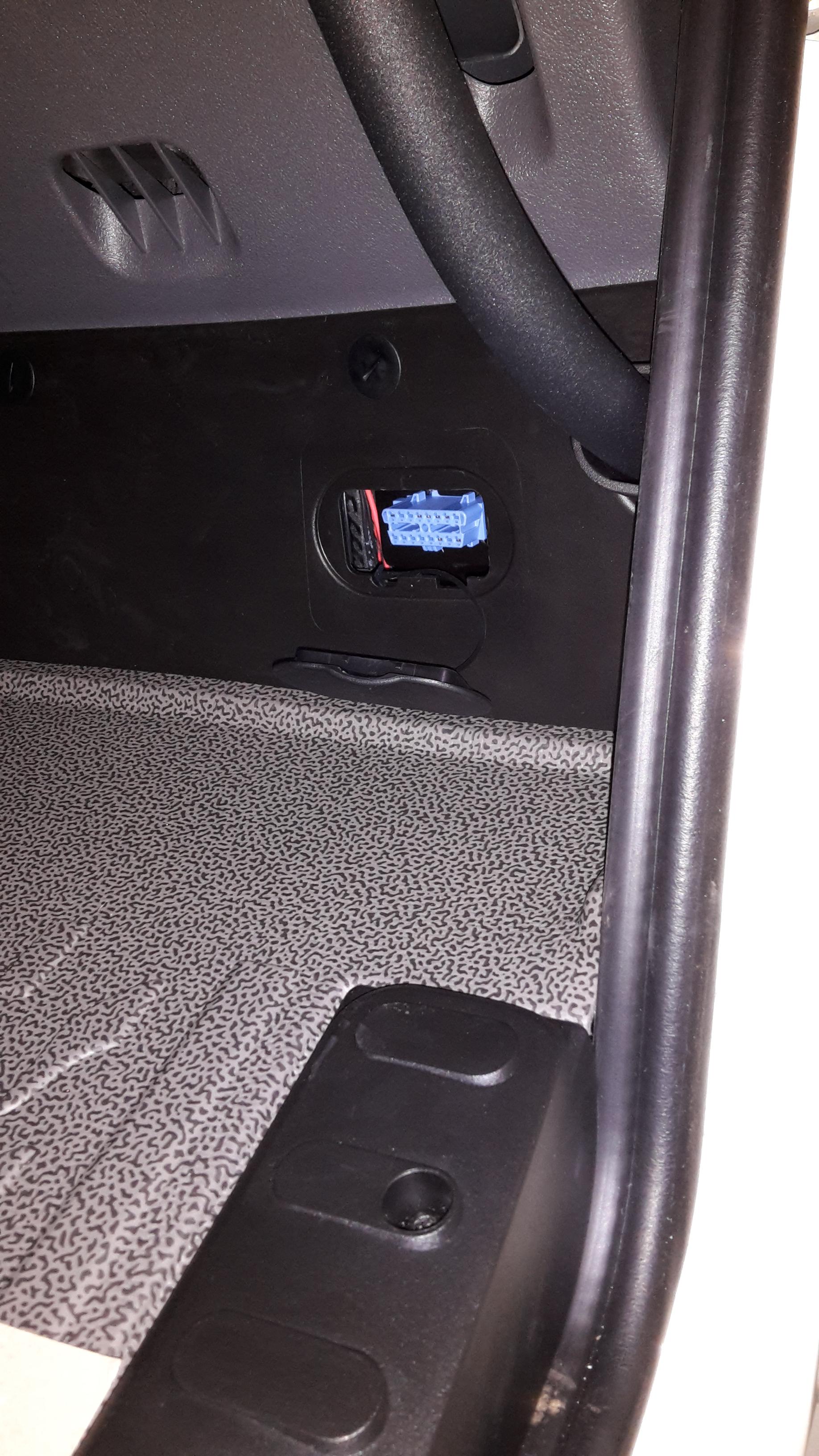

    Hello. I am asking for help locating the DAF XF106 diagnostic connector. Thanks in advance

    In XF euro6 the OBD socket is located under the plug in the passenger side console. Bottom right corner. At my feet. best regards
    • Locating DAF XF106 Diagnostic Connector: Help & Guide for DAF XF Truck Enthusiasts 20171003_102605.jpg (678.52 KB) You must be logged in to download this attachment.
