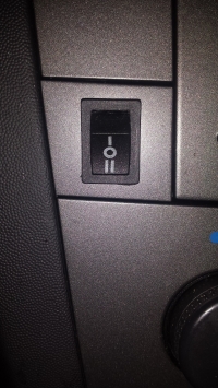

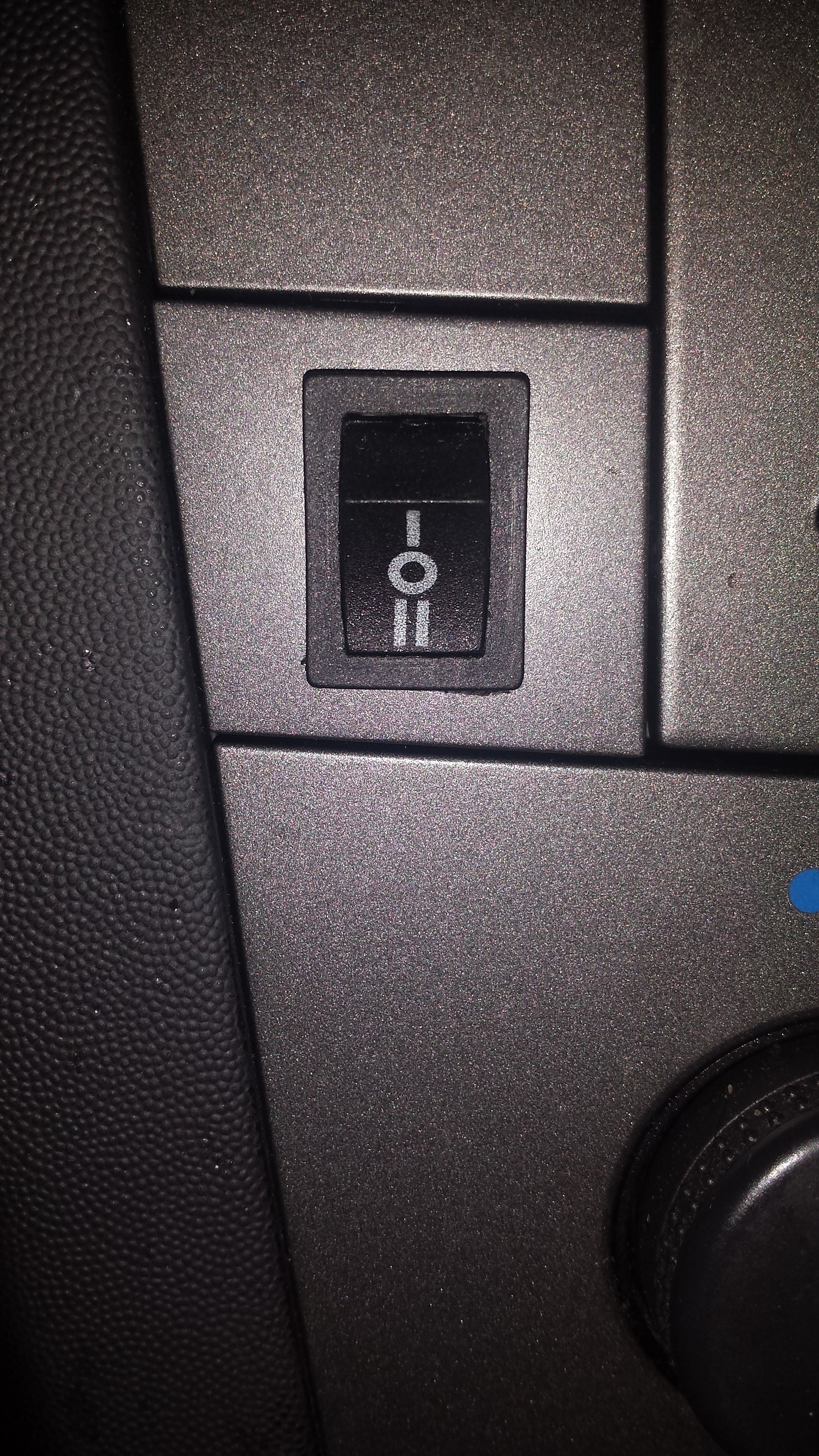

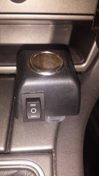

    I have a problem connecting my car camera. The voltage is constantly supplied to the car lighter. When I connect the camera, it records all the time and I would like it only to record while driving (when the ignition is on).
    I was thinking about some voltage sensor that if it exceeds 13V then it turns on the lighter. Or are there any better patents? I will add that I have a Voyager from 2001-2008. Anyone already done this?

    Hello. I propose to make a lighter + 12V power supply after the ignition switch, i.e. the voltage only after turning the ignition switch in the ignition position.

    The easiest way is to find the power supplied when the ignition is turned on in the radio power cube.
    It can be done - maybe for example on TL431, PNP transistor (probably medium power) and several resistors. What are the camera's power requirements (voltage, current)?
    The advantage of using a cigarette lighter socket is that you can assemble the system in the plug (if there are no problems with cooling), without interfering with the installation of the car.

    All in all a very good idea. I have a non-factory radio and I have very easy access. It is very possible that I will make an additional socket behind the radio inside the building in this way, in this way I will gain a lot on the aesthetics and save the socket for charging the phone while driving. I will fight on the weekend.

    I changed the car. In the new current in the socket is after turning the key. best regards
