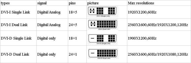

    [Quote = "E8600"]
    I have one more question if the cable (adapter) must have 24 + 1 plugs or 18 + 1 suffices? The monitor has 24 + 1.
    And what satellite jack should I buy from the antenna? I mean, is there a difference of 6.8mm and 7mm (will it fit the decoder) because I have an antenna but it lacks a plug.
  • #14 16736501
    E8600
    Posts: 8989
    Help: 529
    Rate: 2521
    Theoretically, the 18 + 1 link should be enough, but maybe it is worth choosing the 24 + 1 to be up to future solutions with higher resolution. In such cables, the fact that it has a dual link plug 24 + 1 does not mean that these additional pins are connected to HDMI because it is Chinese and it all depends on luck they do it as they want.
