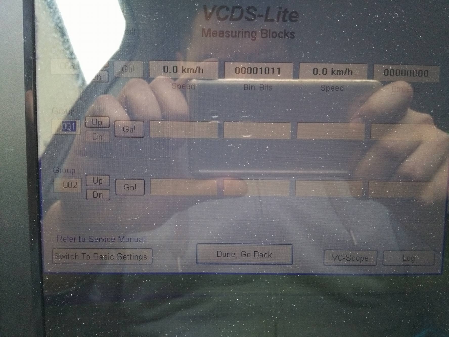

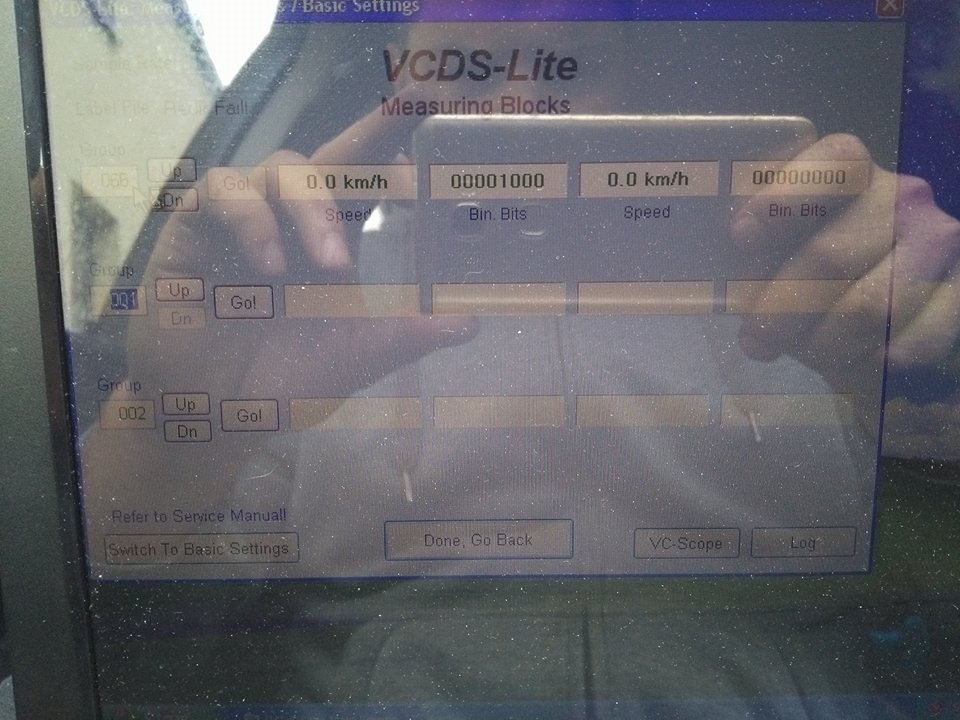

    and I have a problem it doesn't work; (
    in my car after entering this code 11463 in login
    I enter these blocks, there is no cruise control at 6 um, I have just read at 66
    and such a situation ;) I have connected the last pin to a black-blue cable because it is supposed to be in the bus
    Orange cube pin 5
    1000
    1100
    1011
    when applying the brake and clutching such reactions
    We add AUDI A6C5 cruise control - I want to add cruise control to audi a6c5 1.8T We add AUDI A6C5 cruise control - I want to add cruise control to audi a6c5 1.8T We add AUDI A6C5 cruise control - I want to add cruise control to audi a6c5 1.8T
    any advice anyone can help ?? I do not know what to do ;) pins seem to me well cut ;)
