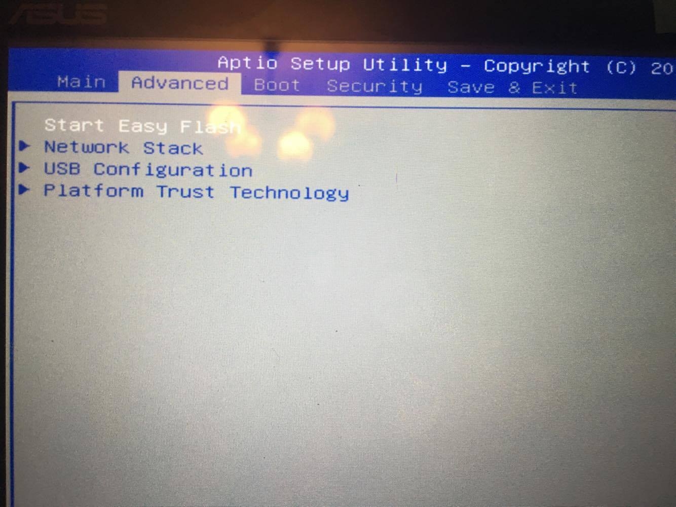

    Hello. I bought a tablet but somebody uploaded an android on it. I want to go back to windows, but I think the recovery partition is deleted. I booted win7 on a pendrive. In Bios I set up botting and changed to disable the option from the picture because of an error. Unfortunately, the pendrive does not boot.

    I just wrote in the first post that I turned it off and nothing. More than once I've uploaded windows to laptops or desktop. There is a problem here I don't know why. Maybe something else in the bios needs to be changed?

    Show the Advanced tab.
    I had a T100TA once and there were 2 boot options as I remember.
    What is the screen when booting without SecureBoot?
    Pendrive certainly well prepared?
    Only 32bit editions can be installed, 64bit will not boot ...
    The Recovery partition cannot be easily deleted. It is in a separate flash layout on the disc (8GB). So maybe try with her ...

    Without SecureBoot this is what I put in. Two start options for android
    Pendrive rather well prepared because it boots on a desktop.
    Burnt rufus. The system downloaded from dreamspark: Windows 10 Multiple Editions 32/64-bit (Polish)
    Advanced.

    GRUB / Android / Linux on the W10 installation stick ?! You have some left installation.
    It is to be created from the original .ISO version of x86 (32bit).
    This ASUS has a "defective" BIOS in this respect.
    Boot only UEFIcompatible systems, and only 32bit!

    Regarding GRUB / Android / Linux. this is not on a USB stick only on the disk and from this moment the tablet is currently booting.
    I'm now trying to create a flash drive from win 8.1 using the official windows wizard. We'll see ...
    Added after 1 [hours] 33 [minutes]:
    Ok gentlemen. Managed to :) There must have been a problem with that version of windows. Maybe because it was 32/64. The system has been installed. Now I'm downloading updates and I'll see if all the drivers are there. I wonder if I would try to install win 10 this way.
