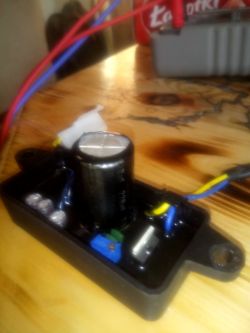

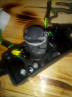

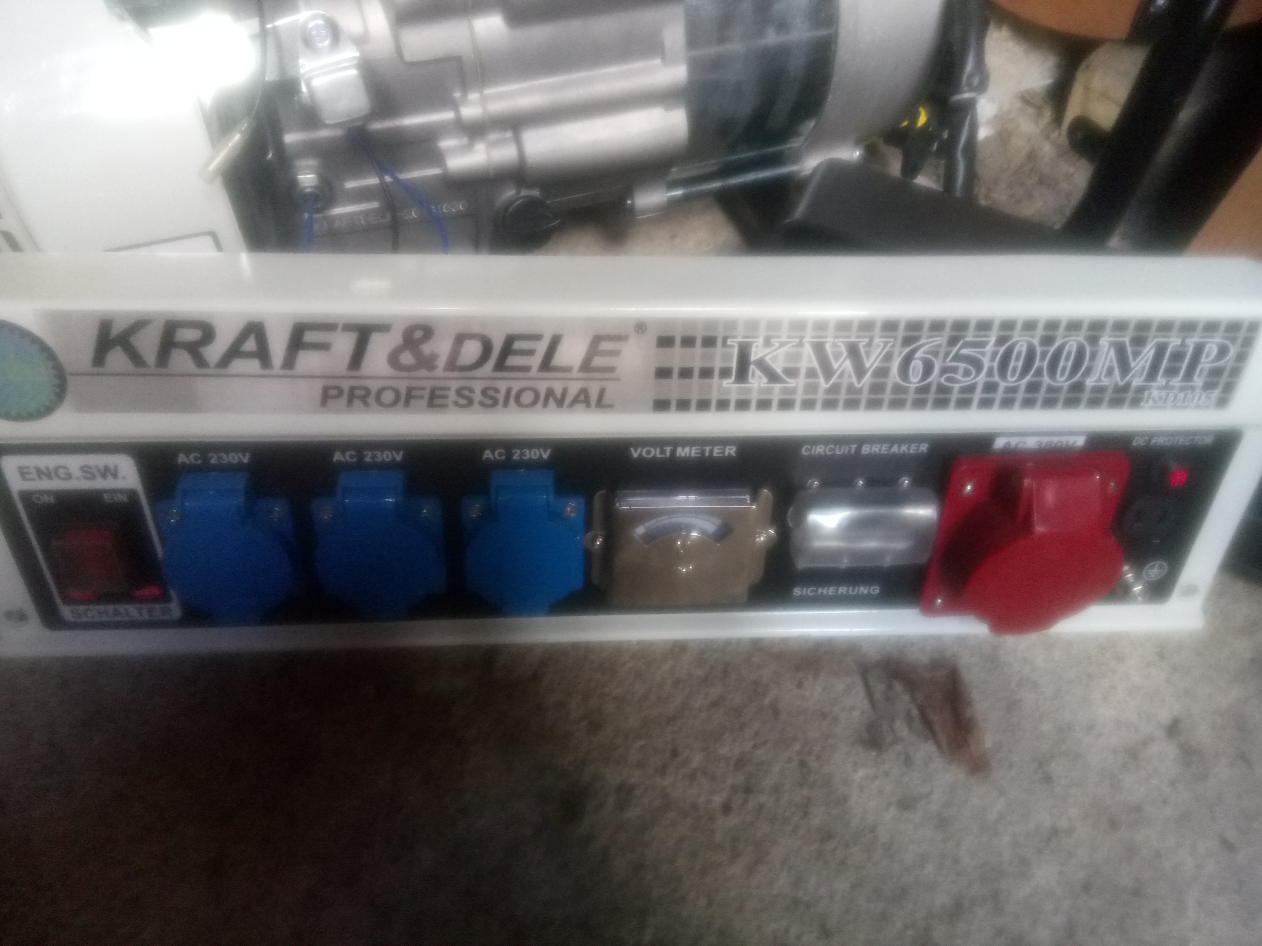

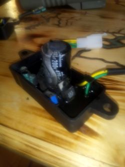

    Hello to all forum members.
    I have a 3-phase Kraft & Dele KW 6500 generator, Chinese for 700 PLN, of course, since it was new it was neither overloaded nor badly stored (in the rain, etc.), after some time it simply stopped working, I took it apart, actually the generators themselves, it turned out the AVR module is damaged, because when I connect the regulated power supply to the rotor (AVR completely disassembled), at approx. 21 V excitation voltage on all 3 sockets, it gives 230 and 400 for 3-phase nicely. I bought a new module on alledrogo, identical in appearance, only instead of blue wires it had green and the capacitor instead of 220 uF had 470, immediately after connecting and starting the aggregate it literally burned after 15-20 seconds, I complained about it, replaced it with a new one, , but only the ankle, the pins from the excitation hung loose because I wanted to check the polarity and voltage that the AVR gives, I connected the power supply for excitation, and again the same, the AVR is burnt. I picked out the resins from both, both burned plates in the same place, does anyone have any idea why this is happening? I will add that on the ankle, after starting the generator with a power supply, the voltages are 16 V on one pair of pins and 105 V on the other, i.e. 16 is probably. module and 105 is the reference voltage, right? I am adding photos, and can anyone tell which bridge on the avr board should nap. while. and for which nap. comparative? because when I called the Kraft Dele service, some technician from them said that it can be different in Chinese, they could even change the order of the wires in the cube, and the cubes cannot be inserted the other way around. I am asking for help, thank you in advance, best regards. Kraft & Dele KW 6500 Generator: AVR Regulator Damages, 3-Phase Issues, Replacement Options Kraft & Dele KW 6500 Generator: AVR Regulator Damages, 3-Phase Issues, Replacement Options Kraft & Dele KW 6500 Generator: AVR Regulator Damages, 3-Phase Issues, Replacement Options Kraft & Dele KW 6500 Generator: AVR Regulator Damages, 3-Phase Issues, Replacement Options Kraft & Dele KW 6500 Generator: AVR Regulator Damages, 3-Phase Issues, Replacement Options Kraft & Dele KW 6500 Generator: AVR Regulator Damages, 3-Phase Issues, Replacement Options Kraft & Dele KW 6500 Generator: AVR Regulator Damages, 3-Phase Issues, Replacement Options Kraft & Dele KW 6500 Generator: AVR Regulator Damages, 3-Phase Issues, Replacement Options Kraft & Dele KW 6500 Generator: AVR Regulator Damages, 3-Phase Issues, Replacement Options Kraft & Dele KW 6500 Generator: AVR Regulator Damages, 3-Phase Issues, Replacement Options Kraft & Dele KW 6500 Generator: AVR Regulator Damages, 3-Phase Issues, Replacement Options Kraft & Dele KW 6500 Generator: AVR Regulator Damages, 3-Phase Issues, Replacement Options Kraft & Dele KW 6500 Generator: AVR Regulator Damages, 3-Phase Issues, Replacement Options Kraft & Dele KW 6500 Generator: AVR Regulator Damages, 3-Phase Issues, Replacement Options
    I will add that in both modules the yellow wires go to the bridge from the S2M diodes (1000V / 3A) and the green (blue) to the M7 diodes (1000V / 1A), the question which should be 105V and 16V, is the module on because of the voltage are replaced or for another reason, but when the generator was new it worked, and now it works without avr only on the power supply ...

    I have exactly the same symptoms - after buying a new AVR, this new one lit like a candle. I will fight the topic. Have you measured the rotor and stator resistance?

    Added after 9 [minutes]:
    Ps. As for the module, I noticed that from different production they have different polarity at the output, some PLUS is blue (or green) and others are yellow (or brown),
    As I exchanged with a friend in the aggregate, the original one had a plus on the blue, so I connected the new one in the same way, fired and nothing .... it was enough to change the blue with yellow places and it started to kick ... But the reverse polarity connection to the brush holder was not is the reason the module is burning, so the topic is still a mystery ...

    What is the resistance of the ends of the excitation winding to ground?
    What three-phase system does the generator work in? Triangle, star with / without center point derived?
    Could you please draw the regulator power diagram?
    What voltage is it supplied with, because the capacitor in the photo is only at 200VDC!

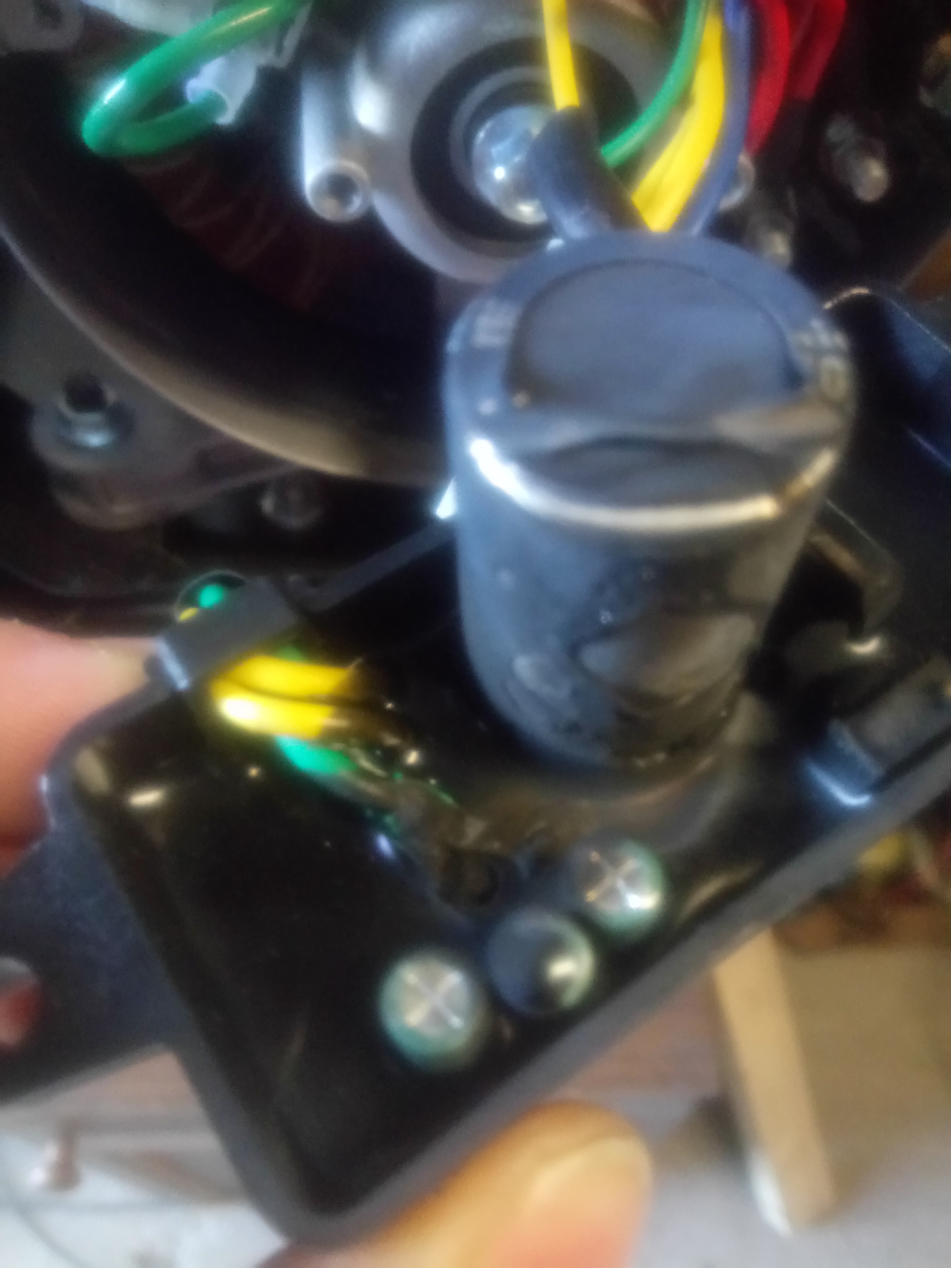

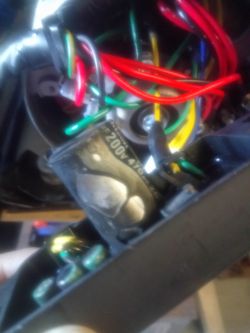

    It's quite an old topic, but I'm having similar problems and I've figured out something.
    The stator on Chinese models is made of aluminum. The entire stator vibrates in line with the motor. A short circuit between the windings occurs in time with the vibrations.
    When the AVR sees 230 (or similar) instead of 17V, it drastically lowers the excitation. In my case at 3.85 V.
    So at the output I get about 30 V instead of 230. Unfortunately I have to replace the stator and AVR, which I burned while trying to excite external. It is good to buy a stator wound with copper rather than aluminum. Withstands higher currents and is more resistant to vibrations.
    The 6 V battery raised the voltage nicely to 90 V. I thought a step ahead and connected the 12 V 3A power supply. The voltage jumped to 170 V, but not for long. After several seconds, the AVR and the power supply fell.
