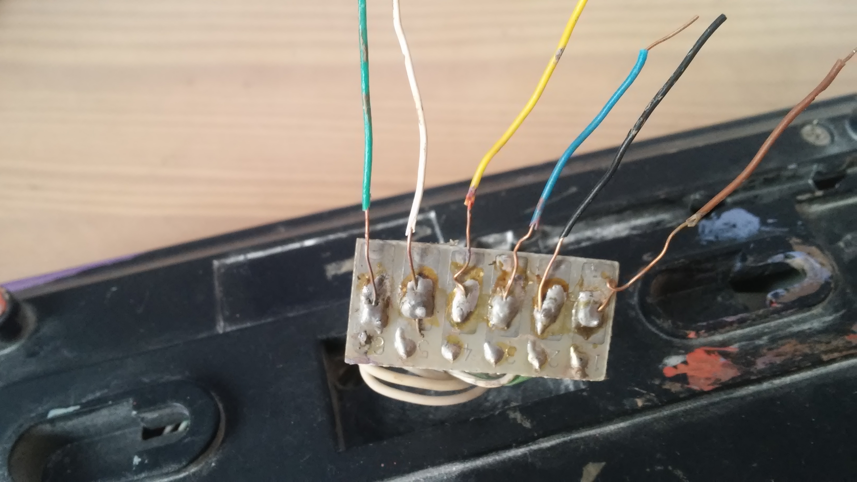

    I am asking for help in connecting a new CYFRAL SMART 5P handset in place of the old one (photo attached), also the old Cyfral handset (older model) - there is no marking. .
    A total of 8 wires come out of the wall, and additional red and purple wires are connected to the camera (6 were soldered).
    • Connecting CYFRAL SMART 5P Handset: Replacing Old Unmarked Model, 8 Wires & Camera Setup 20171007_124611.jpg (1.11 MB) You must be logged in to download this attachment.

    jacmroz48 wrote:
    old earphone also Cyfral (older model) - no marking.
    Show pictures of the entire handset inside.

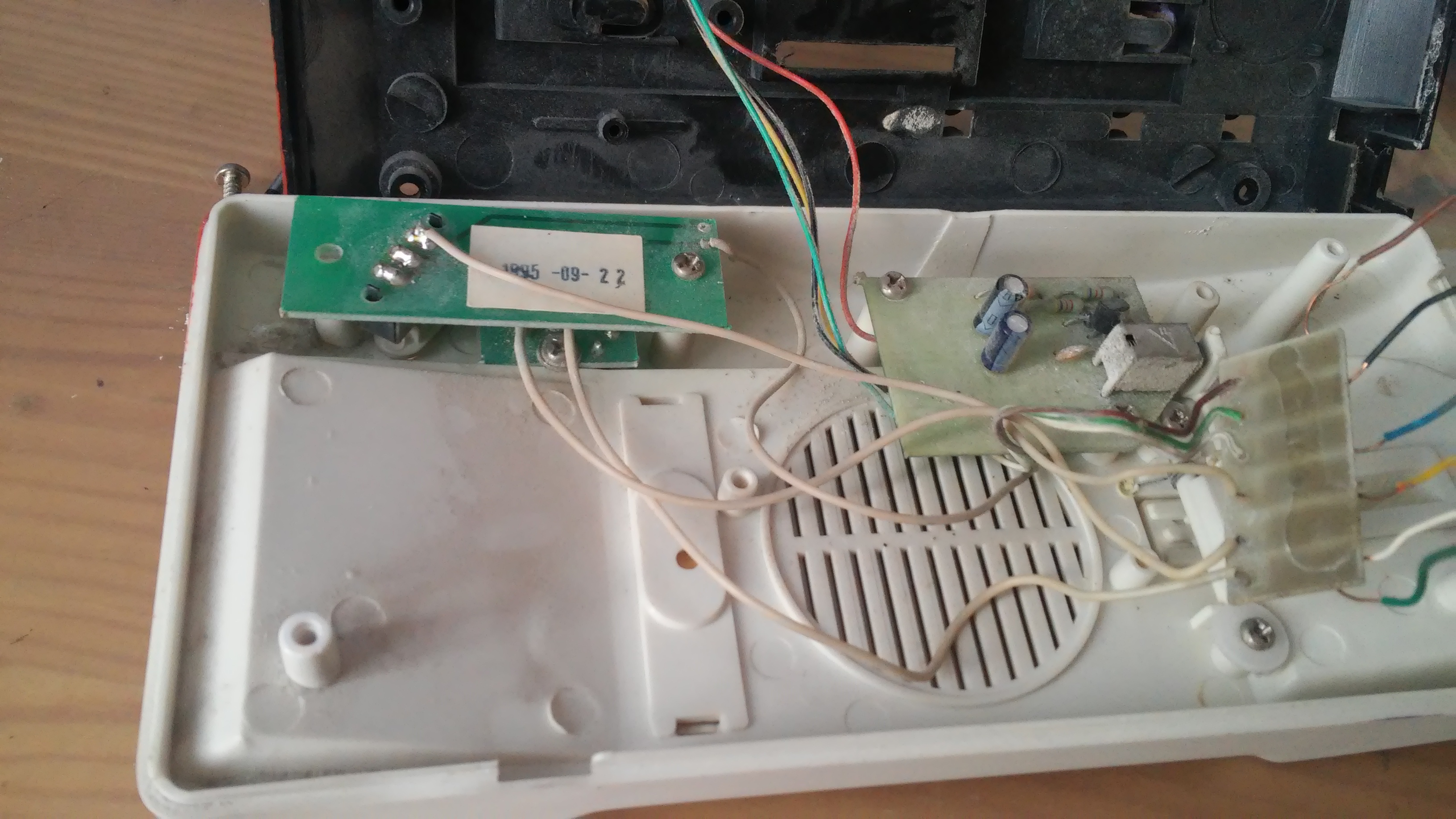

    DriverMSG wrote:
    Photo of a new handset or an old one ??
  • #4 16742864
    DriverMSG
    Posts: 44094
    Help: 3984
    Rate: 4880
    An old one, whose model you don't know.
  • #5 16743008
    jacmroz48
    • Connecting CYFRAL SMART 5P Handset: Replacing Old Unmarked Model, 8 Wires & Camera Setup 20171007_150443.jpg (1.44 MB) You must be logged in to download this attachment.

    DriverMSG
    Posts: 44094
    Help: 3984
    Rate: 4880
    Born in 1995 - I don't know if there were any instructions in digital format.
    It remains to carefully check the other end of the wires, i.e. the intercom central unit, and make a connection diagram based on it.
    Alternatively, if you have the skills, draw a diagram of this old handset.

    jacmroz48
    Hello!! ZYBEX was helpful
    "5-wire version.
    There were in turn:
    1 - handset (speaker)
    2 - microphone
    3 - mass
    4 - call
    5 - lock
    Perhaps this terminal 6 is the second button terminal (lock).
    I propose to connect this way.
    1 - SPK
    2 - MIC
    3 - WEIGHT
    4 - RING
    5 - SW1
    6 - SW2
    Jumpers set as for 6-wire installation.
    However, it will be best to connect a new uniphone in stages. First connect the ground cable to GROUND. Then connect the handset cable to the SPK.
    At this point, you must hear a noise outside the front door. "
    Thanks again to ZYBEX
