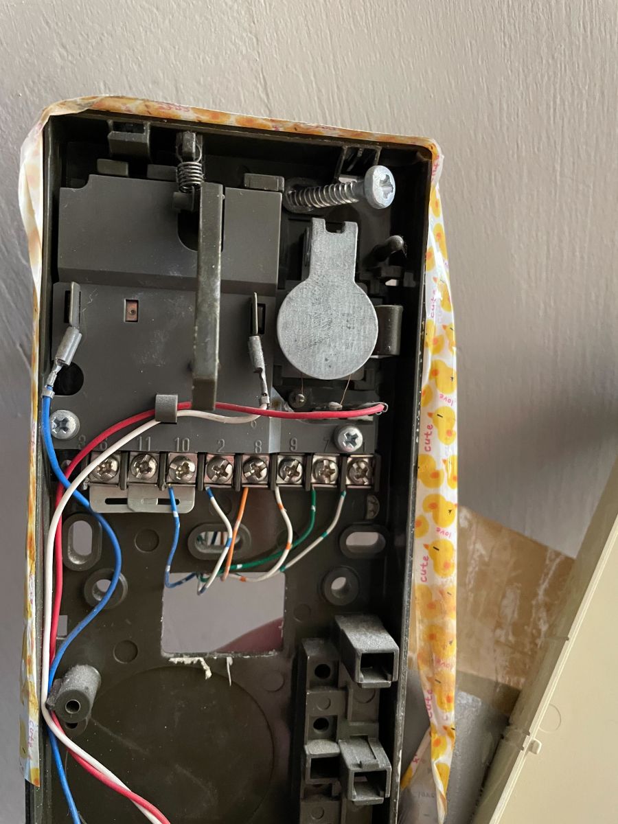

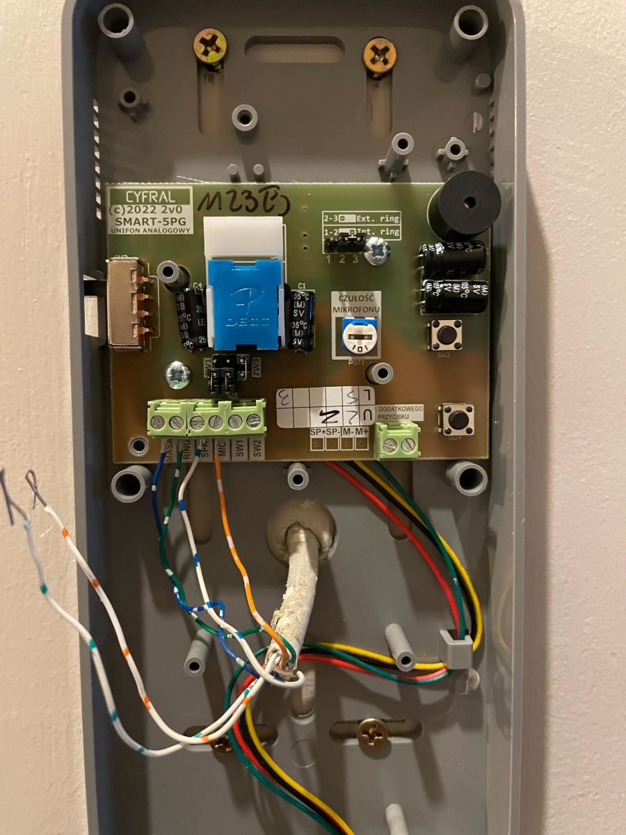

    I'm struggling to install the "Cyfral Household Intercom Smart-5PG" with 6 wire cable.
    1st image with words is the new one that I failed to install
    Cyfral Smart-5PG circuit board with connected wires.
    2nd image with Numbers is my old one
    View of the intercom interior with connected wires.
    Could anyone please advise the correct placement of the wires on the new phone?
    Thanks
    Jamie

    Connect like this:
    GROUND - blue
    RING - green
    SPK - white from green
    MIC- white from blue
    SW1 - white from orange
    Jumpers:
    ZW1 and ZW2 - removed
    ZW3 - established
    RING 1-2 jumper (Internal call generator)
  • #3 21046041
    JamieDuck
    Thank you so much for the quick response. It worked.
    It was external rather than internal for me. But I wouldn't have been able to figure that out without your help.
    Jumpers:
    RING 1-2 jumper (External call generator)
  • #4 21046044
    JamieDuck
    The comment helped me plug everything in correctly. I figured out it was external rather than internal but there was no way for the commenter to know that.
    Thanks for the commenter and this forum.
