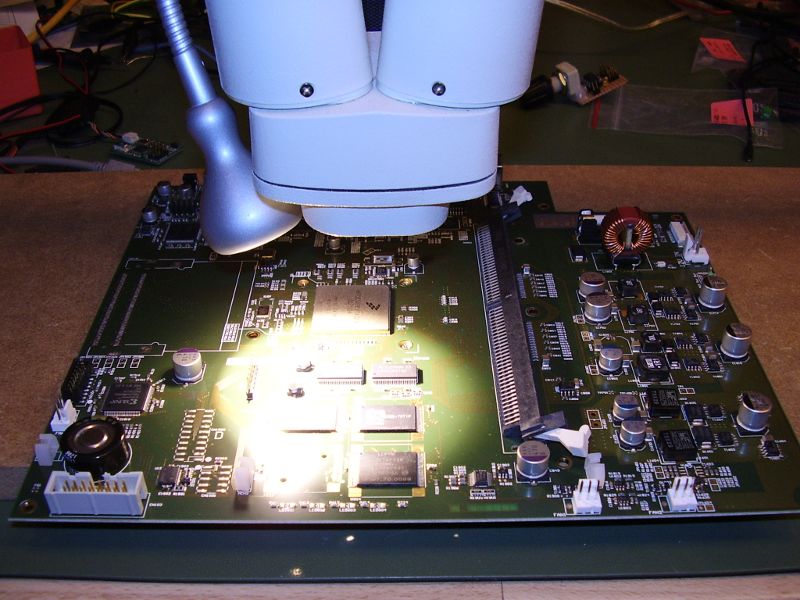

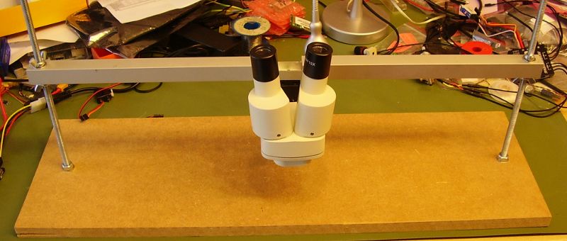

    On the German website I found a modification of this cheapest microscope. Here is one of the photos:

    It seems to me that the contractor for this project left the original lifting system here. Interesting thing, especially for the price.

    It is the working area in it that is the biggest problem, unfortunately you have to combine with the processing - unless the tiny plates themselves are soldered. As for the freedom of work of the soldering iron, what is the real distance between the lens and the PCB? and as with color optics distortions, etc.
    BTW. 0.5 raster, I solder a cheap magnifier without any problems ... and how does the work with, say, SMD 402 elements look under this microscope?
    On the other hand, for the price of PLN 160 and such a modification would pay off. I am only worried about this small distance and the lack of inclination of the head (rather not comfortable for work).

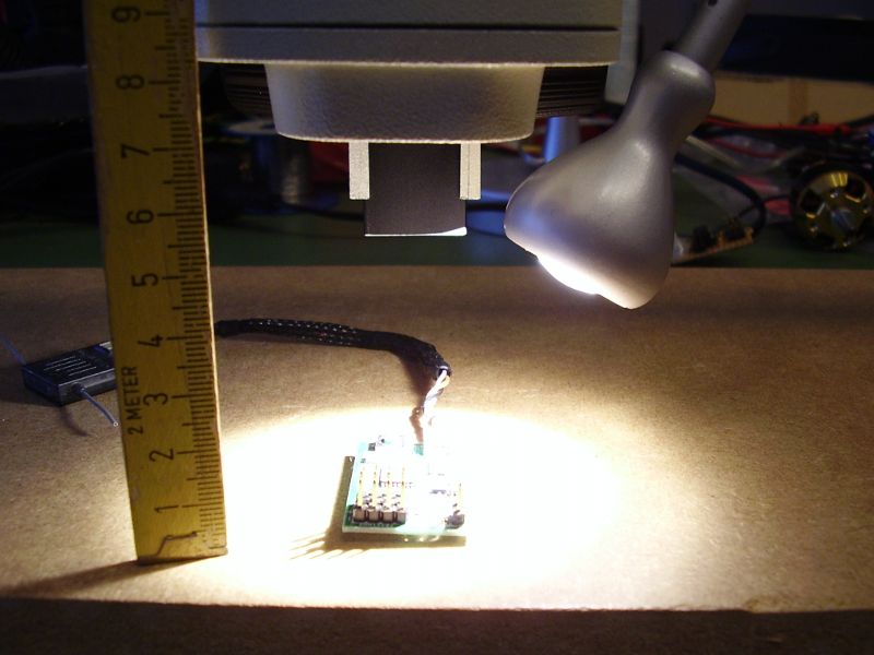

  • Microscope offers 6.5–7 cm working distance for most soldering

    @tplewa I do not have a method of measuring the focal length now, because I recently took it apart to add such a bar (modification for larger tiles).
    But from what I remember, it will be about 6.5 - 7 cm, someone up there wrote that it is not much - but I do not know, it is enough for me. The smallest resistors I soldered 0805, it can be soldered without any magnifiers. I'm just starting out in SMD, so that's why I don't have experience with smaller ones.
    I think 0603 would not be such a problem. Unfortunately, I have not seen these 402 live, but in my opinion such a microscope is enough to solder the vast majority of things (I would say everything, but I have not seen everything yet ;) ).

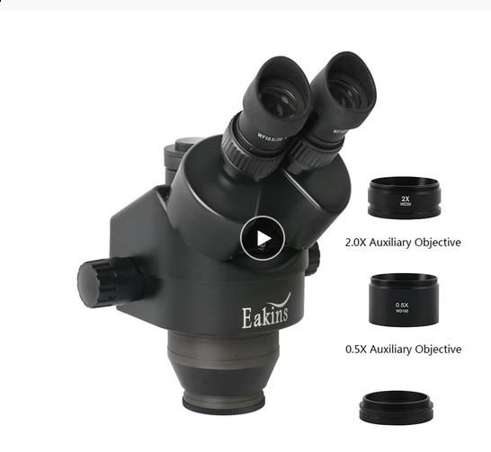

  • AmScope kits lack 0.5x Barlow and camera port
    #17 20384447
    tplewa
    Posts: 6741
    Help: 222
    Rate: 1009
    jugo963 wrote:
    These trainings always give a certificate, etc., which is always a shim when applying for a job in the service or not necessarily
    IMHO these certificates are worth as much as the certificate I can issue you here adding a potato seal to it :cunning:
    In most cases, for a person who employs someone, what matters is who can do what, or a clue may be a work certificate from some other company dealing with the service (i.e. that you worked for X years in some service).
    Let's put it this way, the work of a service technician requires some manual skills (soldering, etc.), analytical thinking and some knowledge of electronics. This cannot be achieved in a dozen or so hours of training.
    Such trainings may make sense in sharing specific knowledge about specific "tricks" in specific devices - but in principle I do not know whether they are created and whether websites share such raisins with other websites (such knowledge is an advantage on which you can earn more).
    btw, I've seen links about microscopes (I think AmScope) before...
    They are such better Chinese ones - when it comes to one, note that the set does not include the mentioned 0.5X Barlow lens (only 2X which is not very useful in the service). Also one model does not have a third channel for the camera. While the cameras added by the Chinese, as I mentioned, are poor and a waste of money, the third channel in the future may be useful to connect a better camera, camera, etc..
    If the price in pounds suits you, they can be. As I mentioned there are many of these kits and it's more about looking for something that will fit in your budget.
    Regarding these cameras, this is of course my opinion, I messed around with them a bit, including connecting them to the microscope, I bought, among others, 0.5X and 0.35X mounts (I mentioned 0.5 here https://www.elektroda.pl/rtvforum/topic.html p=19300569#19300569). Unfortunately, the effects are so-so and unfortunately the camera I have won't help much, and a good camera is basically the price of another microscope (for 4K it's around 2,000).

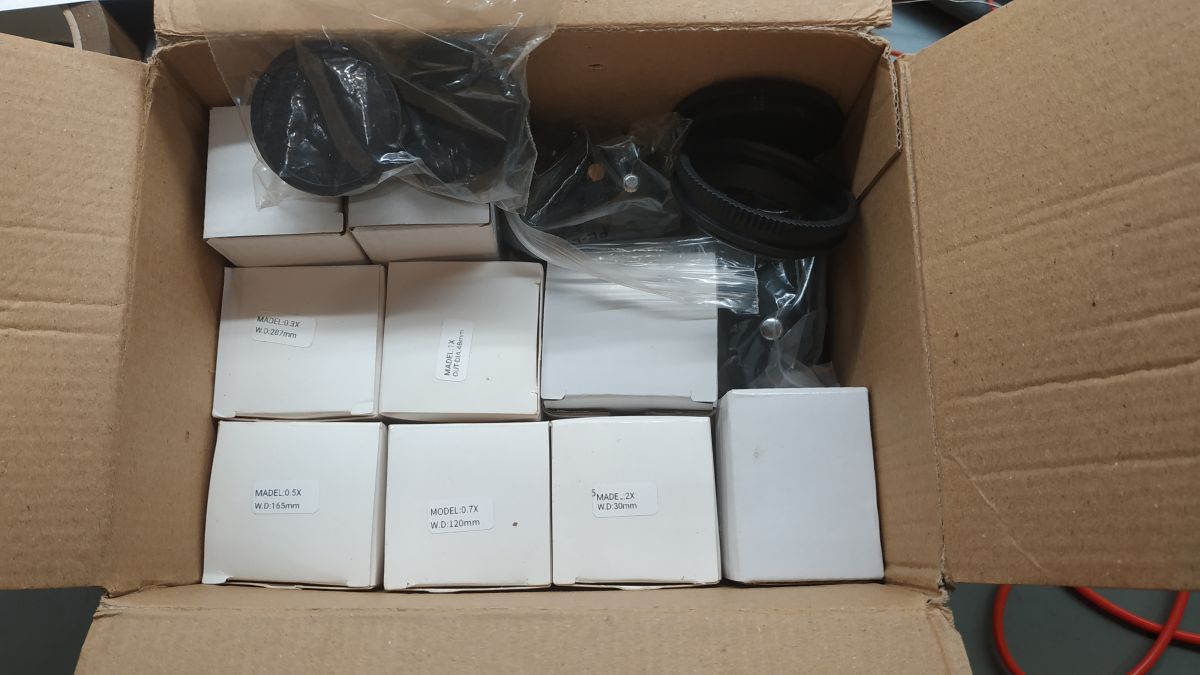

    Summing up the additional glasses and camera mounts, I collected a small cardboard box ...
    Choosing Affordable SMD Soldering Microscope: Height, Optics & DIY Tripod Modifications
    Finally, I use the mentioned Barlow 0.5X + glass of the WF10X / 20 glasses and the aforementioned 0.5X camera mounting thread. The 0.35X mount gives a larger area on the camera, but unfortunately with a very large vignetting - another thing, this area is much smaller than what we see in the microscope eyepieces...
