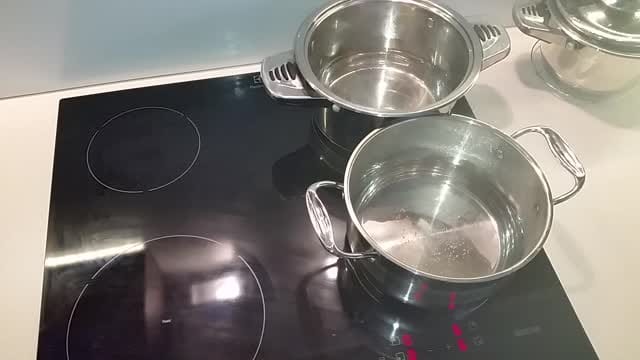

    Hello, the board is connected by an electrician correctly 400V on 2 phases according to the plate with the instructions.
    When placing the pots on the 2 front boxes, everything is ok, after adding the next it starts to heat with breaks, i.e. you hear the sound of switching on for 2s and then stops for 2s and so on. It doesn't matter at what power the front boxes are set, even after setting 2 pots on only one side (front and back) the same happens. I understand that the hob has limited power (6.6kW), but it should probably reduce its level automatically instead of heating by impulse.
    After reporting to the service, they replaced the control module, but it is still the same, I contacted the Elektrolux service and wrote back to me that this is normal operation and they all work. I put an illustrative video, please set it loud. This is my first induction and it seems strange to me. I am asking for help in the subject, best regards
    [Film: 4b0246ed9c] https://filmy.elektroda.pl/64_1507735276.mp4 [/ film: 4b0246ed9c]

    The CD is under warranty, but the Elektrolux service claims that this is normal operation, I don't know, I wrote it wrong. Below, exchange of emails with them, I will add that contact by phone also gave nothing further insist on their ...
    "Our specialist consulted what you described is correct operation, regardless of whether you enable one, two or three fields. The board works impulsively.

    you have to understand how the power management in the board works.
    The EHH6240ISK board model has 6600W of power, which is divided into two phases, and each phase supports two fields.
    The fields have their maximum power, i.e. on setting 9 and in the EHH6240ISK model two fields have the ability to set the Power function.
    Field power
    right front 1200 W, power 1800 W
    right rear 1800 W
    left front 2300 W, power 2800 W
    rear left 1200 W
    It looks like this: we divide the power of the device 6600 W into two phases - we have 3300 W on each phase, so if I turn on the power on the right side, i.e. I draw 1800 W, then when I want to run the second field on the right, I have a maximum of 1500 W, so I can't use the maximum setting and the numbers on the control panel are flashing. This power management protects the disc from overheating.
    General information on energy management is also included in the operating instructions in section 4.8.
    The cooking zones are grouped
    according to location and number
    phases connected to the hob.
    o Maximum load per phase
    is 3700 W.
    o The function distributes power between fields
    heating connected to the same phase.
    o The function activates when the total power
    cooking zones connected to one
    phase exceeds 3700 W.
    o The function reduces the power of others
    cooking zones connected to this
    same phase.
    o Display for reduced fields
    heating power varies in range
    two levels
    The sound of shooting is also a normal phenomenon at high power settings - the vessel that was used is made of various materials (made in layers), also such a sound appears when we put a cold vessel.

    Servicing toto since it appeared on the market, I confirm to the letter:

    The plates are most efficient, they have two generators, one on each side, right left, i.e. if we put the pot on the right field and on the left, there is no break because the plate works at full power.
    But if we put the dishes on one side of the right or left, then you will hear the work of the relay, which switches one field once a second and that's how all the plates work, regardless of the manufacturer.
    PS.
    The boards are not connected to 400V, so the electricians tell some nonsense, the board is powered by 2x 230V.
