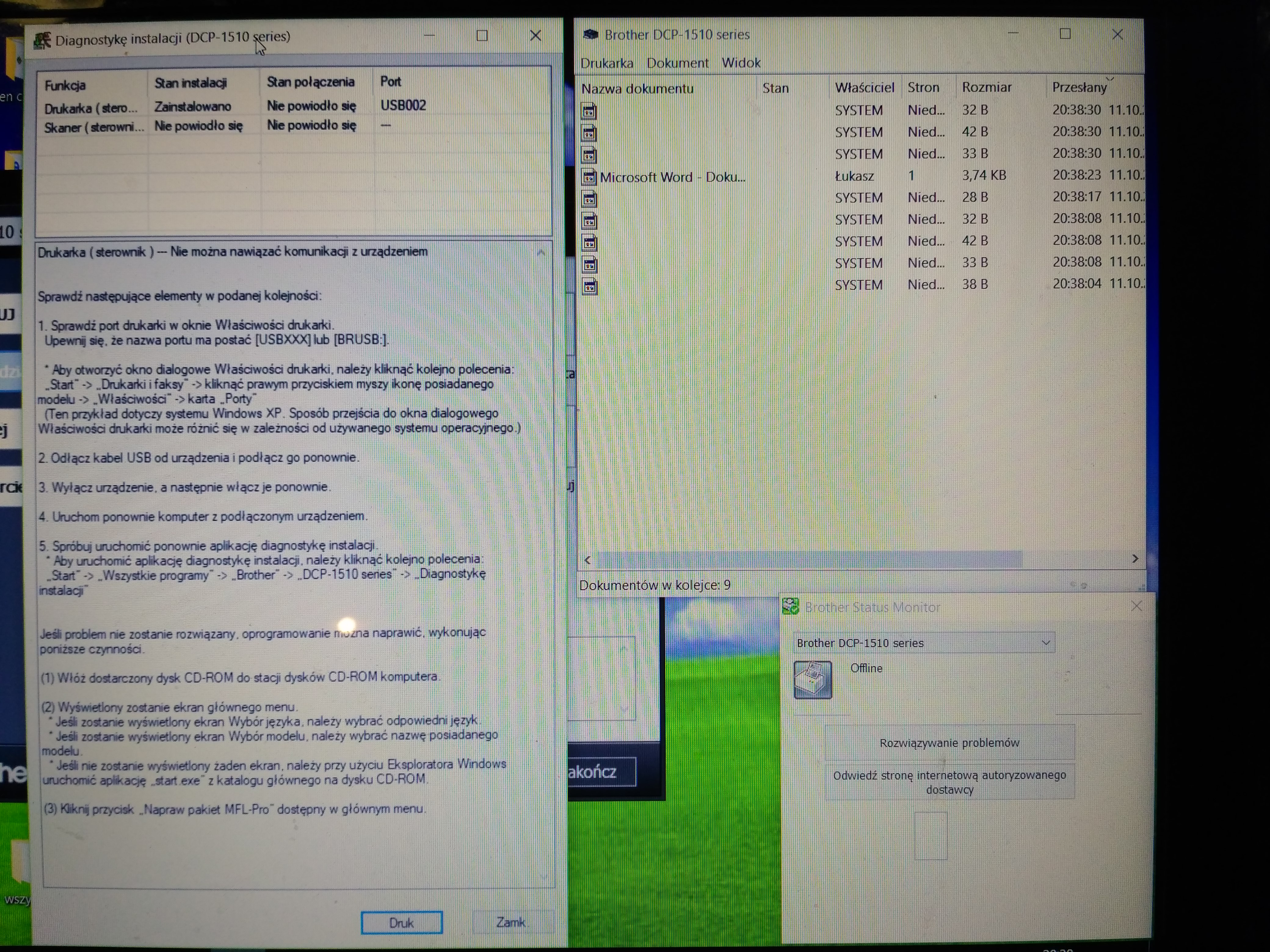

    Hello, I have a problem with the Brother dcp 1512E printer. The printer from the computer seen offline, cannot be printed. I managed to scan and recreated the scan on my computer, so the USB connection is working, you can also photocopy. What steps do I need to take, what should I check? I attach a picture of the messages in the attachment. Thanks in advance for any help.

    I suggest removing the printer in the control panel.
    Control panel -> devices and printers -> PPM and remove device.
    Then the manufacturer's website and finding the full controller for this model and installing it.
    You may need to add the printer to the control panel again.
    Restart your computer and it should go off.

    Thank you very much, I installed the drivers and software again and everything works well. What could be the reason for the "failure"?
