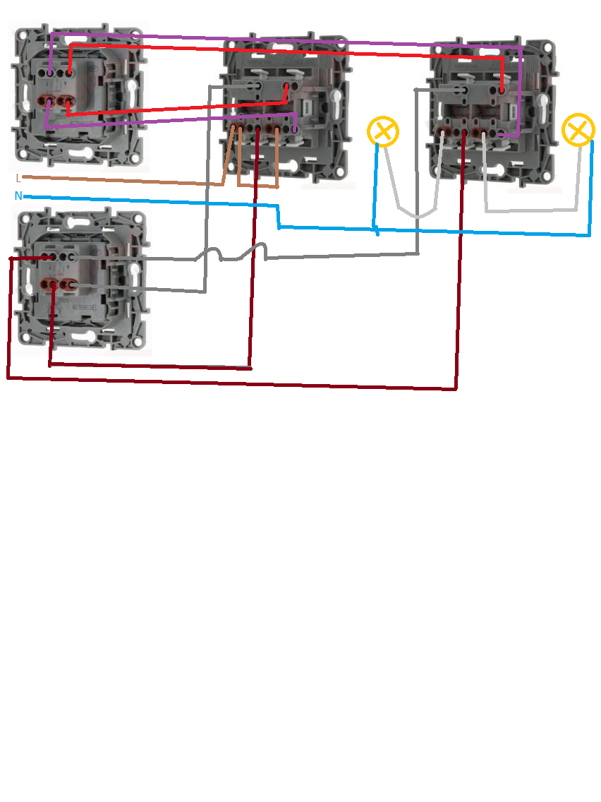

    Hello everyone. Today, I spent a few hours connecting the lighting system in the bedroom, which would allow me to control two points of light independently from 3 places. I used 2 cross connectors (at the entrance to the bedroom) and two double stair connectors (on the left and right side of the bed). The fastener brand is Legrand Niloe.
    The scheme to use looks like this:
    Controlling 2 Independent Light Points from 3 Places: Legrand Niloe Connectors, Cross & Stair
    maybe there is something wrong with this diagram, or I don't read the diagram correctly on the connectors. I am asking you for help in solving this problem.
    Below is a video that presents the effect that I want to achieve.
    best regards
    The diagram is OK except for the lack of PE wires
    let's assume that PE does not exist in this installation.
    in that case the problem lies in connecting to the connectors. Is any of you able to trace this diagram under my connectors?
    Legrand Niloe -
    Double stair: Controlling 2 Independent Light Points from 3 Places: Legrand Niloe Connectors, Cross & Stair
    Two crosses: Controlling 2 Independent Light Points from 3 Places: Legrand Niloe Connectors, Cross & Stair
    I lost a few hours and some nerves. I don't know what the problem is anymore, either the dumped eska, or both points glowed at once or none ...
    This cannot be considered because it is the most important cable.
    You combined so :?:
    Maybe you actually draw it by hand as you have the wires routed.

    ketiz wrote:
    In addition to each double stair switch, one L cable runs from a common room power supply,
    Power supply is used for one 2x cross and two lamps must be connected to 2x cross. So where are the lamp power cables :?:
    ketiz wrote:
    and along the ground wire,
    Such a cable is not present in the installation.

    "it either dumped eska, or both points glowed at once or none ..."
    ------ you must have "mixed up" connections. Accurately mark the wires, or at least the "circuits" A and B.
    This description is "illegible":
    "In addition to every ??? double staircase connector, one L conductor runs from the common room power supply, and the ground conductor, on one side for 1 light source and on the other for the other light source. "
    So on the "quickly" drawn diagram of your connectors:
    • Controlling 2 Independent Light Points from 3 Places: Legrand Niloe Connectors, Cross & Stair Bez tytułu.png (222.56 KB) You must be logged in to download this attachment.

    We don't understand each other; / I don't know much about electricity. The question is whether the diagram I presented is correct? If so, could I ask you to replace the connectors in the diagram I presented, substitute my connectors and indicate which cable to connect to which connector?
  • #16 16757774
    ajibaz
    Posts: 35
    The pattern is correct - "book".
    In post # 14 I show how to connect "Your" connectors - also theoretically, I do not know your installation - cable routes, but this does not negate the need for a proper connection as per the diagram with description below. The colors of the veins may be different in your installation, it is important to connect the appropriate "connectors".

    On the diagram you have a well-designed, the work went into the woods.
