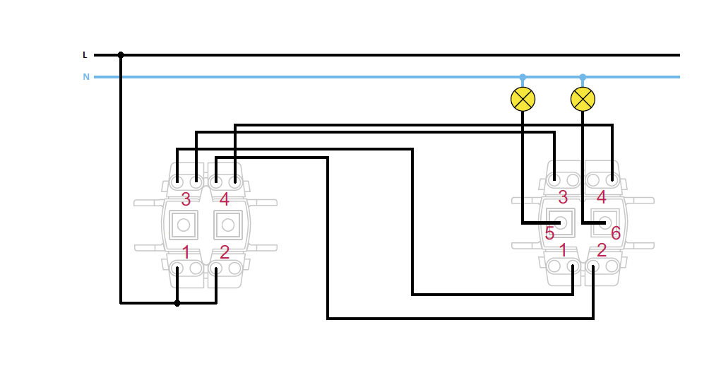

    I have a problem with connecting the system: 2 double Schneider stair switches + 2 light sources that are to be turned on and off independently from each switch.
    There was such a beautiful "diagram" in the package of the stair switch:
    How to connect 2 Schneider Sedna double staircase switches to 2 lights?
    Although I am a total layman, I have made 2 such systems in my life (with switches from another manufacturer), but here I have a problem. Unable to understand this scheme, I asked the manufacturer for help, and the following scheme was sent to me by e-mail (different from the one in the package, by the way):
    Unfortunately, neither of the two variants gives any effect. Nothing lights up, nothing works.
    By deduction, I used the most popular scheme of such an installation in google (I also used it with previously assembled systems) and adapted it to the specific arrangement of plugs in the Schneider switch. It looks like:
    We're almost successful! But not everything works properly and here I am asking for help:
    I can control the light source in one switch, turn it off, turn it on, but the second one only starts to function when the light source is on. Then with the second switch I can turn off this light source, turn it on again, but now the first switch is inactive when the bulb is turned off.
    In other words: a switch can take control of the light source from the other switch only when the light source is lit. And so it is both ways. It is not possible to turn off the light with one switch and then turn it on with the other. The second switch must "wait its chance" until the light is turned on ;)
    Please help, any hint, what am I missing here, what have I mixed up?

    The first diagram is for 3 switches, the second one is drawn wrong and the third one is messed up by a friend, it should be like this:
    1 switch, you give the phase to 5i6 and connect to the second 1-1 2-2,3-3,4-4 on the second 5 for one bulb 6 for the second bulb of the bulb to zero and that's it.

    Hi, I think it's supposed to look like this.

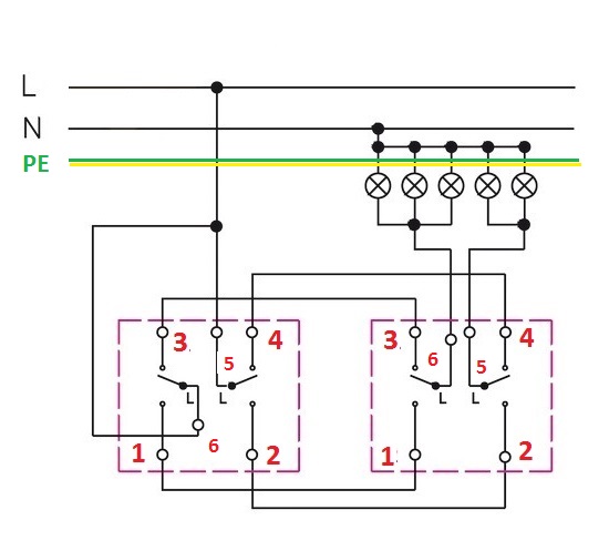

    A colleague mixed up the connections to the stair connector terminals. A colleague described it correctly goodie1 . And I'm posting a diagram found on the Internet and slightly modified for easier use.
    And do not forget about the mandatory protective conductor (PE), which even the manufacturer Schneider Electric forgot to include in its professional diagram. It is to be connected to a properly marked terminal of luminaires made in protection class I or left loose next to luminaires made in class II.
    • How to connect 2 Schneider Sedna double staircase switches to 2 lights? Podw__jny_schodowy.jpg (46.4 KB) You must be logged in to download this attachment.

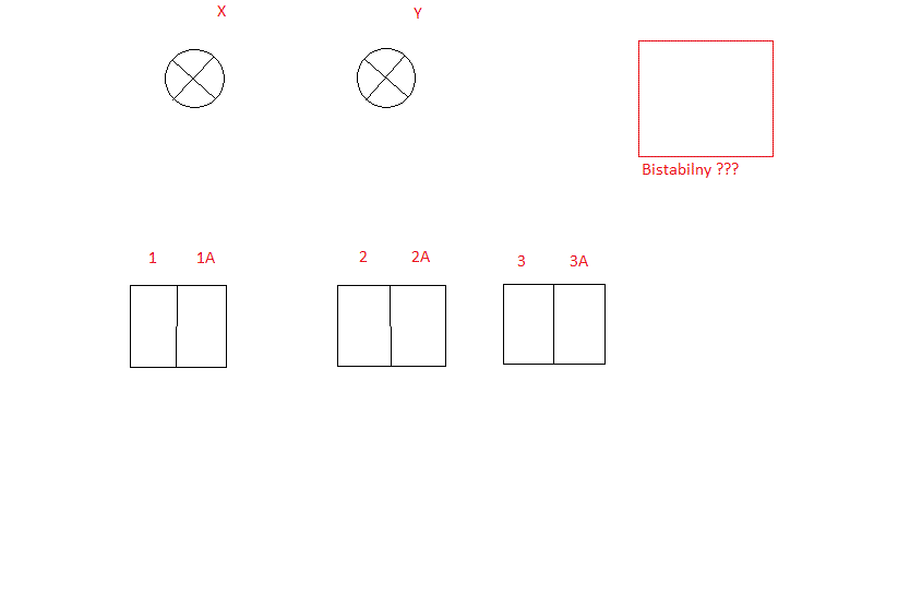

    pastakrk
    Okay, so we have two double stair switches and two light sources, each button in a given switch can control a different bulb.
    I would also like a switch to turn both bulbs on and off
    I'll try to draw a schematic when I'm at my computer

    pastakrk
    Thus,
    two independent light sources
    three double switches
    1, 2, 3 turns X on and off
    1A, 2A, 3A turns Y on and off How to connect 2 Schneider Sedna double staircase switches to 2 lights?
    how to connect?

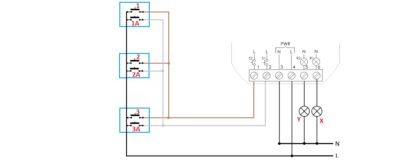

    pastakrk wrote:
    how to connect?
    You need two bistable relays and 3 double bell switches (momentary).

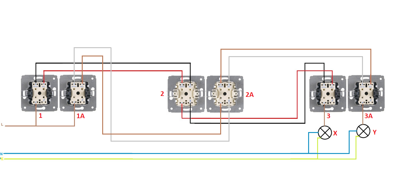

  • #17 15499263
    mawerix123
    Posts: 4150
    Help: 482
    Rate: 951
    "Lopathologically" Stair + cross
    Bistable, I used a double bistable F&F BIS-416 and three double buttons.
    Some people will probably be bothered that the diagrams are in Paint and not in the profi program, but I had no other at hand and for a layman I think it's clearer to read ;)
