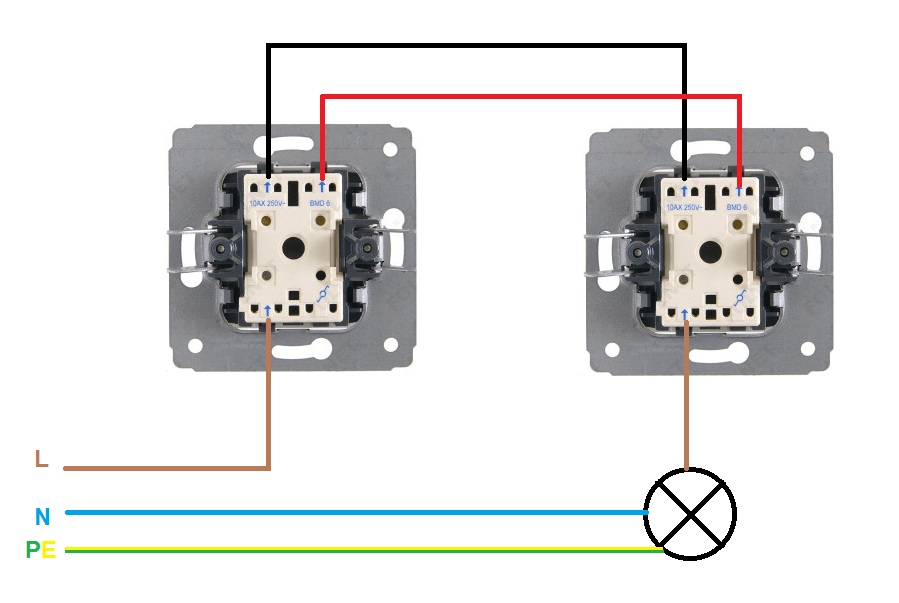

    Hello. Some time ago, the electrician made the installation, it was time for equipment, but unfortunately he went away for a few months and I do not have access to it now so I mount the sockets and I stopped on the stair connectors and it looks like this:
    There are cables in the box at the top: brown, blue, yellow-green - there is no electricity in any of them.
    In the primeval bottom: -brown (there is electricity in it, I checked with a test tube), -blue (there is electricity but the bulb in the tube shines less than always, it glows slightly), -yellow-green no electricity.
    And now the question. How to connect it to ospel as connectors? I found several schemes of this type:  Connecting Stair Connectors with Two Live Wires: Electrician Assistance for Ospel AS
    and according to them it looks like that before connecting only in one box there should be one live wire, not two. Is this done according to some other pattern?
  • #2 16576425
    WędkarzStoLica
    Posts: 1511
    Help: 146
    Rate: 300
    jac22 wrote:
    according to them, it looks like that before connecting in only one box should be one live wire, not two.
    It has to be this way, the scheme is good.

    On the blue wire (if it is the equivalent of the blue one in the figure) in the bottom box the "test tube" should not show voltage (N wire - "zero"). If it shows (but weaker), I suspect that there is a break on this wire somewhere before the bottom box, and on the section of the wire (from break to can) there is "excited" voltage from the phase wire running in parallel. Because I assume that it's about the "power" side - fuses and not the connection between the boxes for the switches.
    Check in the cans that you have twisted wires properly. Have you drilled around the cables because maybe the cable under the plaster was damaged?
    The test tube can show voltage on unconnected wires ("hanging in the air") if they run on wires with a "phase" - that's the charm of this tool.
    But if, as you wrote, you have three wires in the boxes, most likely they are wires running between the switches.
    My friend jac22 you have attached a drawing / diagram with a question about its correctness: the drawing is correct. But on the diagram you have four colors (five wires)!
    If you have three wires in the boxes under the switches (you wrote about three), all you have to do is assign the appropriate wires from the boxes to the colors of the wires in the diagram. The blue wire from the diagram was most likely located outside of the boxes.
    I would bet: the brown wire is black in the drawing, the blue and yellow-green wires are green and red in the drawing.
    But these are only my guesses!
    No joke with the flow. If you are unsure, refrain from connecting to the electrician's return.

  • #10 16579104
    jac22
    Posts: 9
    Thanks. In fact, the second wire showed the voltage in the test tube because it induced it from the plus next to it. I checked it to be sure by connecting a standard light bulb (minus from the socket, plus I checked on individual wires in turn, of course, if someone read it in the future, you need to know what to do and if you don't know what's going on, it's better not to check it! because with the tide, as one of my colleagues wrote, no jokes). The voltage was only in one can and on one brown wire, which is how it should be. After connecting the connectors, approx.
