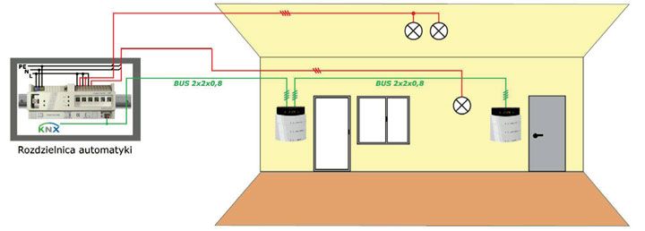

    adwlodar wrote:
    Okay, I understood that it was about building automation.
    Read: https://www.fachowyelektryk.pl/technologie/in...-hybrydowe-inteligentnego-domu-ohid-czesc-i-w Polsce.html
    A bit like that, but for now I want to make it work without any automation and in the future so that we can control all of them separately.
    In this article, they described it nicely - but there are KNX assumptions that I will definitely not have.
    Does anyone have any simple drawing of a star system? and how is it different from the aforementioned CPR?
    Put any other system in this place - it doesn't matter - I just gave you this to understand an idea.
    Anyway ... entering into google the password: "star electrical system" gives about 800 thousand results ... Let only 100 be adequate for you, then you have at least one week of acquiring knowledge. Ask for a detail later, because so far you are confusing a lot of things, I have an impression.
    PS YouTube doesn't bite either ...

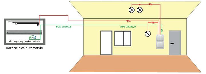

    #9 19078147
    stirith
    Posts: 6
    For me, this is a star below, but I'm probably wrong. I am asking for help, which is wrong. Because here the points of light go to the switching station - each separately. It is also shown here that the control of these light points is handled by automatics and a switch from automatics - I would like to replace it with ordinary switches for 230v.
    Understanding Star Wiring Diagram: Focal Point, Light Points, and Cable Connections
    Here it is like the article says "hybrid" but as I understand it is definitely not a star because the power supply goes from the light point to the switch, yes?
  • Questioning the purpose of running all cables to the board

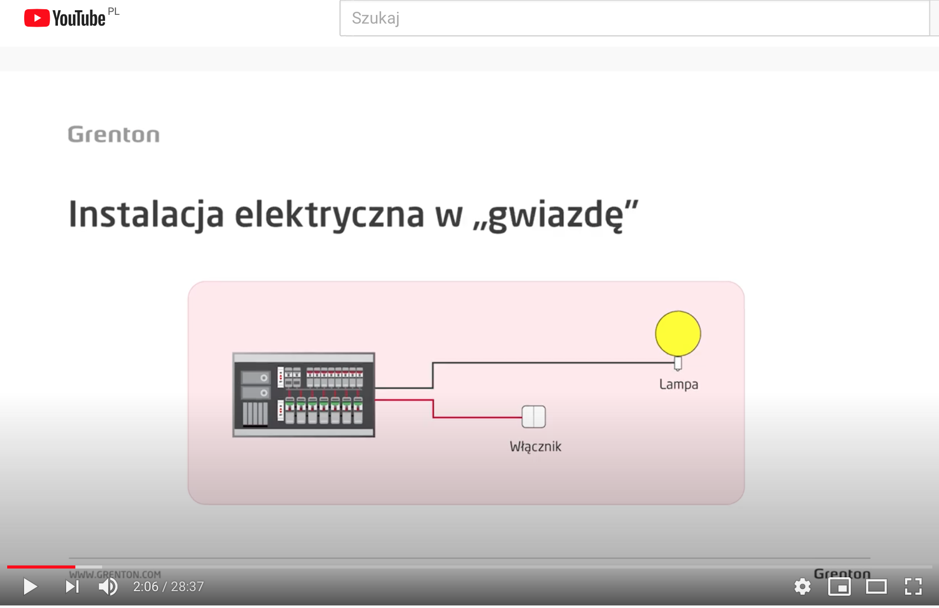

    So looking at this diagram from the presentation from the link you provided:
    The cable goes from the lamp, e.g. 3.x.1.5 (brown, yellow, blue) to the switchboard, then I run the 4x1.5 cable (brown, black, yellow, blue) from the switch to the switchboard, connect the cables from the lamp with the switch cables (brown with brown, yellow with yellow and blue with blue), is left free black which I give the phase? - I fasten the black and brown switch in the box (using the switch) and when I turn it on, it will go from black to brown and the light will shine - I understand it correctly? what should I do with the yellow and blue cables that will be "slowly" left in the switch box?
    Use spare blue and yellow conductors as neutral and PE

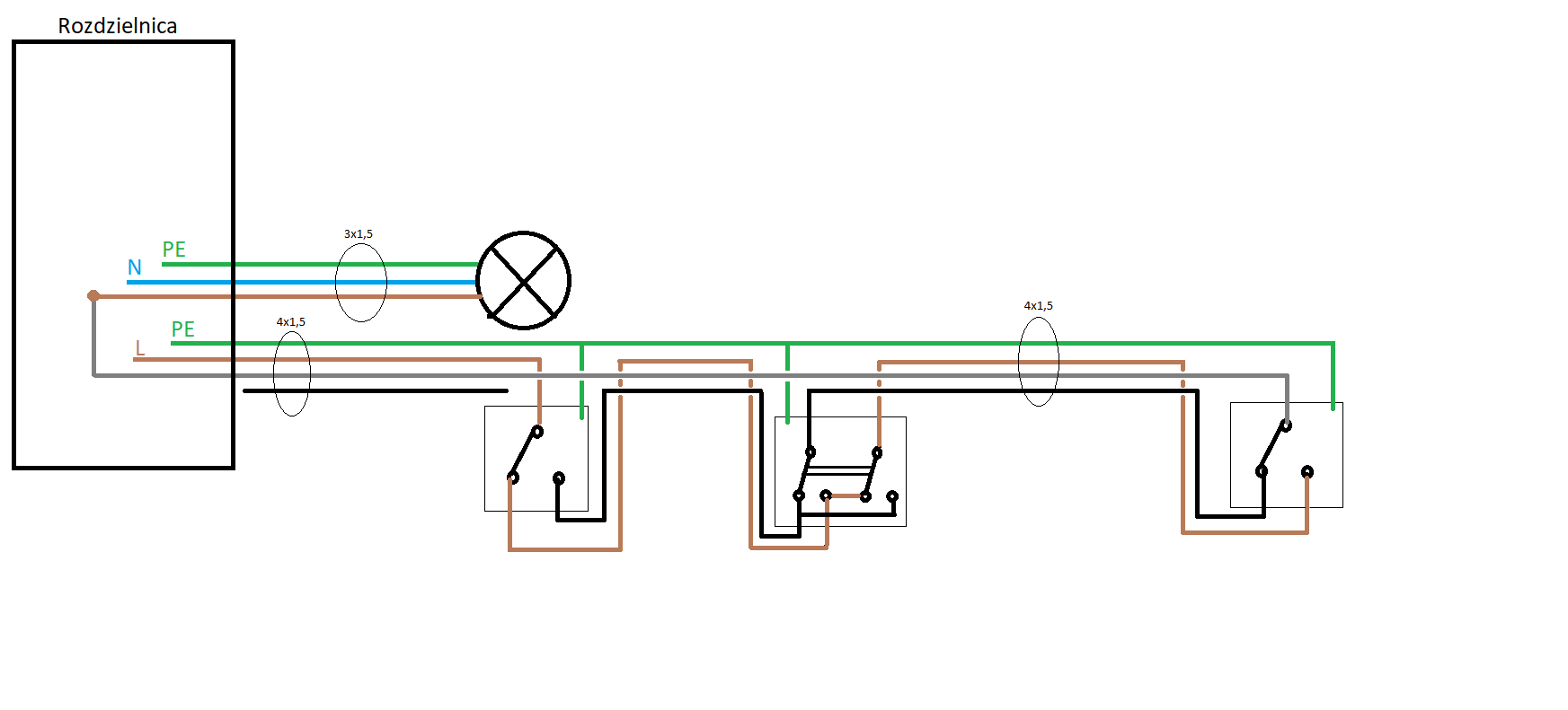

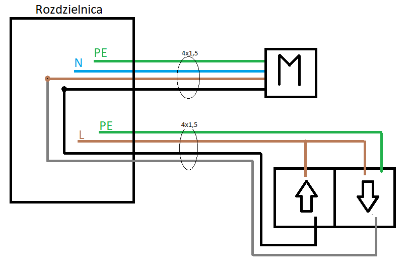

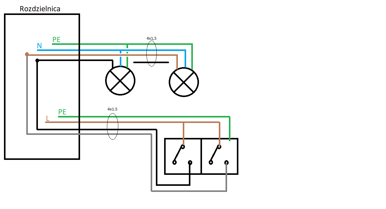

    Good morning,
    I can see that the topic is not closed yet, so I will present my proposal for cabling lighting / roller shutters in a star topology. I don't want to buy a controller at the beginning and create logic - but I want to open the way to building automation in the future.
    I would not like the phase from the connector to appear on the blue wire and 4x1.5 cables with colors without blue I saw on the Allegro so there will be no problem with getting them. So I don't have to buy 5x1.5 to leave the blue wire (N) unused, unless someone below shows that it is needed.
    Below I present drawings of power supply solutions for devices from the above-mentioned assumption and please criticize my solution. During the operation of the installation, I would not be surprised that I did not anticipate something.
    Lighting
    Single switches - 2 switches can be connected with one 4x1.5
    Candlestick switch

    Roller blinds

How should I plan roller shutter cabling in a star topology?
Treat each shutter motor as a load: bring its cable directly to the board. Provide neutral and PE for every motor. Centralize up/down actuation in the board so you can add shutter relays or modules later without rewiring rooms. [Elektroda, gilange, post #19668157]
