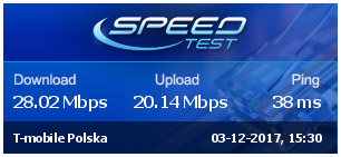

    LTE T-Mobile Home Coverage in Adamówka (37-534): BTS Transmitter in Cieplice - Worth Considering?
    Please check if these are good parameters
    #7 16865243
    matek451
    Posts: 31254
    Help: 4352
    Rate: 5808
    Adequate parameters, low SINR proving a high load, which is confirmed by the lower DL than UL. Test with B525 outside?

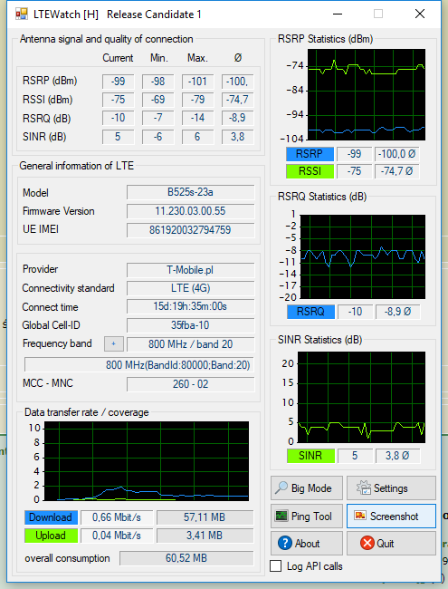

    DL low exceptionally today and only occasionally.
    Current data:
    LTE T-Mobile Home Coverage in Adamówka (37-534): BTS Transmitter in Cieplice - Worth Considering? LTE T-Mobile Home Coverage in Adamówka (37-534): BTS Transmitter in Cieplice - Worth Considering?
    Router in the middle of the attic. And now children are watching something on YouTube

    After moving the router next to the window, the sinr jumped to 13 so I should rather go beyond the walls of the house, I don't know what antennas.
    Probably the cable is about 10m long and I will not see the transmitter physically
