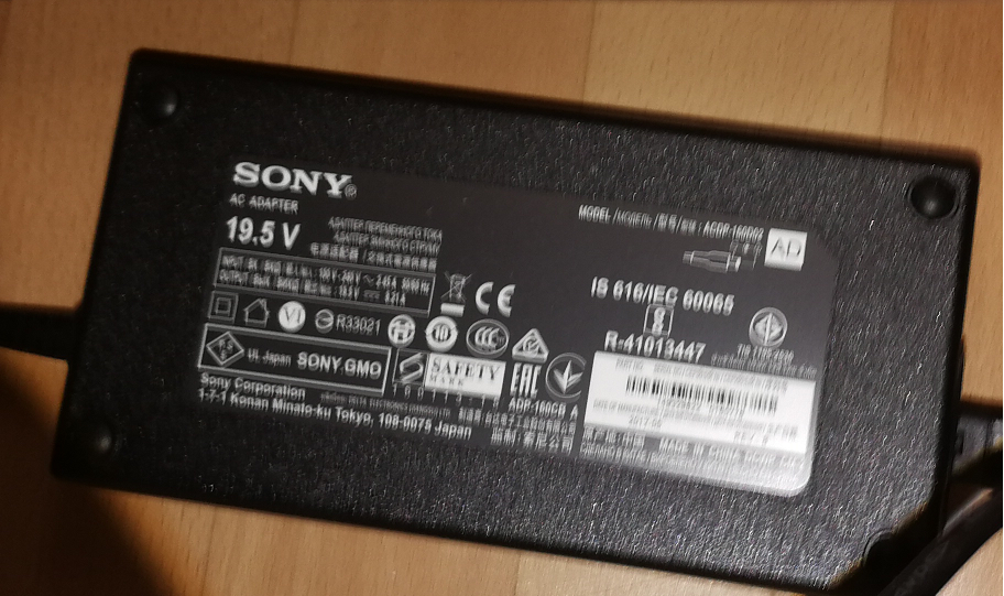

    Amstaff92
    I warmly welcome,
    friends have a Sony Bravia TV installed. I wanted to ask if it is necessary to have a surge protector, I know it should be, but my friends don't want to hear about it? The TV has a power supply as in the picture (sorry for the sharpness) does it have any protection? I would like to add that their decoder has recently broken down during a gale, now they have the card inserted directly into the TV.
    Best regards,
    Matthew
    Sony Bravia - Does the TV need to be connected to a surge protector [/ img]

    Generally every power supply includes (or at least should include) some protection in the form of an ordinary flux, but a surge protector will not hurt them. ;) Honestly speaking, personally, I had some unpleasant situations and now only uses them.

    Thank you for your answer. In total, there is still a problem that there is no earthed socket and from what I know, the surge protector fulfills its assumption only if it is connected to the ground. Uncle said that he would not call an electrician to check the socket if the manual says "the power supply is to be connected to a power outlet" and there is not a word about a surge protector. I know that you can bridge the PEN neutral wire with a pin, but after yesterday's discussion on this topic, I ran out of arguments, although I found the terms of the SONY warranty somewhere and it probably says that the warranty does not cover failures caused by voltage surges. As he said, he does not want to pay for something that may not be needed at all. His next argument was that the plug from the TV power supply is flat and since it is without grounding, the strip is unnecessary, although from what he knows, the equipment connected to the strip does not have to be grounded, it is important that the strip is connected to a grounded outlet. I will add that I tried to convince him with my own example, I have a Samsung TV myself and it is connected to the strip, but my argument was beaten by Sony's superiority over Samsung. Would anyone have any argument in favor of having a strip or would it be better to give up? Thank you in advance for your answer.
    Ground has absolutely nothing to do with anti-overvoltage action, because it does the protection for it varistor. Earthing is just another protection, which of course is not mandatory by law, but it's better to have than not to have. ;) But that doesn't change the fact that the lack of grounding does not eliminate the possibility of having such a strip.
    And what should it be connected to if not to a socket ...? Uncle has any other idea? Well, the surge protector is hardly said to be true, some devices require it from the top and write in the instructions, but it is not recommended as much as it simply "gives comfort to the spirit and body". In other words - you sleep more peacefully with this strip . ;)
    What you mentioned is the so-called reset the pin , which is how you rightly noticed connecting N to PE. Honestly, the electrician is not really my hobby, because I search mainly in electronics, but as an electronics technician in general I'm not a fan of pin reset ...
    Go back to the beginning.
    If he is not convinced by such arguments, I will give you this advice from pure experience - do not try to persuade everything has further consequences.

    With an external power supply, it makes no sense to give a strip. Recently, the TV power cord was like a "computer" with grounding. Now the usual two-wire.
    When it comes to lightning, it is only through the antenna. Maybe once in every thousand or so someone has an overhead line and lightning strikes through the net.
    The only explanation to give the strip a peace of mind is that you have done everything they recommended and if you "hit" it, there is no help.
