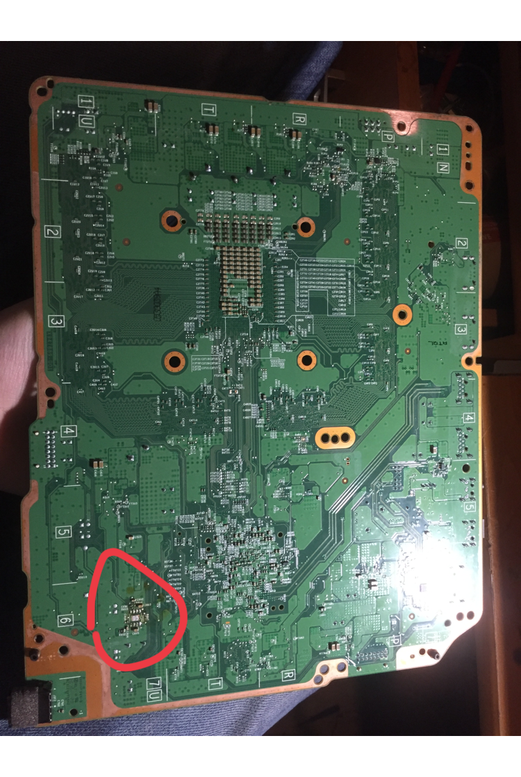

    Hello! Please identify the item. Hard to read, probably 8104sy1, but can't find anything like that in google.
    The element on the board is marked as U6U1, the housing is sop-8. It is located near the front USB socket on the bottom side of the motherboard. Maybe some stabilizer? It does not look like an eeprom, because the pins do not match. In addition, there were 5V, 2.5V voltages on it (possibly 3.3V, but only because of the damaged converter), the mass was not in this place as in a typical eeprom, so I don't know anymore.
    In addition, I will ask if anyone knows about buying parts for takigo xbox? It's terribly hard to get a converter, for example, I had to buy replacements. NB669 is still available, but MP8757 is not. I had to buy a replacement in a different housing.
    I'm adding a photo with the location of the item.

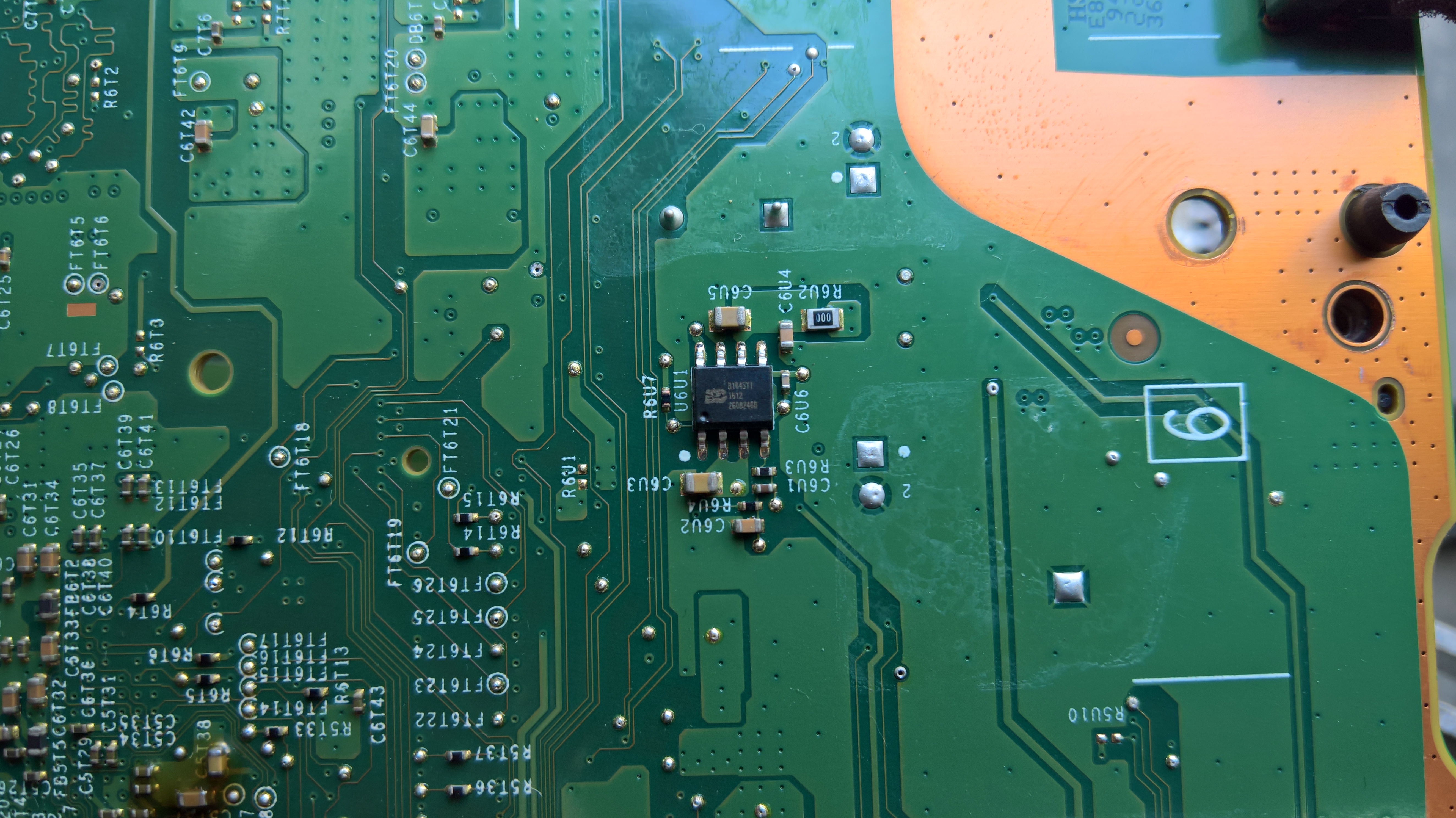

    Hello, it's hard to get somewhere a photo of the motherboard from Ski, but I asked for the chip number and maybe we'll find out what is the only thing I found.
    Xbox One S: Identifying Item 8104sy1, U6U1 SOP-8 Element, Voltage Stabilizer - Parts & Replacements

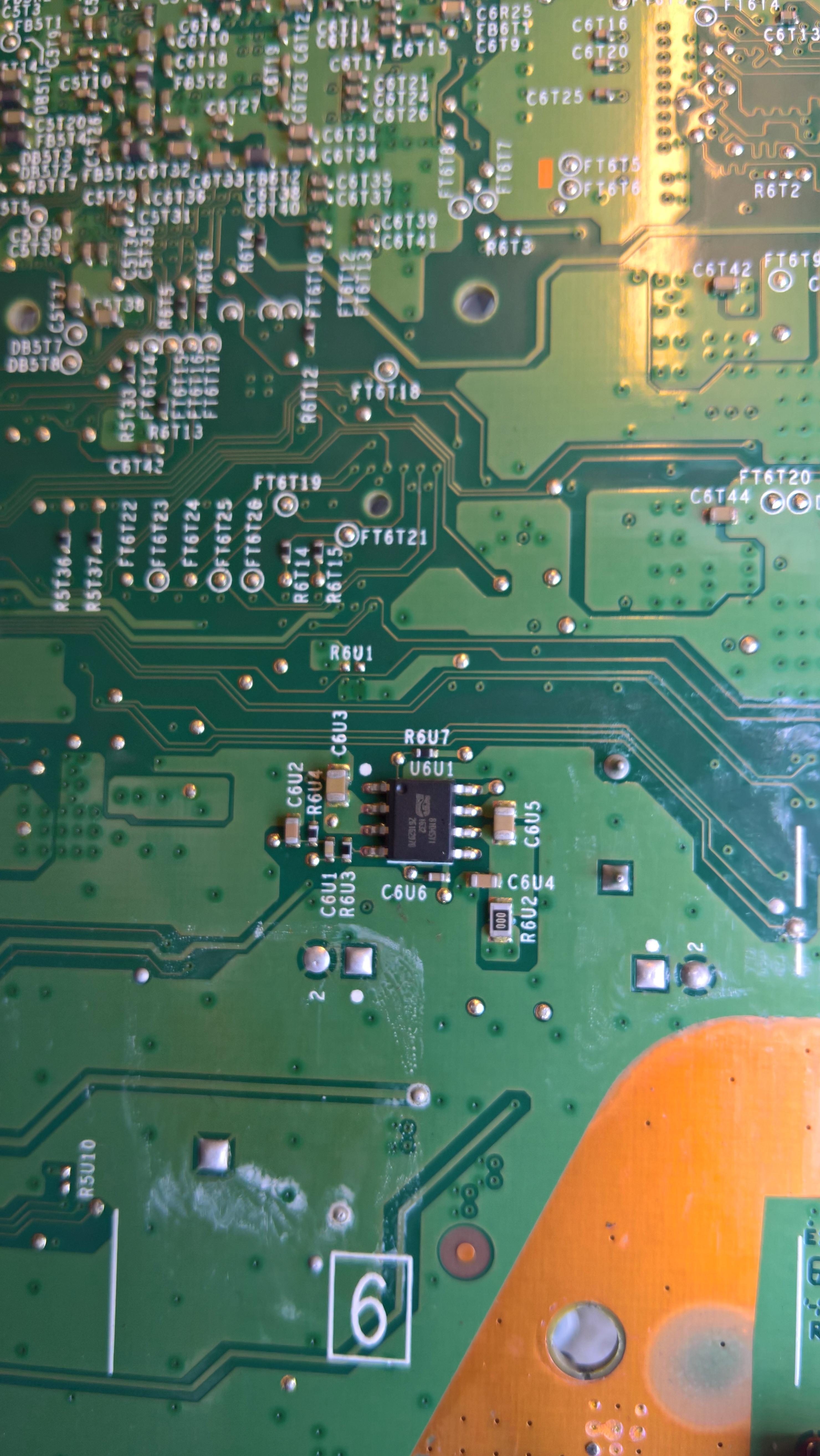

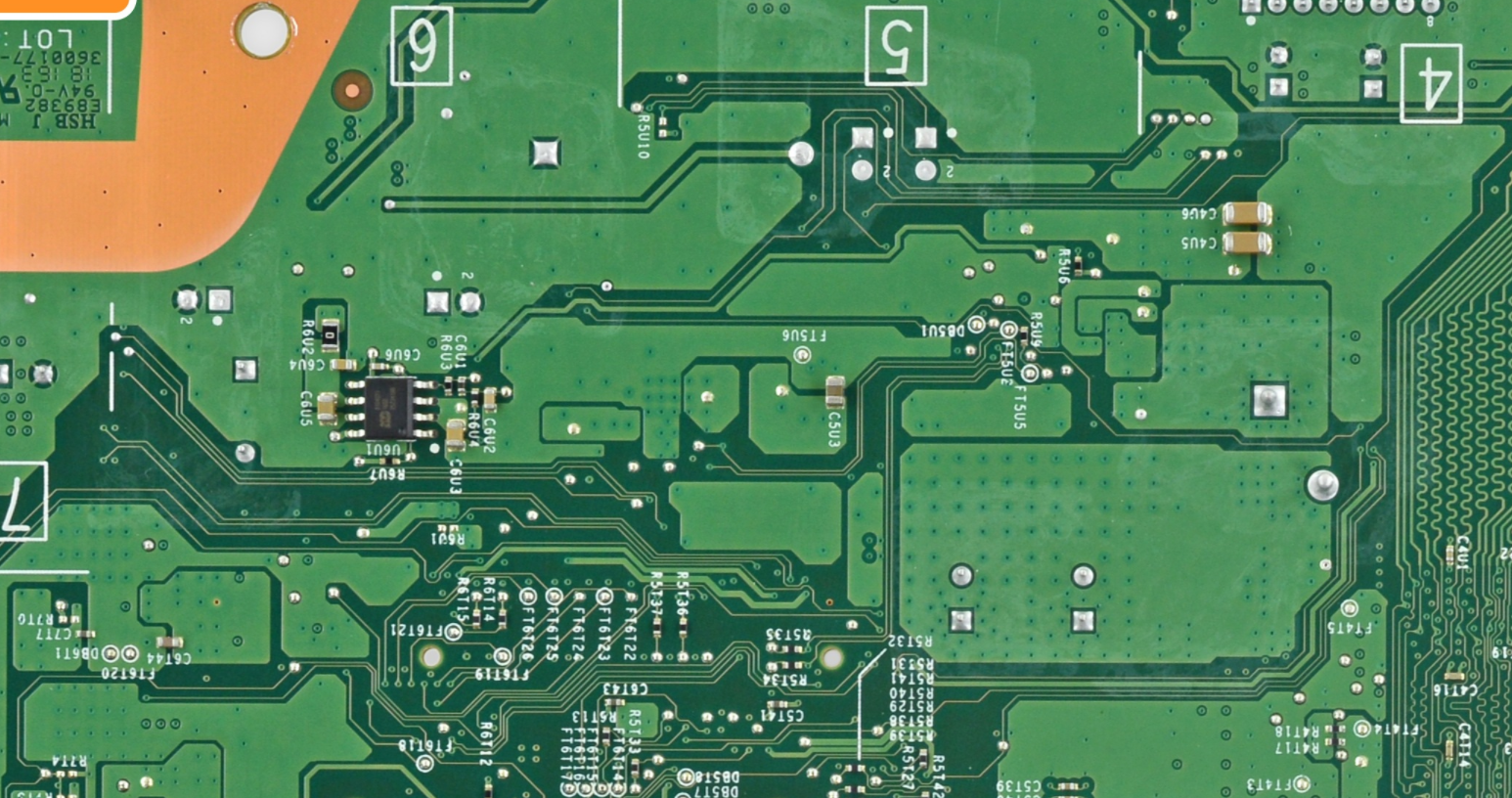

    Picture of the element. 2 motherboards.
    • Xbox One S: Identifying Item 8104sy1, U6U1 SOP-8 Element, Voltage Stabilizer - Parts & Replacements WP_20171019_09_19_56_Rich.jpg (1.19 MB) You must be logged in to download this attachment.
    • Xbox One S: Identifying Item 8104sy1, U6U1 SOP-8 Element, Voltage Stabilizer - Parts & Replacements WP_20171019_09_12_14_Rich.jpg (3.66 MB) You must be logged in to download this attachment.

    Thank you very much for the photos! Still, I don't know what this element is and what role it plays.
    The only thing I could find was the MCP1612. It looks similar, but I would still have to measure the small parts around the system to be sure.
    http://ww1.microchip.com/downloads/en/DeviceDoc/21921C.pdf
    @ lysy1980 You have access to two such plates, so maybe you have a dose from which you could desolder one? I am happy to buy it back.
