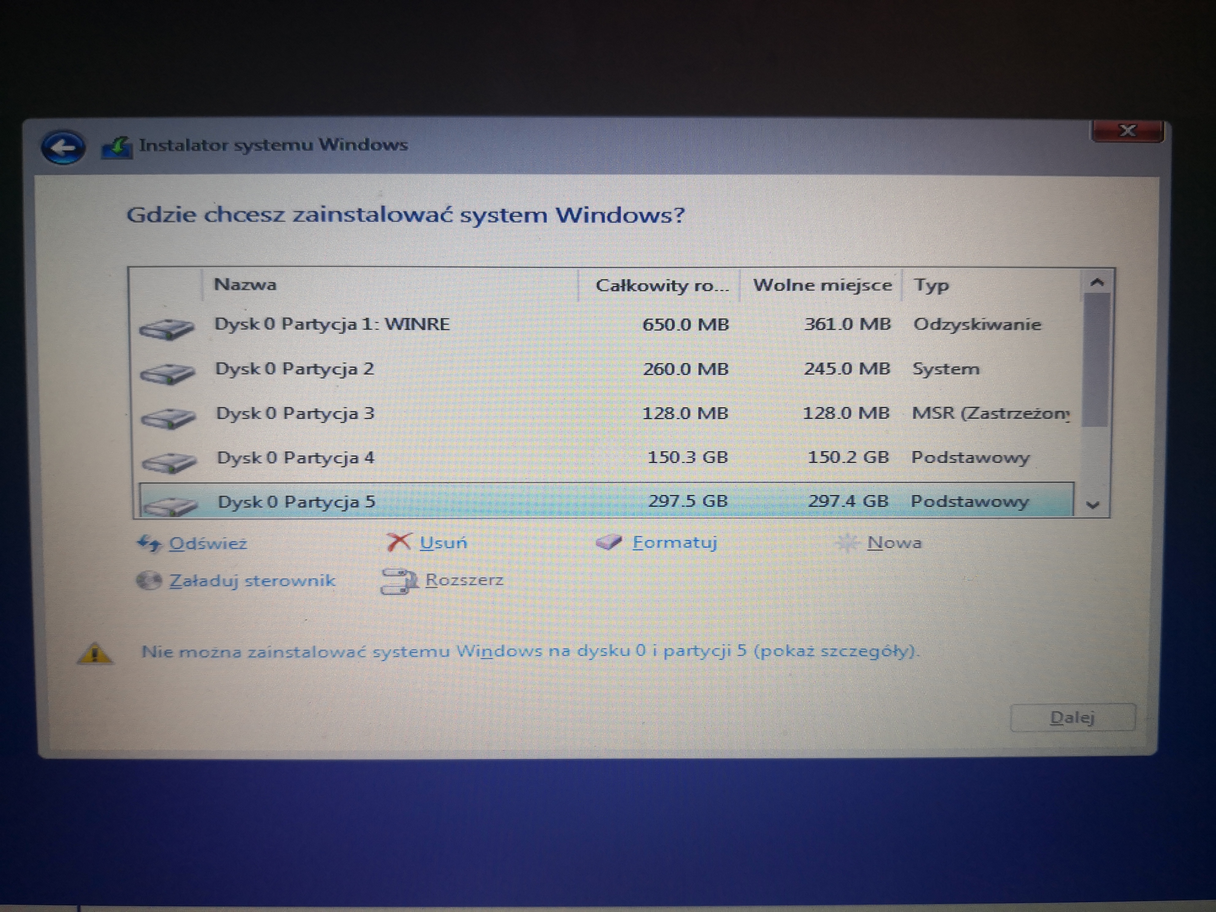

    Ok, the pendrive has started but something is wrong, I can't format any partition and I can't install windows 10 on any drive.
    Booting Windows 10 from Pendrive on HP 250 g3 Laptop: Blue Screen Issue Booting Windows 10 from Pendrive on HP 250 g3 Laptop: Blue Screen Issue

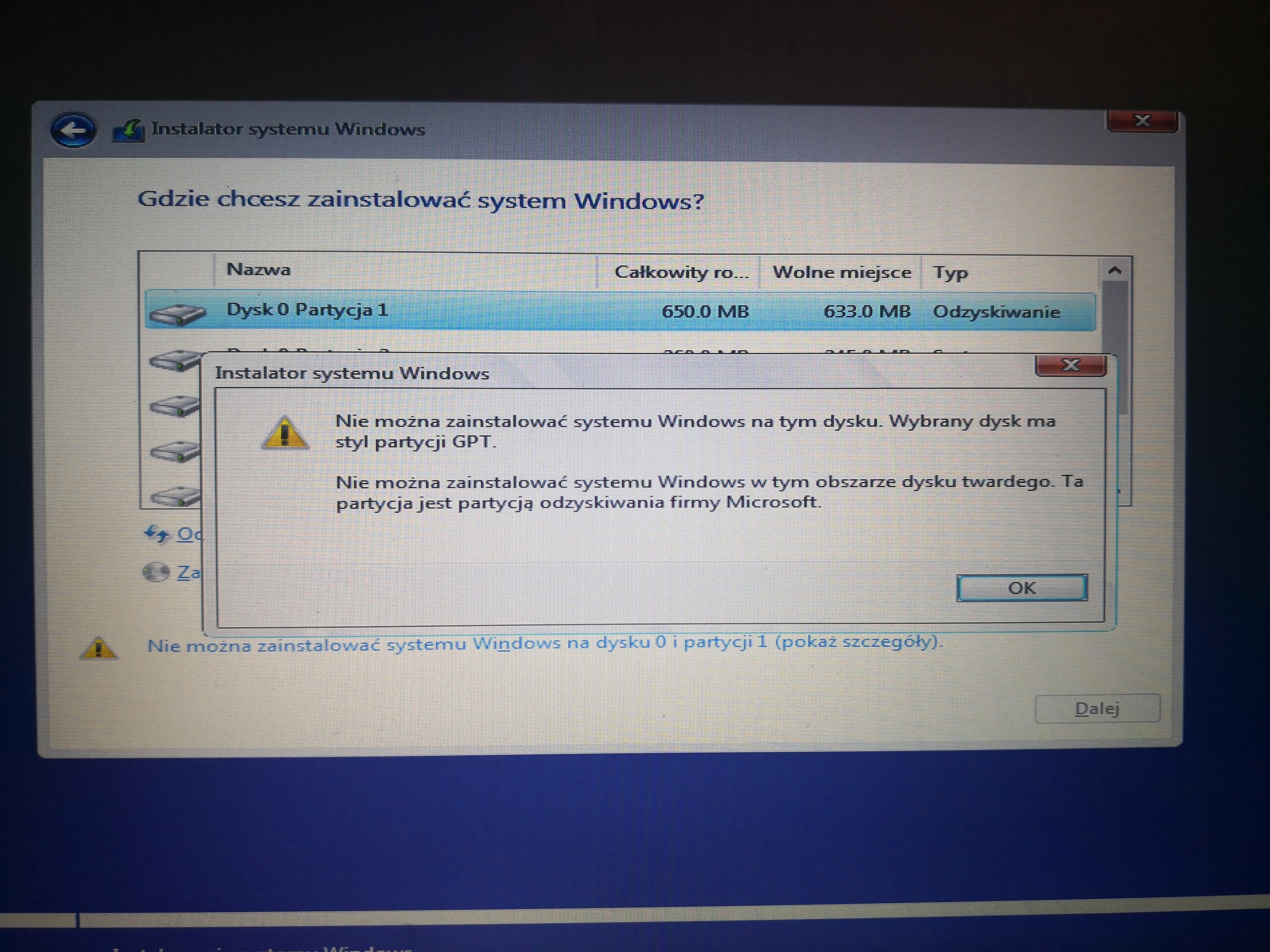

    And now I can't even boot my laptop and the old system.
    Added after 6 [minutes]:
    Unable to format partitions - Selected disk has GPT partition style

    Now I have yes and the system is not booting.
    I thought it would be ok.
    Added after 8 [minutes]:
    So, because of this, gpt won't install windows 10? Because the pendrive starts.
    Added after 9 [minutes]:
    I took advantage of this:
    https://www.youtube.com/watch?v=_uR8HS2xxsA
    and the installation of Win 10 has started, I wonder if the new Windows will start.
