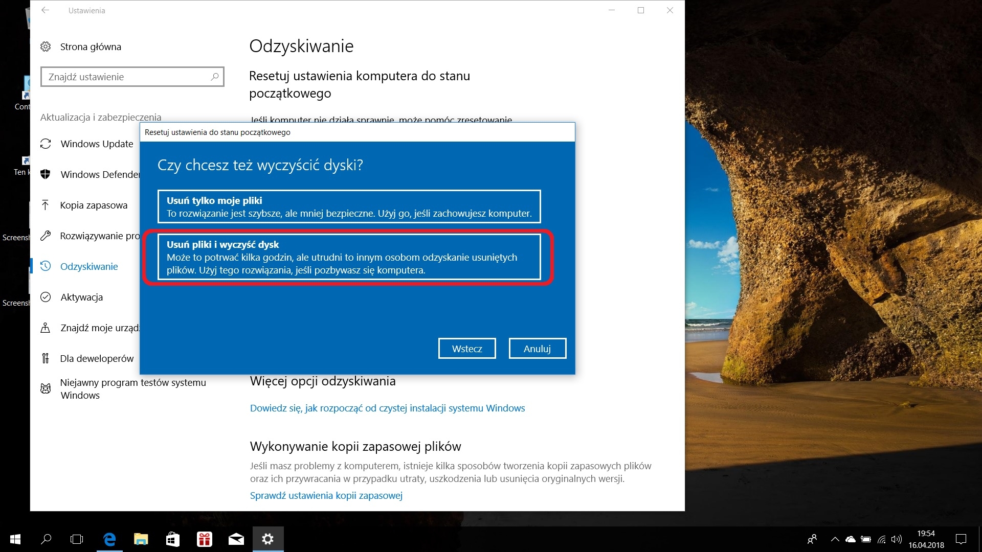

    I bought an ASUS STRIX laptop with a factory installed Windows 10 (i.e. I do not have an installation CD W10).
    I would like to uninstall W10 and upload the original W7, but nowhere can I find how to do it. The only guides I found were "Restore factory settings", "Return to previous version of Windows", etc.
    I found something else: https://www.youtube.com/watch?v=VSOBt0TUXL8, but I do not know if it is safe and worth the candle and if it works like I put a plate with Windows 7 (for now I get a window with a description : "Windows can not update the installation files." "To install Windows, close the installer and run the installation again. Error code: 0x6" - I understand that W10 does not allow me to install the older version.
    In general, I mean formatting a Windows 10 drive so that I can easily install W7
    I am asking for help and thank you in advance.

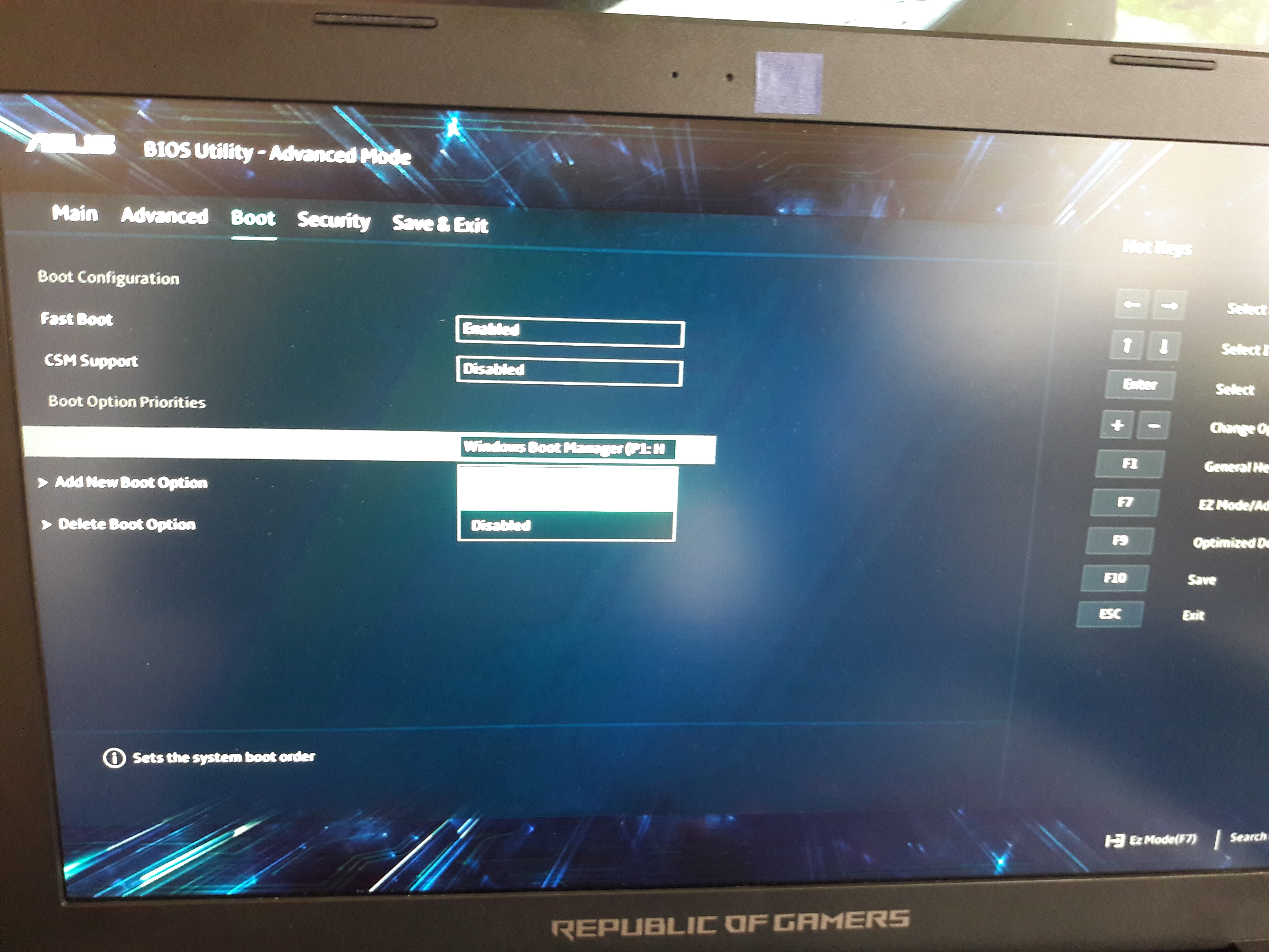

    Only that I do not have a normal bias, unless I'm wrong and I go through F2 not in what I need ... in any case, I did not find there the option to run the disc from the drive. Transitioning from Factory Installed Windows 10 to Original Windows 7 on ASUS STRIX Laptop
    If it were so simple, I would not write about my problem here ;)

    I did as you wrote, I just had to insert the installation CD first to let me detect the drive. The installation started and then the blue screen; (
    And what now ?

    Chrooms wrote:
    Only that I do not have a normal bios, unless I'm wrong and I go through F2 not in what I need ... in any case, I did not find there the option to run the disc from the drive (
    Scroll (usually with the PgUp / PgDn or +/- keys) Boot Option Priorities so that the disc is in the first place.
