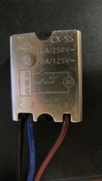

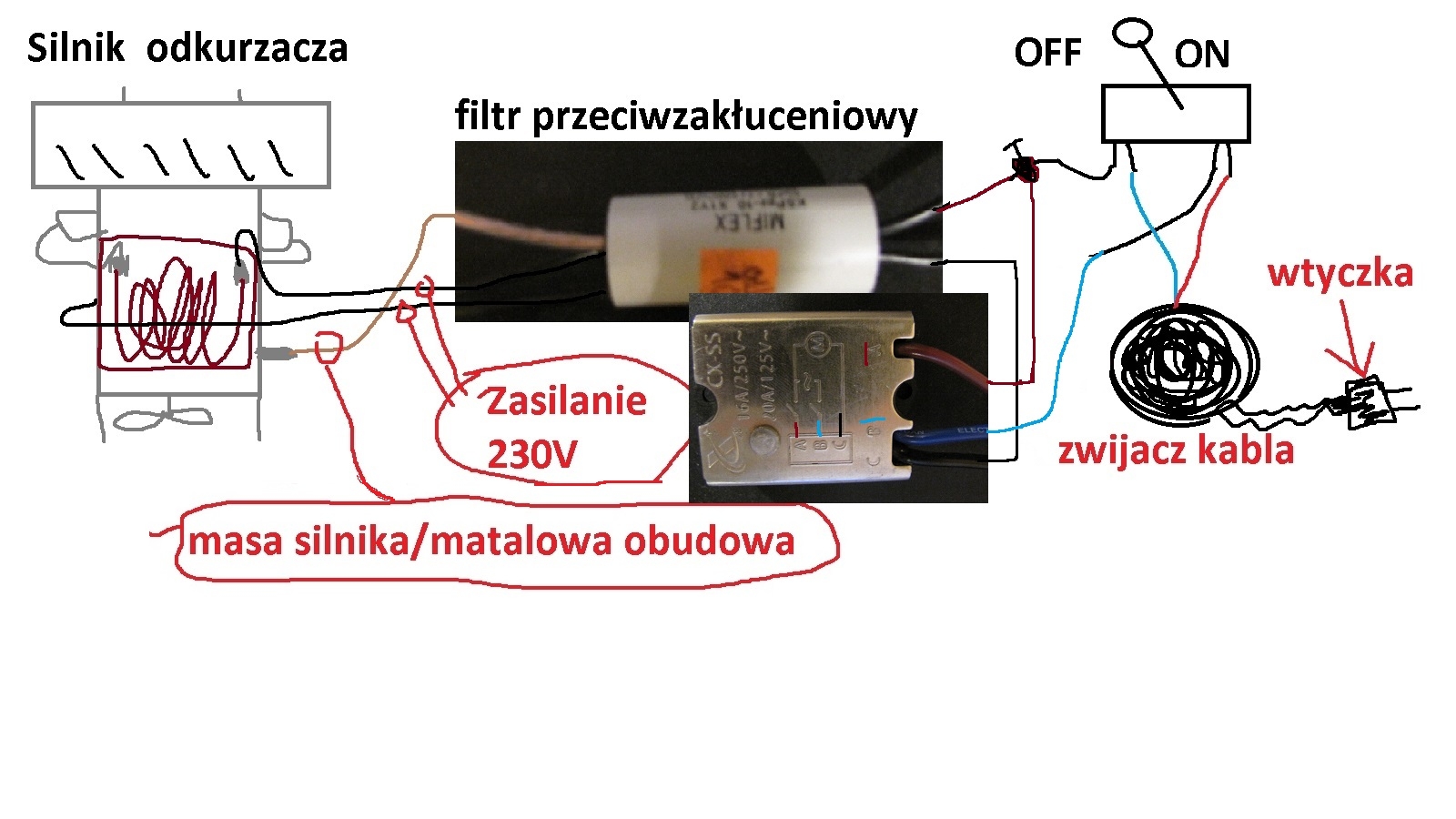

How should I wire the soft-start module in a Zelmer vacuum cleaner with an S-690 motor, and should it be placed before or after the anti-interference capacitor?
Connect the soft-start module upstream of the anti-interference suppression capacitor [#16770328] One suggested wiring is: black to the motor power lead, red to the switch together with the second motor lead, blue to the switch, and the capacitor connected together with the red and blue wires [#16770277]

    Hello. Ie. soft start of the engine very simply, connect the black one to the engine power cord
    red for the switch together with the 2nd power cord for the motor with the switch and blue also for the power switch. And we plug in the capacitor together with the red and blue ones.

    Connect upstream of the anti-interference suppression capacitor.

    I think that the anti-interference capacitor will work before or after.
