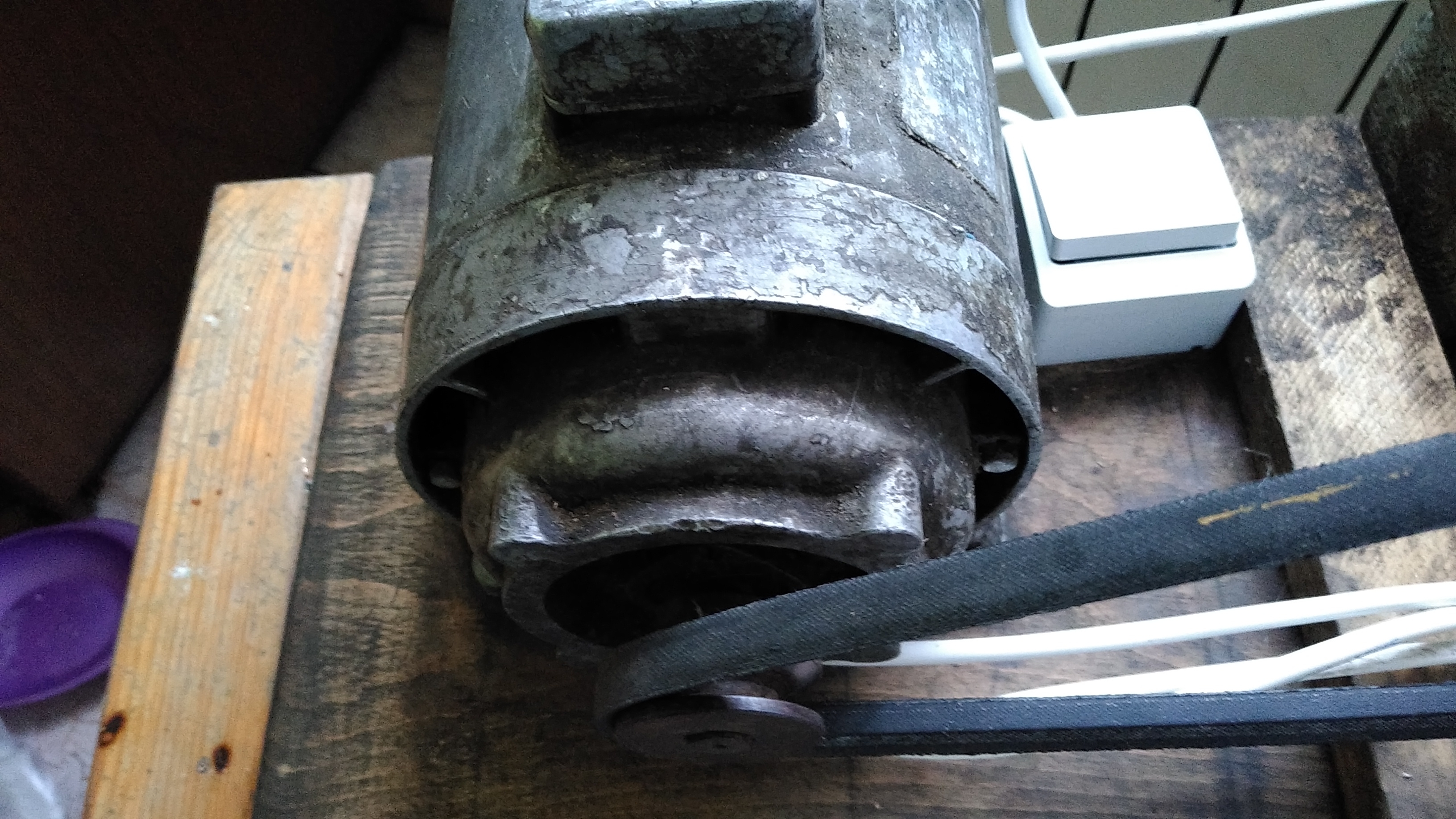

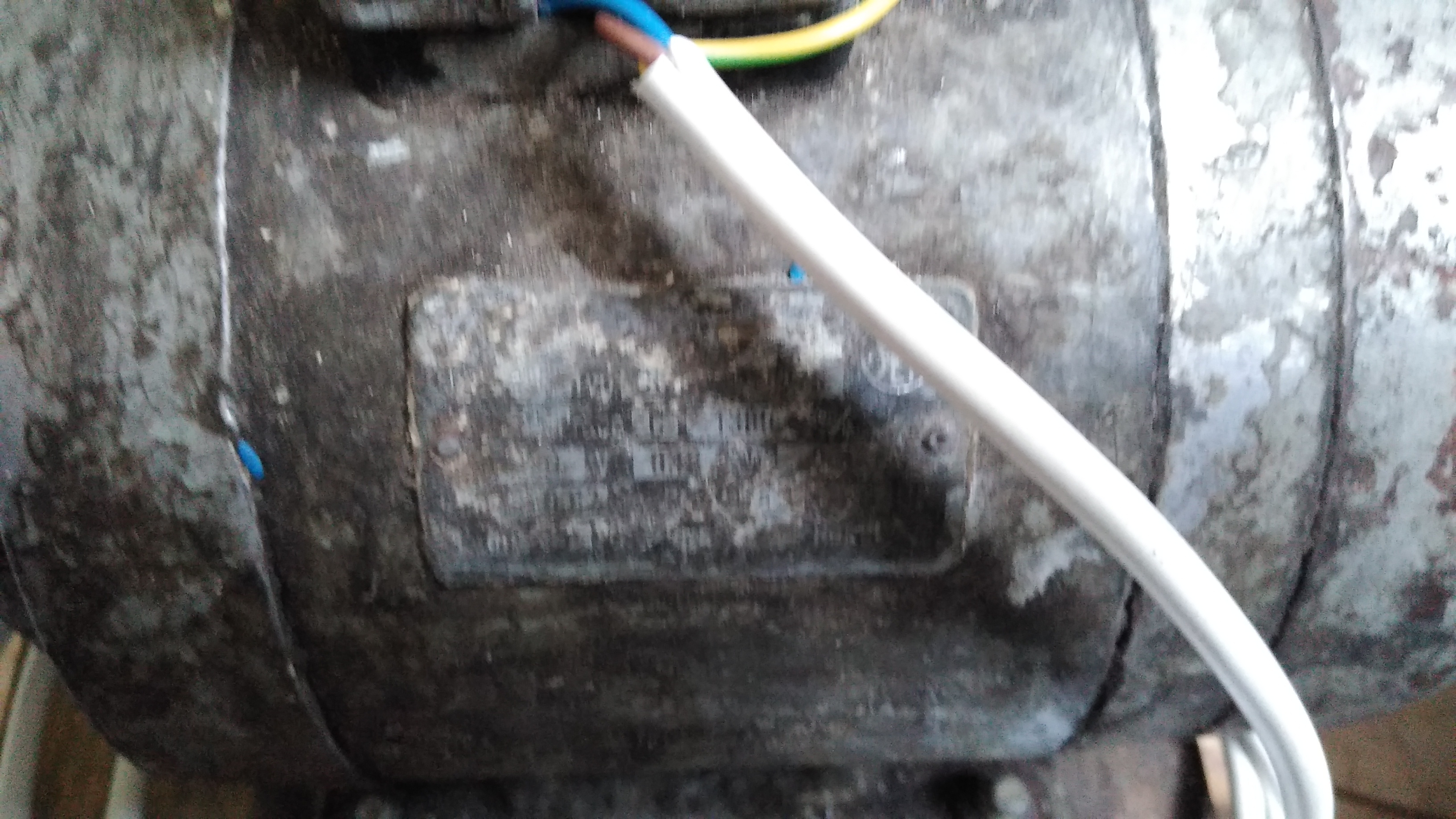

    Hello. The case concerns the use of Frania's washing machine motor.
    Utilizing Frania Washing Machine Motor for Meat Grinder Power: Starting Capacitor Query Utilizing Frania Washing Machine Motor for Meat Grinder Power: Starting Capacitor Query
    Motor shown in the photo. Nameplate not legible. The motor is to be used to power a meat grinder. The problem is engine starting. The motor hums after the voltage is applied, and starts only after turning the rotor. The kind of question that needs to be applied to get it going. Is it possible to use a starting capacitor.

    Hello !
    Unscrew the can on the engine, show what's inside.

    Thanks for the response. This link doesn't tell me much. I still have not received an answer whether the motor can work in this condition or requires an additional capacitor.
    I am not an electrician by profession and I do not want to embarrass myself in front of my family. According to the statements of people using this engine, it was used in this way.

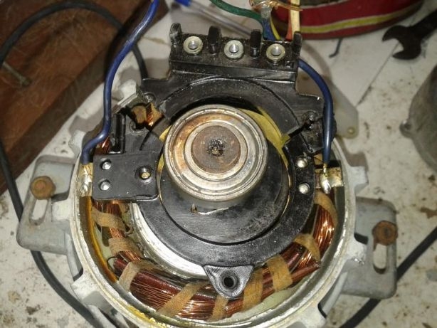

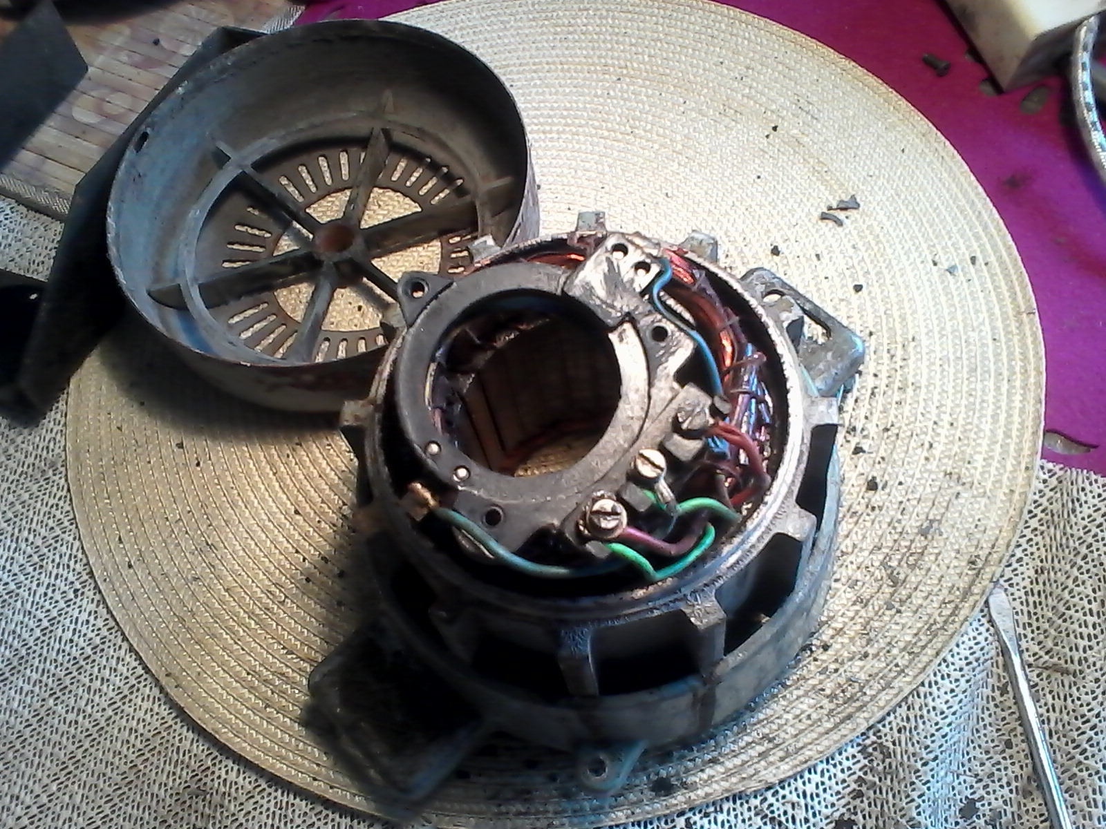

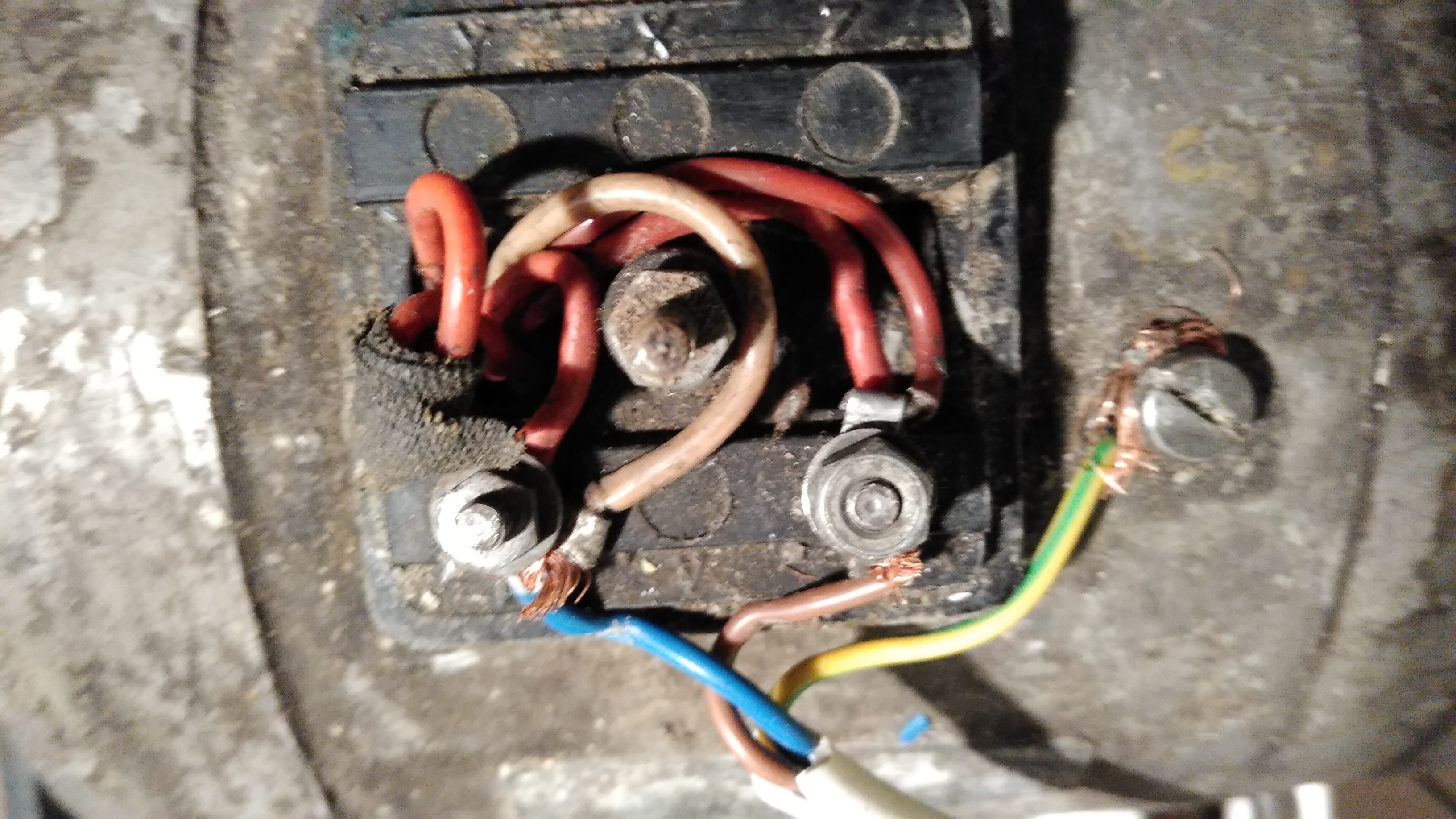

    This motor has an internal centrifugal starter switch, something like a Watt regulator. Disassemble this motor, check the contacts of this switch and the operation of its mechanism. The switch weights must slightly move the switch sleeve and the switch plate. By the way, measure the resistances of both windings - starting and working.

    It is a 180 W motor and it worked without a capacitor and the operation of the centrifugal switch should be checked. If it is fully operational and its contacts are in good condition, the starting winding may be damaged. If you overload the engine above the norm, the speed will drop and the centrifugal system will activate the starting winding, which should not happen.

    @ Kierbedz4 Such a centrifugal switch can be removed and an external Kliston starter from the chillers can be used. Of course, the efficiency of the starting coil is essential. @Henio 123 And when working without load, this engine starts by itself?

    Removing the motor. Checking the starting device resistance. Installation and restarting. The motor works without any problems.
