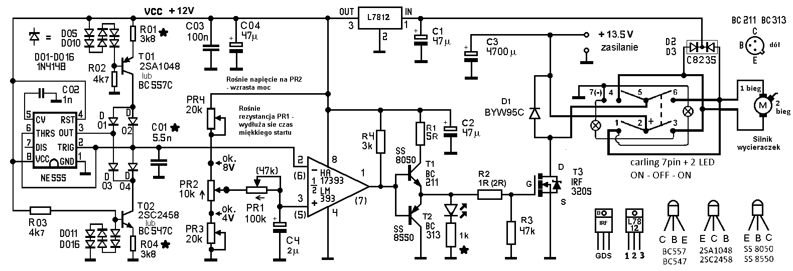

    The circuit was created out of the need to smoothly regulate the speed of a VAG automotive wiper motor. The motor drives the knot toaster shaft via a 2:1 gear ratio. Previous methods using two motor speeds and two voltages from an ATX power supply (somewhat regulated) proved ineffective. The ATX power supply now has the voltage raised to 13.5V permanently. The motor is also reworked - isolated the brush from the ground and an extra wire brought out. This gave the possibility of rotation in both directions.
    In the design I was keen for the system to operate beyond the limit of human hearing, so that no squeaks or whistles could be heard, as it takes about two hours to bake a knot. The regulator I made earlier for drilling into PCBs with a motor from a screwdriver on an LM358 works fine, but you can hear the sound. Fortunately, this PCB activity does not last long. The soft start is designed to eliminate jerks and to cause a slow increase in the current drawn from the power supply, as the ATX power supply's short-circuit protection circuit does not like abrupt changes.
    The project came about after unsuccessful attempts to generate higher frequencies on operational amplifiers and use them as comparators. Searching the web I finally found a triangle generator solution to adopt. The generator worked immediately. I then struggled a bit with MAA741 and LM358 as comparator - they didn't work. A typical HA17393 comparator worked.
    I designed the generator current sources on transistors. I decided that for my application they did not need to be very accurate and replaced the operational amplifiers in the triangle generator (link one) with transistors (any low power pair). I replaced the Zener diode with six ordinary ones because I didn't have one. The generator started and stayed that way. In general, the regulator is made from 'recycled materials', from disassembly and everything that was already there. I only bought a 10k rotary potentiometer and two precision ones of 20k each.
    The regulator from the schematic works at about 16000 Hz. There is no noise or squeaks. A bit about the settings. PR2 is the PWM control. Using potentiometers PR3 and PR4, you can set from which speed the motor should start. The minimum I have set myself is that the motor has a low speed and is always rotating. From this speed, you can adjust up to 100 %. To set the soft-start time, potentiometer PR1 and capacitor C4 are used. (Instead of PR1 there is a 47k resistor.) For starting it is good to have an oscilloscope, but it can also succeed without one. Approximate voltages to set are given.
    I am an amateur electronics technician and the text below is based on internet news.
    The charging (discharging) current of capacitor C01 flowing through resistor R01 (R04) must be small to get a good signal shape, the current flowing through resistor R01 should not exceed 20 mA.
    This current is calculated from the formula
    I=(UD5-D10 - UBE)/R01, I=(3.6V-0.6V)/3800Ω=0.00078947A
    where UD5-D10 is the voltage drop across the diodes - 3.6V(in this case 3*0.6V), and UBE is the conduction voltage at the base-emitter junction of transistor T01 (0.6V).
    If the charging and discharging currents are equal then the charging and discharging times (rise and fall) can be calculated from the formula:
    T=VCC*C01/3*I
    The period will therefore be 2T and the frequency f=1/2T

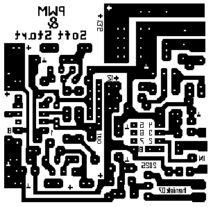

    The layout meets my expectations. I am posting with the hope that someone will use it. I'm not posting the circuit boards because it's a bit of a hybrid made up of two boards. The first is a triangle waveform generator on an LM555 timer. It's good, no tweaks, but it's just a 555 cube and literally a few components. The second is a soft-start PWM, now on an LM393 comparator. Previously there were trials on an MAA741 operational amplifier and an LM358. There is now an adapter in a half spider from the 741 to the 393, a few jumpers and components on either side of the board, so it doesn't make much sense. I chose to split it into 2 boards because of:
    - lack of space in the chassis where the circuit has to fit,
    - I didn't know if the circuit would work (I'm just an amateur and I have big deficiencies in electronic knowledge, I decided to divide the project into a generator and a PWM regulator, hoping that if the generator works, then I will deal with the PWM with soft start, on this or another schematic).
    Unfortunately the last point worked out fine, I was combining on a couple of versions.

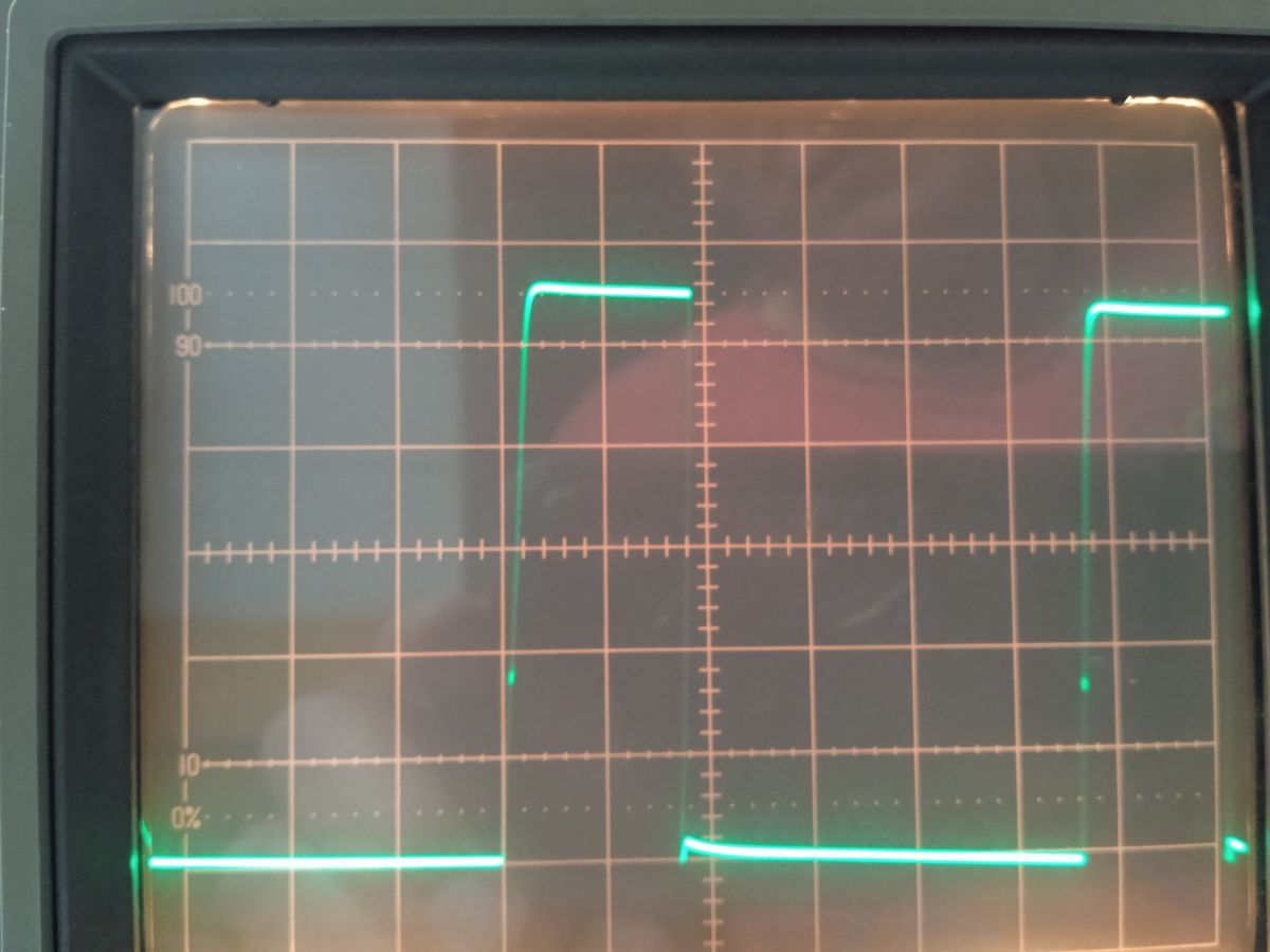

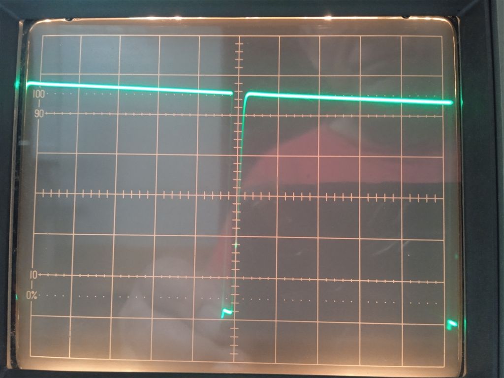

    Just before maximum filling.
    Ultrasonic PWM with soft start for speed control of a DC motor. .
    Set minimum turnover.
    09. 07. 2025 r.

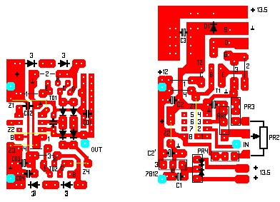

    I am posting the reworked tiles, in the hope that perhaps a colleague will benefit. It is still a hybrid solution. If anyone needs to convert, please write to PW. The tiles are done in plain Paint. A long time ago I made a small project on the fly and it stayed that way. Then it was just copy paste. I know there are dedicated programs, but my penultimate board was made in 2022.
    Tiles:
    Ultrasonic PWM with soft start for speed control of a DC motor. Ultrasonic PWM with soft start for speed control of a DC motor. .
    Elements on pathways:
    10. 07. 2025 r.
    Boards together, you will not need one jumper - Z3 on the triangle generator. You need to connect OUT to IN.

    You have not taken into account that too high a frequency, will generate losses in the (steel) cores. The maximum that is used is 200 - 500 Hz. 16 kHz is the frequency of the FBT in CRT TV.
  • #3 21599067
    heniek07
    Level 21  
    Posts: 432
    Help: 29
    Rate: 221
    The lack of squeak in the ears is more valuable in this application than the loss of energy.

    Amateur to professional question:
    If I use a pulse capacitor of 0.1 to 1µF in parallel to the D1 diode, could it be that the motor will run at some constant voltage without dropping to zero? I saw such a solution on one of the eastern sites.
    Greetings
    Heniek
  • LC low-pass filter recommended instead of capacitor bypass
    #6 21599168
    CosteC
    Posts: 5370
    Help: 401
    Rate: 1668
    heniek07 wrote:
    If I use a pulse capacitor of 0.1 to 1µF in parallel to diode D1, could it be that the motor will run at some constant voltage without dropping to zero?
    If you do this you will be putting short circuit pulses through T3 that are limited by this new capacitor. Bad idea. Losses will reach C*U^2*0.5*f.
    A low-pass filter, preferably LC, falls between the drain of T3 and pin 5 of the relay. It will reduce the AC component of the motor current, reduce losses but also make it difficult to change the direction of rotation very quickly.

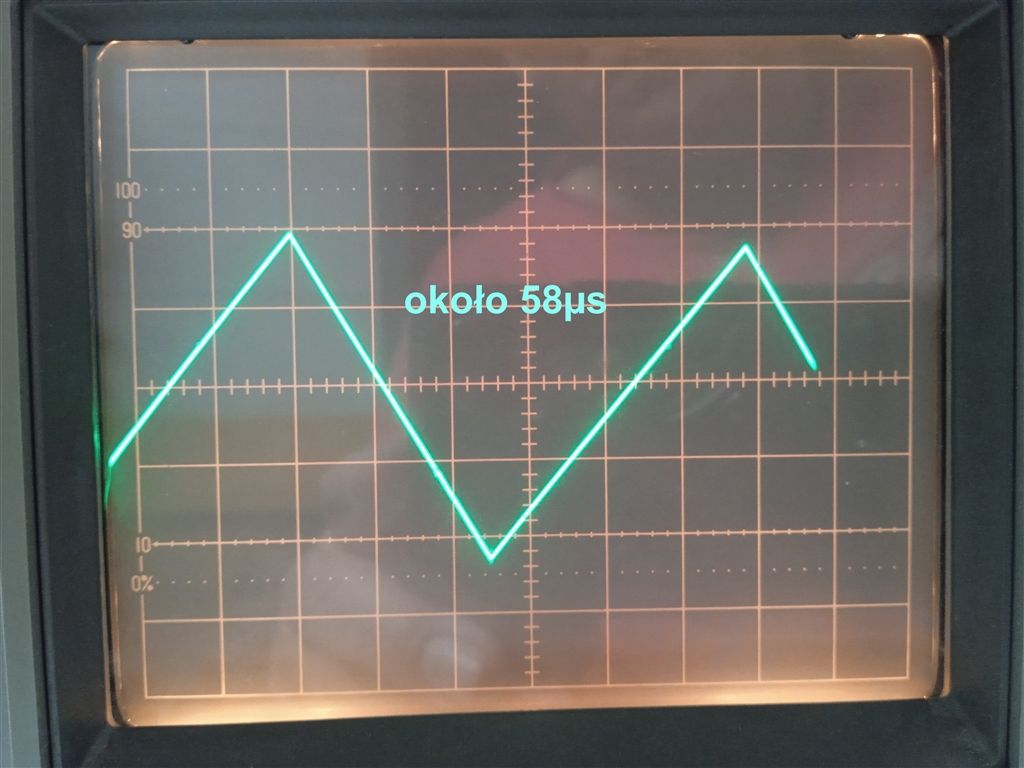

    heniek07 wrote:
    The lack of squeak in your ears is more valuable in this application than the loss of energy.
    I'm afraid the squeal is there and reaching your ears, only you can't hear it. I probably wouldn't hear it either. But 16 kHz is within the range heard by humans (it's not ultrasound) and very young people (teenagers) should be able to hear it (it might bother them).
  • #11 21599303
    heniek07
    Level 21  
    Posts: 432
    Help: 29
    Rate: 221
    The 58µs period is about 17 241Hz.
    I'll have to bring in someone younger and ask for detection. If it bothers the youngsters I will reduce the capacitance of C01 from 5.5nF - it is put together with 3.3nF and 2.2nF. Maybe 3.3nF + 1nF will be enough to get the frequency up to 22kHz.

    It's been raining since this morning, so I've reworked the pcb boards, in the hope that one day I'll replace the makeshift, or I'll need to make another circuit like this. I converted the boards from double-sided to single-sided, because aligning the two planes in amateur conditions is difficult. One time it is perfect and the next time it is offset by 1 mm. Originally I only had a double-sided laminate and this was the design. I am posting the boards in the first post in the hope that someone might use them.

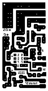

  • Single-sided board conversion for easier alignment
    #24 21602028
    ArturAVS
    Moderator
    Posts: 26415
    Help: 2303
    Rate: 7830
    heniek07 wrote:
    the next project will be based on Arduino
    Arduino is practically C++...
    heniek07 wrote:
    I converted the boards from double-sided to single-sided because aligning the two planes in amateur conditions is difficult. One time it is perfect and the next time it is offset by 1 mm. Originally I only had a double-sided laminate and that was the design.
    https://www.elektroda.pl/rtvforum/topic3937477.html#20307300

    When drilling into the tiles, I can withstand the sound, as the activity does not take long. Unfortunately, the knot is produced in 2 - 2.5 hours. That's a long time to listen to unpleasant sounds.
    I have also added to the first post a drawing of the tiles joined together. The total is about 6 cm x 6 cm.

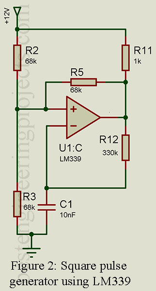

    heniek07 wrote:
    The project came about after failed attempts to generate higher frequencies on operational amplifiers and use them as comparators.
    I don't understand why people try to use amplifiers as comparators. What's the point in that?
    If I wanted a generator with linear slopes then maybe I would make one like yours, but do you need linear slopes?
    The simplest circuit with a comparator is like this
    The triangular waveform is on a capacitor
    It gives slightly skewed slopes but in this application what does it matter?
  • Why op-amps are often used as comparators
    #30 21605833
    CosteC
    Posts: 5370
    Help: 401
    Rate: 1668
    Because:
    - Same symbol.
    - Same basic operation (very high-gain open-loop differential amplifier).
    - Because they have bunches of operational amplifiers in the drawer.
    - Because they don't always need the OC output, which sometimes hinders rather than helps due to the frequent reference to the negative power rail.
    - Because it would often be better to have a symmetrical output.
    - Because understanding the differences in construction and operation is not that simple and rarely well explained.
