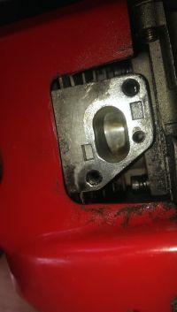

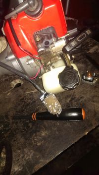

    Hello. The problem is that the trimmer does not fire on the old and new carburetor. I bought a new carburetor, spark plug and fuel filter cables. After injecting the fuel into the head and through the throttle, it fires for a while and it's ok. I pumped the fuel with a pump and poured back into the tank, but the fuel does not come out through the hole, from the cylinder side it is dry. Where is the problem?

    I've been sitting on it for 3 days and wondering where the problem is! I watched if there are cracks somewhere near the carburetor, but it's ok

    A neighbor told me that the problem may be in the absence of pressure or vacuum under the piston, which does not activate the diaphragm pumping fuel from the carburetor. Now the question is how do I check it? Should I dismantle the entire shaft, etc. and seal everything with silicone?

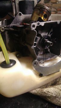

    The pressure must be checked, because the piston may be "worn". Check the condition of the piston and cylinder through the carburetor or muffler hole. Are the shaft seals ok because they can be the reason that the engine compartment is leaking and does not "draw in" fuel.

    So yes. I pulled out the cylinder to check the condition and it's ok, no scratches, discoloration, etc. I have all the gaskets, I added silicone gently to seal it thoroughly and it still did not help. The reason may be the engine compartment, which is not tight or shaft seals. And how to check it?

    I poured petrol from above into the engine compartment and in a few seconds everything spilled out of the glass by symering where the spike was. I read TC 12 22 7 16 on the simering. So I have to buy one or two simulations, they are the same on both sides?

    I bought a simering for PLN 9 I exchanged and scrap is like a dream.
