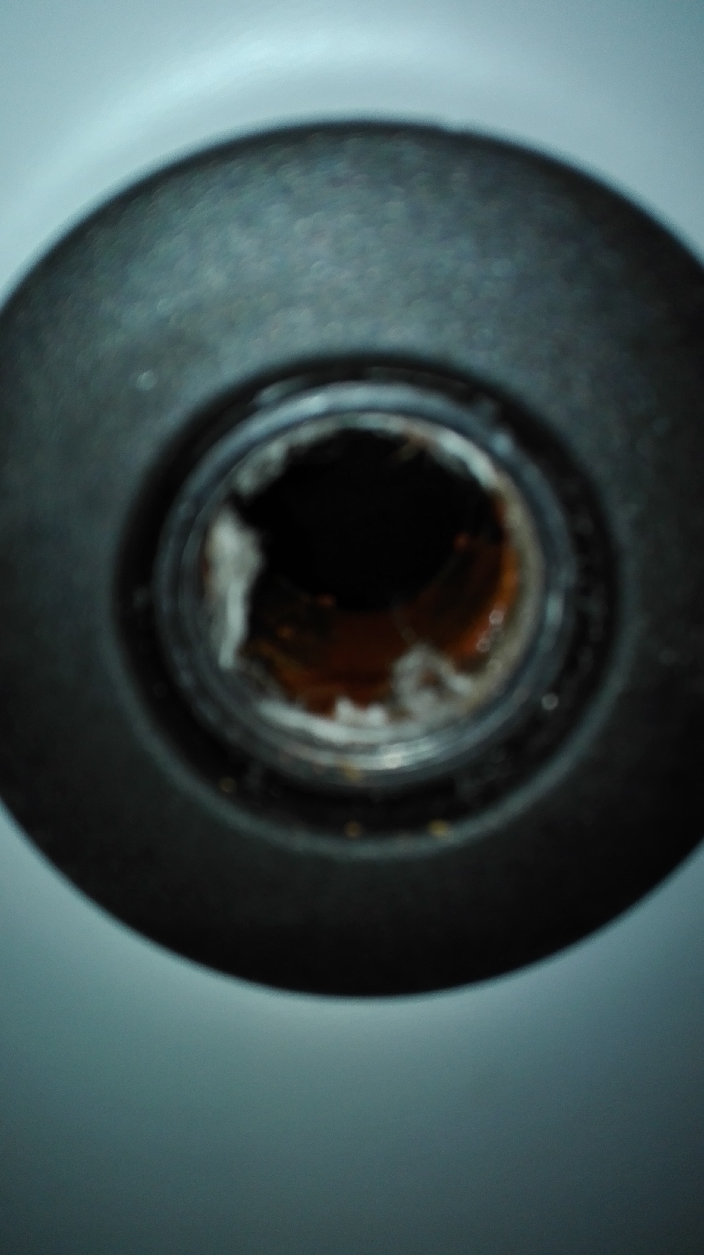

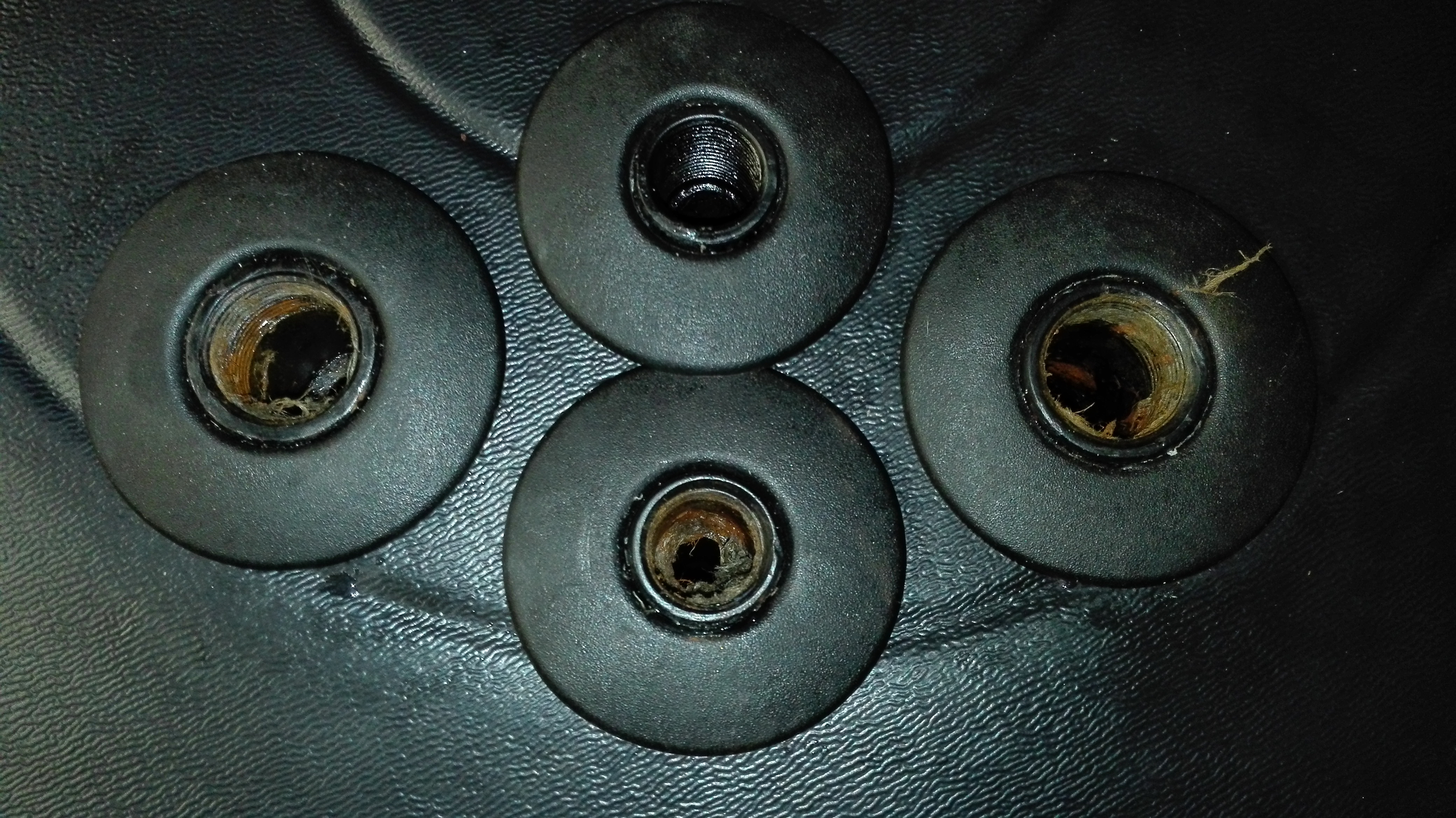

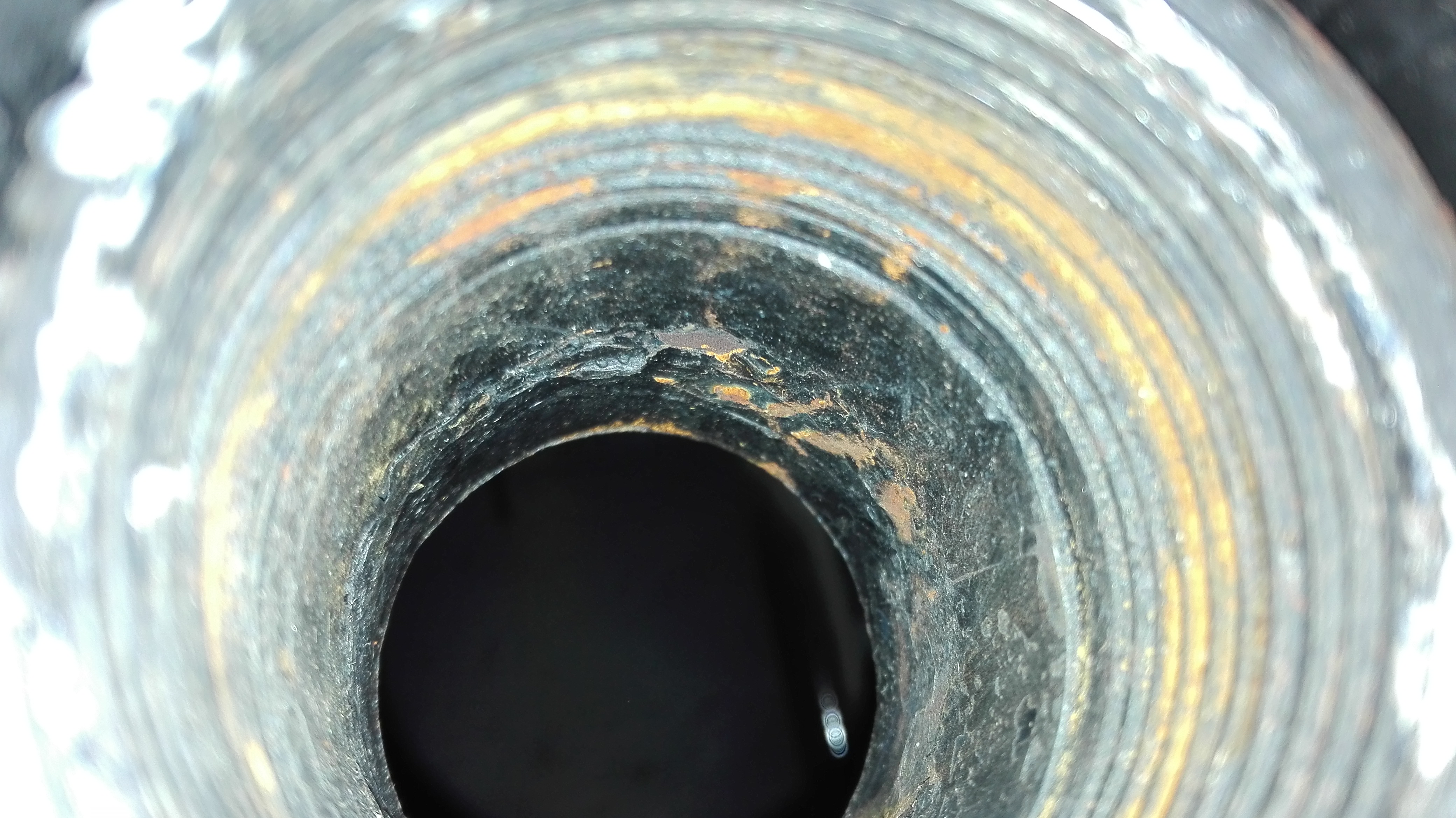

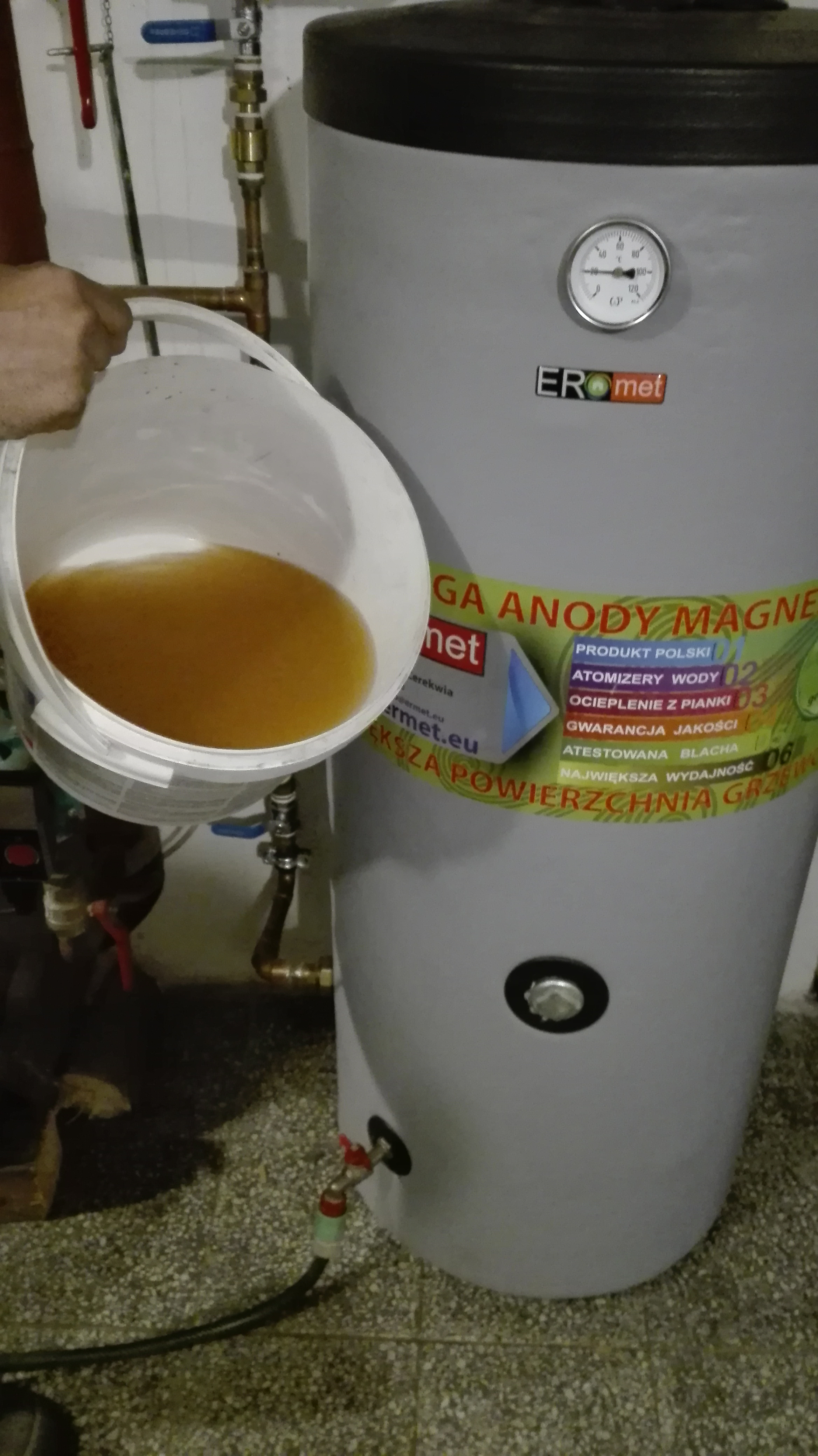

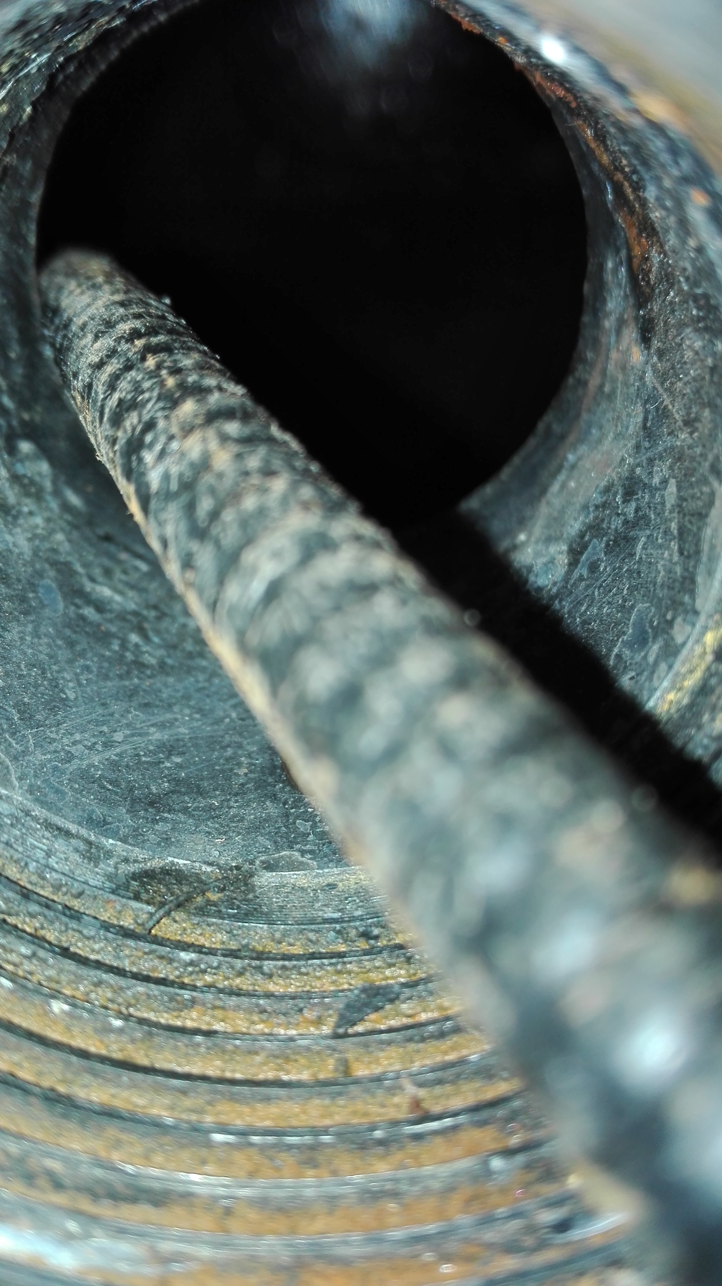

    Hello, I have the problem of yellow water after replacing the boiler with a stainless steel boiler. I had a webcam and looked inside, so the yellow water appears to be poorly coated with this food resin, as advertised by the manufacturer. The welds also rust and hence the yellow water. You probably will like me. So it remains to replace the boiler because it is a waste of installation and fittings. My adventure with Ermet ended with a happy recovery of cash for the boiler. I did not recover the losses for changing connections, renting a webcam, etc. I scared the head of ERMET that I would take the case to the consumer spokesman and he probably got scared. Let me remind you that my boiler was still under warranty. After the cash was recovered, no one asked for a faulty boiler and after another telephone intervention in ERMET, they ordered me to dispose of the boiler. Now I have a TERMICA boiler with a coil that I can recommend to everyone! Clean water heats up quickly as described by the manufacturer. I attach photos of the ERMET boiler!
    • Yellow Water in ERMET Boiler: 5-Year Performance, 120L Replacement, Warranty & Loss Concerns IMG_20171103_180705.jpg (3.64 MB) You must be logged in to download this attachment.
    • Yellow Water in ERMET Boiler: 5-Year Performance, 120L Replacement, Warranty & Loss Concerns IMG_20171103_174751.jpg (1.84 MB) You must be logged in to download this attachment.
    • Yellow Water in ERMET Boiler: 5-Year Performance, 120L Replacement, Warranty & Loss Concerns IMG_20171002_194431.jpg (2.61 MB) You must be logged in to download this attachment.
    • Yellow Water in ERMET Boiler: 5-Year Performance, 120L Replacement, Warranty & Loss Concerns IMG_20171002_203821.jpg (2.59 MB) You must be logged in to download this attachment.
    • Yellow Water in ERMET Boiler: 5-Year Performance, 120L Replacement, Warranty & Loss Concerns IMG_20171103_171447.jpg (2.18 MB) You must be logged in to download this attachment.
