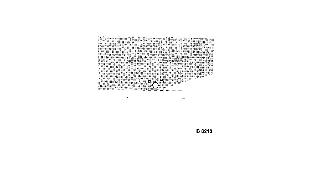

    First of all, thank you very much for your help, I was just looking for something like that.
    I just can't visualize it with:
    "The intersection must lie between the horizontal and the ascending part of the cut-off line (inflection point) on the vertical section through the central marking."
    Are there any illustrations?
    I'm asking about all this because I'm going to pull out the headlights to replace the filaments because one changes color.
    And as much as you can clean the lens and reflector.
    The height setting understood only the width so unbelievably

    This is the view you see in the light control device
