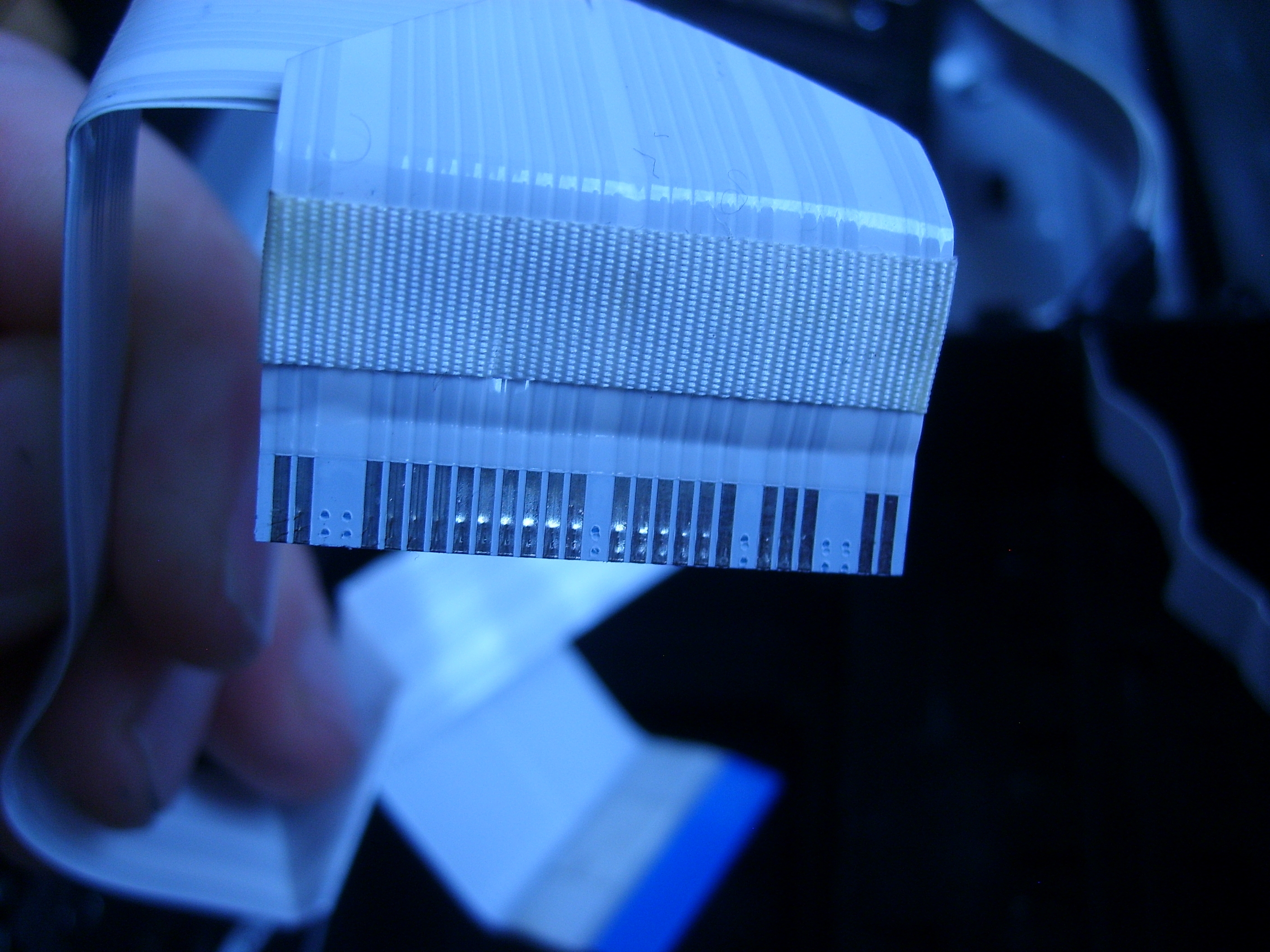

    Upload photos of the contacts on the ribbon and on the head.
  • #6 16797939
    zzbych1
    Posts: 146
    Rate: 15
    The contacts do not look bad, I think they are fine. I do not know if the pictures will be clearly seen.
    Epson XP-510 Printer: Solving Error Code 0x9A, Paper Jam, Carriage Issues, and Troubleshooting Epson XP-510 Printer: Solving Error Code 0x9A, Paper Jam, Carriage Issues, and Troubleshooting Epson XP-510 Printer: Solving Error Code 0x9A, Paper Jam, Carriage Issues, and Troubleshooting Epson XP-510 Printer: Solving Error Code 0x9A, Paper Jam, Carriage Issues, and Troubleshooting
  • #7 16798026
    pir0maniac
    Posts: 55
    Help: 7
    Rate: 30
    Then it's not as bad as I expected. You need to solder the fuse he was talking about fifek62 and it should work. Unfortunately, you have a lot of filming to do.
