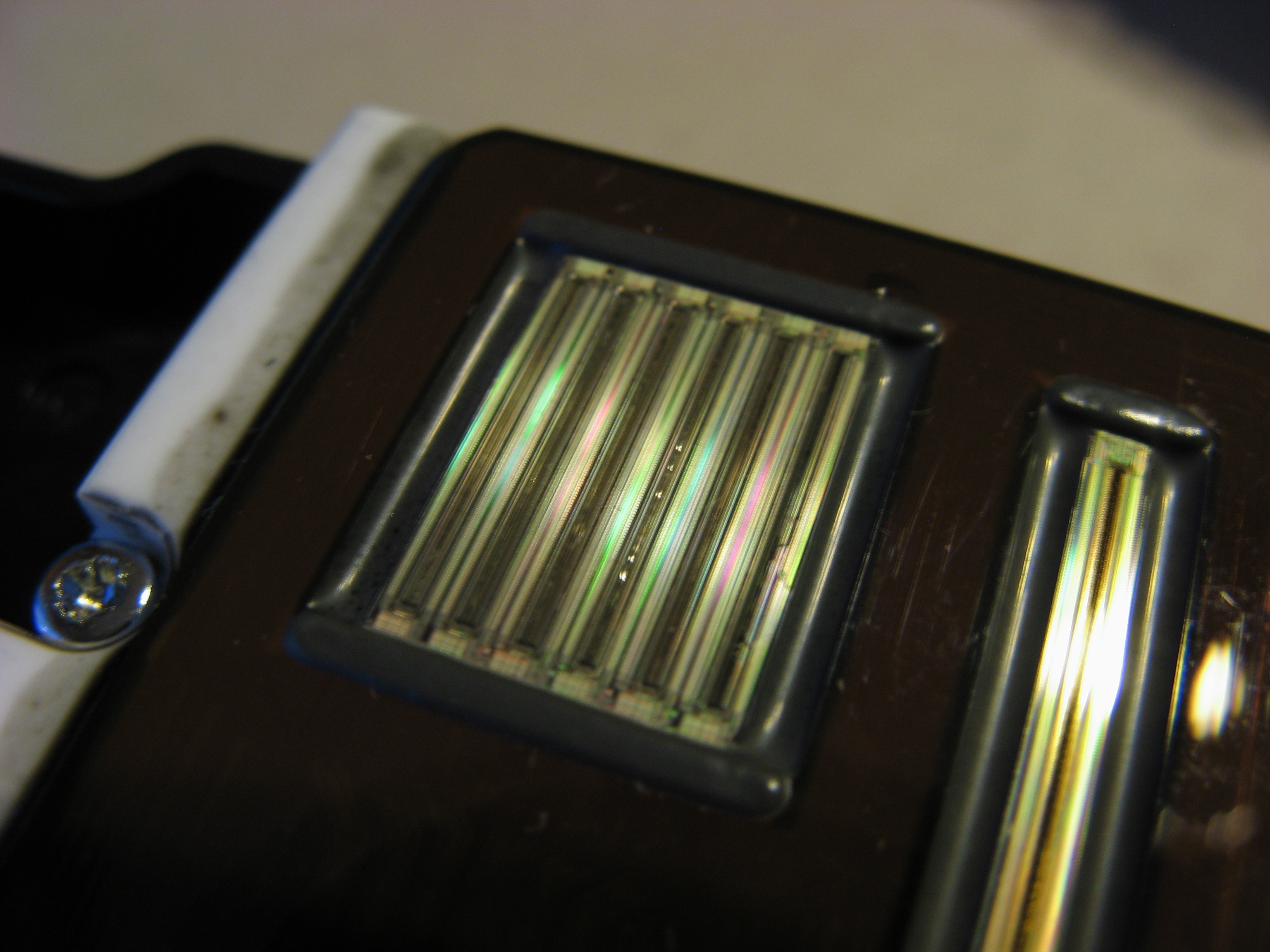

    I have just lost the head in the MP640 for the third time. Since I don't have the strength to invest in a Canon anymore, I bought a different printer and now I'm sitting and brutally taking the heads apart.
    With the damaged head, it is enough to cut the tape from the contact plate on the back of the basket and the printer starts normally.
    I put into the printer only the basket with the contact plate added - even without the porcelain with the heads, without the ink. The scanner is operating normally.
    Just trying to print gives the message U051 "Printhead is not installed. Please install printhead". and locks the printer, from which it only outputs OFF and then ON again.

    The very problem with the B200 is that it is irreversible. I invaded the warhead already written off.
    In the second head, also damaged, with the B200 error, I checked these cut-outs. In my case, covering the yellow frame made the head visible to the printer. Even carcasses and their levels are recognized.
    The only problem is that it prints me only blue and red, and in addition anyhow - the rest are probably clogged.
    So in my case, the non-invasive method did not give much more - the printer is not suitable for normal use anyway.

    I was also affected by the B200 error. On my head I noticed a little burchelek on the brown part with paths by the nozzles. In my case, pasting the yellow pins helped and I can still use the printer and scanner :) . The fact that the colors dispensed by these nozzles do not work for me, but I still have cheap printing with black ink.

    I read the thread and eureka! Works a little. Specifically: on Sunday I printed without a problem, today this error.
    I did, i.e. in response to the WSI Servants - No. 13.
    I sealed the top yellow field - the error kept appearing.
    I sealed the yellow, green and red fields (all top boxes) - the error disappears - the scanner works great, blank pages print.
    I sealed the top yellow and green fields - everything works. Ie printing only black. A nice PGBK grid on the control printout.
    I don't know how to check what about the color?
