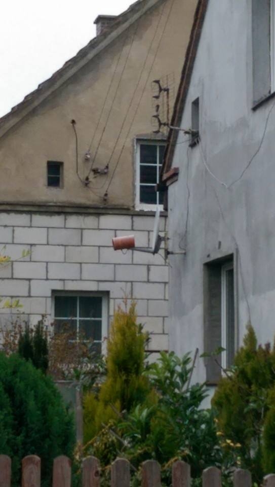

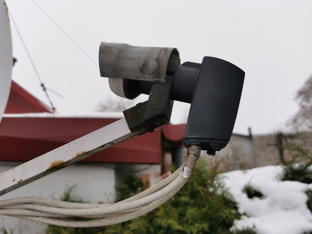

  • Sewer pipe cover to prevent snow buildup
    #16 21765747
    don_rikardo
    Posts: 88
    Rate: 38
    Hello everyone. A few days ago there was a rather heavy snowfall and a small "cap" stuck on the converter. Twice I ran with a brush to the converter to be able to watch programmes. After cleaning the programmes could be watched normally. I started to think how to eliminate this problem and came up with something like this.
    Satellite converter with a DIY snow shield made from a cut plastic pipe
    Now I am waiting for the snowfall and the effects of my simple action. And the cover , is a piece of sewer pipe cut lengthwise and cut at an angle for the canopy. We will see if I still run to clean the converter - I will write about the effects. Regards.
  • DIY converter cover to prevent snow buildup
    #17 21765904
    LeDy
    Posts: 19128
    Help: 1992
    Rate: 2942
    don_rikardo wrote:
    Hello everyone. A few days ago there was a rather heavy snowfall and a small "cap" stuck on the converter box. Twice I ran with a brush to the converter to be able to watch programmes. After cleaning the programmes could be watched normally. I started to think how to eliminate this problem and came up with something like this.
    You haven't discovered America, even less so in such an archived topic.
  • Snow cap may prevent converter blockage
    #18 21765937
    don_rikardo
    Posts: 88
    Rate: 38
    Did I say in any words that what I have done is a great success? Some people have written that such a cap on the converter is a mere bagatelle . And I simply think that snow will have a much harder time sticking the "cap" on the converter -- and that's it.
    Added after 1 [minute]:
    don_rikardo wrote:
    And have I expressed in any words that what I have done is a great success ???? Some people have written that such a cover on the converter is a mere bagatelle . And I simply think that snow will have a much harder time sticking a "cap" on the converter -- and that's it.
    Other than that the cost -- you could say --- none.
  • #19 21765954
    _kli_
    Posts: 5341
    Help: 762
    Rate: 1040
    don_rikardo wrote:
    I just think snow will have a much harder time sticking a "cap" on the converter
    On the converter, yes. But the wet snow also crudes the lower part of the canopy and can make quite a "mound" on the rectangular boom in front of the converter. You may have a little better luck, but against heavy snow and rain there is sometimes no simple protection.
  • Antenna still needs adjustment for low SNR
    #20 21766525
    don_rikardo
    Posts: 88
    Rate: 38
    You are somewhat right - but I have not yet had such a case that the snow which would accumulate on the extension arm in front of the converter would interfere with the work of the converter. After all, at a width of about 5 cm the height of this "mound" would have to be about 10 cm to reach the converter. Besides, I think that for such a "mound" to gather on the boom it would have to be windless. But I still have to adjust the antenna because I have signal strength and quality up to 70% and SNR is up to 12.7 dB, so a bit too low I think.
    We'll see after the snowfall and I hope that this canopy will do something.... Greetings to all and have a good Sunday.
  • Canopy may be blocking the antenna beam
    #21 21766678
    k_pec
    Posts: 1772
    Help: 271
    Rate: 562
    don_rikardo wrote:
    Otherwise I think it would have to be windless for such a "mound" to collect on the boom.
    With wet snowfall in temperatures around 0°C all sorts of weirdness settles in.... ;)
    don_rikardo wrote:
    But I still need to adjust my antenna because I have signal strength and quality up to 70% and SNR is up to 12.7 dB, so probably a bit too low.
    From the photo it's hard to judge conclusively, but I have the impression that this canopy could be obscuring the top part of the times. It could then take away some of the signal and introduce additional signal scatter at its edge worsening the quality / MER.
  • #22 21767734
    don_rikardo
    Posts: 88
    Rate: 38
    Thanks for the heads up - I'll try to establish something on this subject....

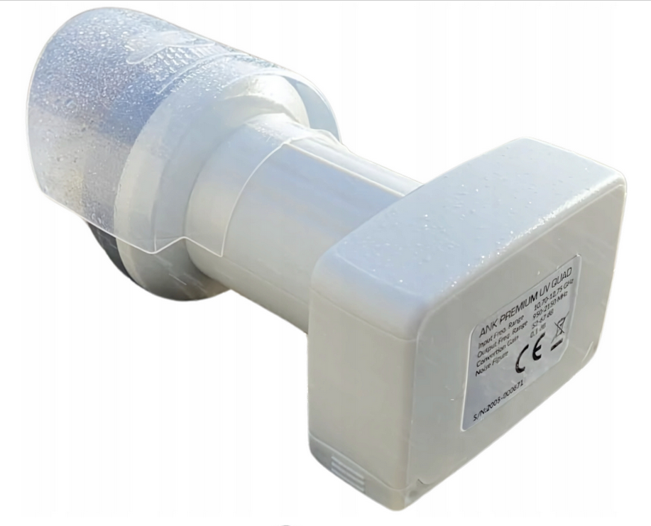

    AxelNext
    Posts: 4622
    Help: 265
    Rate: 454
    And why not.
    After several years, I decided to try such a cover in autumn and I can assure you that it does not deteriorate the quality of the signal, tested on %. During rain and snowfall I have no loss of signal, so I recommend it. The cost is negligible, and the results are there.
    Satellite LNB converter with a clear plastic cover and visible water droplets
  • Cover does not reduce signal quality in rain or snow
    #24 21814373
    LeDy
    Posts: 19128
    Help: 1992
    Rate: 2942
    AxelNext wrote:
    A se I will add why not.
    After several years I decided to try such a cover in autumn and I assure you that it does not deteriorate the quality of the signal, tested on %. During rain and snowfall I have no shortages or loss of signal, so I recommend it. The cost is negligible, and the results are there.
    What's in it for me after a year. When it snows it's the flying snowflakes that have an impact, not the ridiculous cover. It can only protect the converter from the snow sticking on it.
  • #25 21814391
    AxelNext
    Posts: 4622
    Help: 265
    Rate: 454
    LeDy wrote:
    It can only protect the converter from snow sticking on it.
    And that's the point. I don't have to fly around with a broom like last winter and before.
    I haven't noticed the negative effects of putting the cover on so why not.

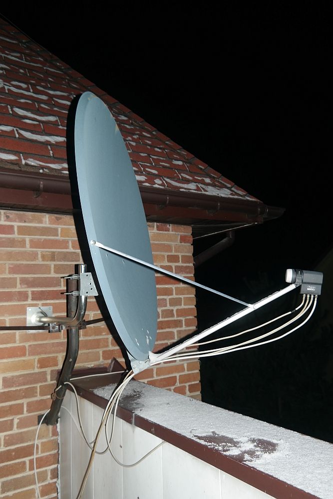

  • Cover prevents snow buildup on converter only
    #27 21817544
    collie2
    Posts: 931
    Help: 91
    Rate: 218
    AxelNext wrote:
    What is it about flying? You open the door to the balcony, wave the broom and you're done. And if you have an antenna by the chimney, in order not to fly with a broom to the roof, you immediately install an oversized antenna in plus, on which the snow on the converter does not make an impression. Anyway, whether it's rain or snow, it's always better to have an antenna too big than too small - size does matter. ;) I have a 110 cm antenna and holy hell with rain and snow. And covers for the converter.
    Large satellite dish mounted on a balcony next to a brick house wall in winter
