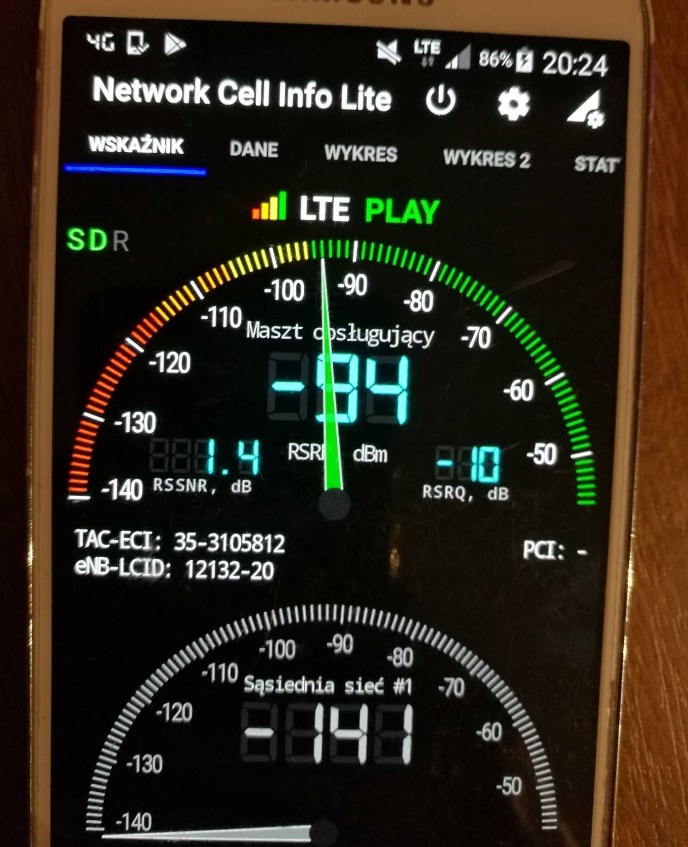

    Do a test on this web card on an LTE telephone with the Network Cell Info application, it will show BTS data and signal parameters. For this speed test, show the DATA tab and the speed test result. Test at home and outdoors. Play has around 3 BTSs with a set of permits for LTE2600, LTE2100, LTE800 and LTE80. They are at Mickiewicza 120, Morcinka 29 and Kosciuszko Hill 6. Play uses LTE-And so the purchase of a router with an obvious bandwidth aggregation. It can be B525 from T-Mobile.
    At home :
    Choosing LTE Home Internet: Sudecka 93, Jelenia Góra, 55m2 Apartment, Plus Transmitter & Router Choosing LTE Home Internet: Sudecka 93, Jelenia Góra, 55m2 Apartment, Plus Transmitter & Router Choosing LTE Home Internet: Sudecka 93, Jelenia Góra, 55m2 Apartment, Plus Transmitter & Router Choosing LTE Home Internet: Sudecka 93, Jelenia Góra, 55m2 Apartment, Plus Transmitter & Router Choosing LTE Home Internet: Sudecka 93, Jelenia Góra, 55m2 Apartment, Plus Transmitter & Router Choosing LTE Home Internet: Sudecka 93, Jelenia Góra, 55m2 Apartment, Plus Transmitter & Router
    Outside :

    No screen from NCI outside. in the house a sufficient signal on LTE800, but it's hard to say from which BTS. In JG they are unverified. Low speeds. Speedtest is good outside but we do not know in what band and with what signal parameters but it does not say LTE800. Show screen with DATA from NCI outside.
