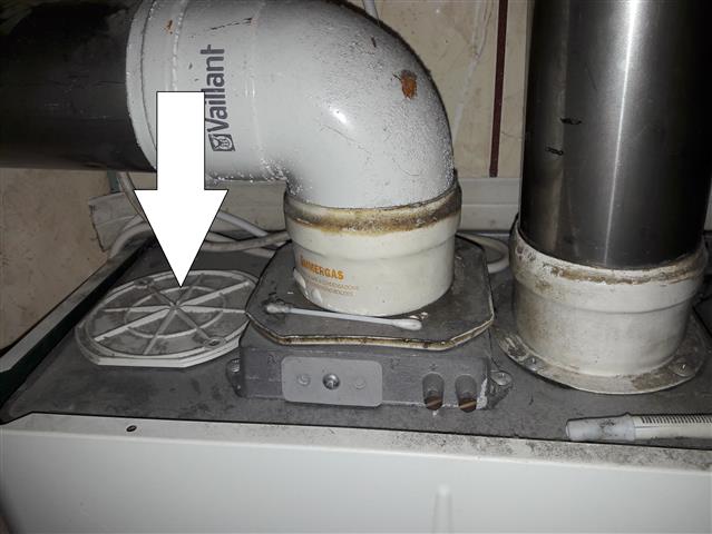

    Hello everyone in this forum, I am looking for the answer to my question.
    My furnace is EOLO Star 24 3 E, for some time error 11 (exhaust pressure switch) has been constantly popping up.
    At the top of the boiler there is a white lid visible in the picture and now when I unscrew it, the error is not shown to me, you can only hear it draws air and the stove works properly without any errors.
    Please tell me can this flip be open ?? The heating season is starting and I would not like to fly through this open flap. :cry: :cry:

    If you don't want to fly into the air, call someone who will repair the furnace and fix it for you.
    Not enough people have died from the silent killer called carbon monoxide.
    This cap should be screwed on. You can already guess that there is a lack of air in the room.
    All grilles work? Chimney sweep review was? If so, call an oven specialist.

    Thank you for the answer, you probably saved me, I closed the cap today and error 11 came back.
    The chimney sweep was and told me that I still have a grille, but I have to make holes in the door. I didn't cover the holes because it probably won't fix my oven.
    My stove is in a very small bathroom and is 5 years old and serviced.
    I read that there may be a blocked air intake or this prosestat is broken, can I do something myself today to fix it without calling for a gas supply ??

    Eolo is a boiler with a closed turbo chamber. The combustion air is drawn in from the outside by an air / flue pipe, so room ventilation has nothing to do with it.
    Check the flue pipe for any bird or other debris. Same with the air intake. and tightness of these wires.
    If everything is unobstructed, check the switching pressure of the pressure switch - I have never happened to fail in this model, but who knows?
    It happened that the fan motor lost its parameters and gave too low pressure, which resulted in the operation of the pressure switch.

    When was the last boiler inspection / cleaning?
    You may have a problem with the chimney, fan (lack of efficiency, dirty orifice), the last one can be a pressure switch.
    Maybe it will end up cleaning the fan itself, but if you have no experience in this, order it to the right person / company, especially since you will not write the protocol yourself, unless you have gas permissions?

    Gazownik said that the flue gas pressure switch was to be replaced, so I ordered it and I am waiting for it to be installed. I'll let you know if it helped

    Replacement of the exhaust pressure switch helped and the furnace runs without error 11
