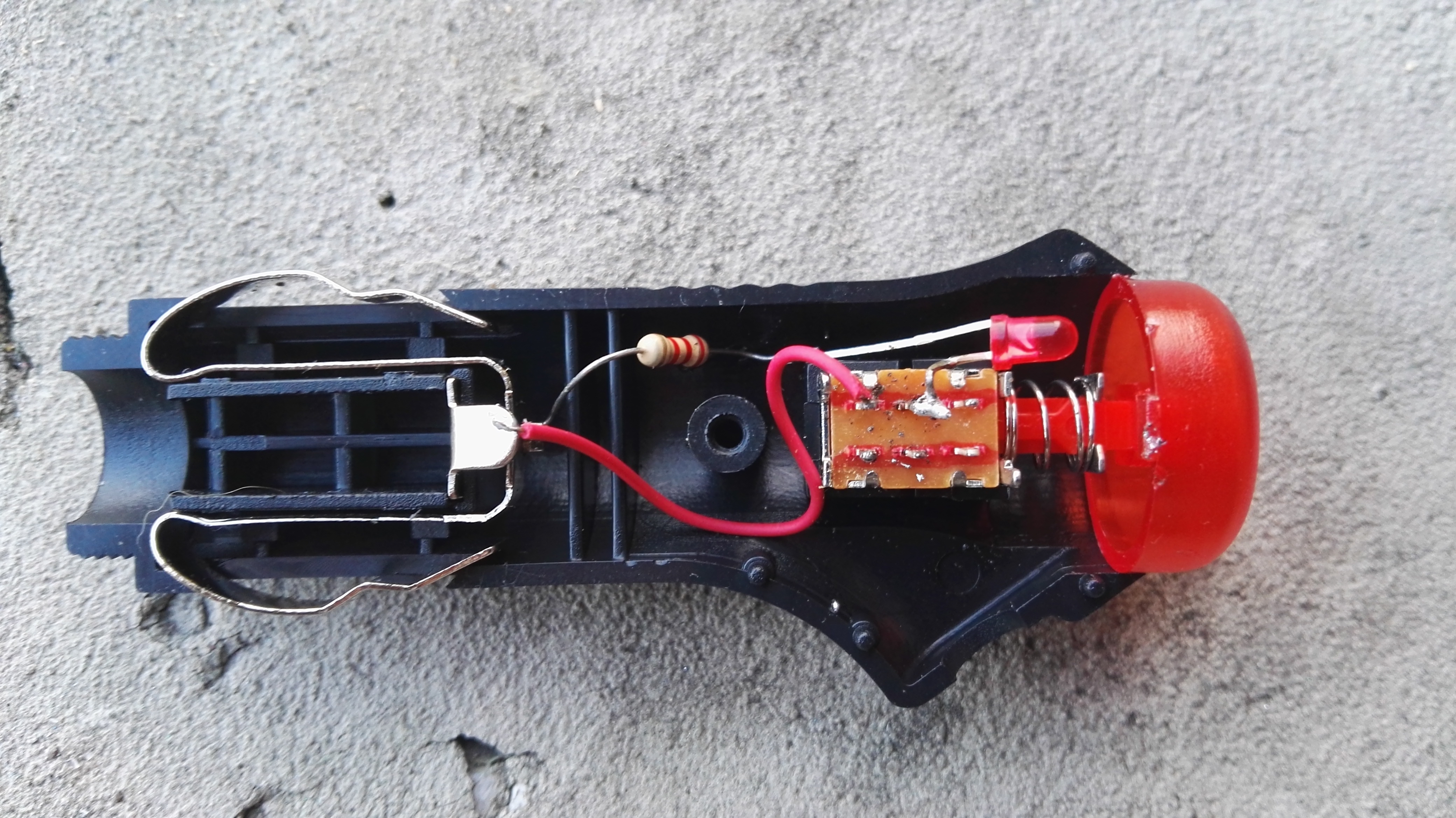

    Hello! I bought a plug for Allegro lighter socket on Allegro. It is with a button for switching on and off. How to connect cables to this? Connecting Cables to Allegro Lighter Socket Plug with On/Off Button
    Thank you in advance for every answer ;)

    One cable which will be (+), solder to the contact where the diode is soldered (you can pre-check if there is voltage on the middle terminal opposite diode). Conductor (-) you need to solder to the place where the resistor is soldered to this silver clamp.

    I'm not convinced about this "+"
    You have to check how the contacts are attached, but a colleague from the post one above is probably right.

    Let the author of the post check it out.
