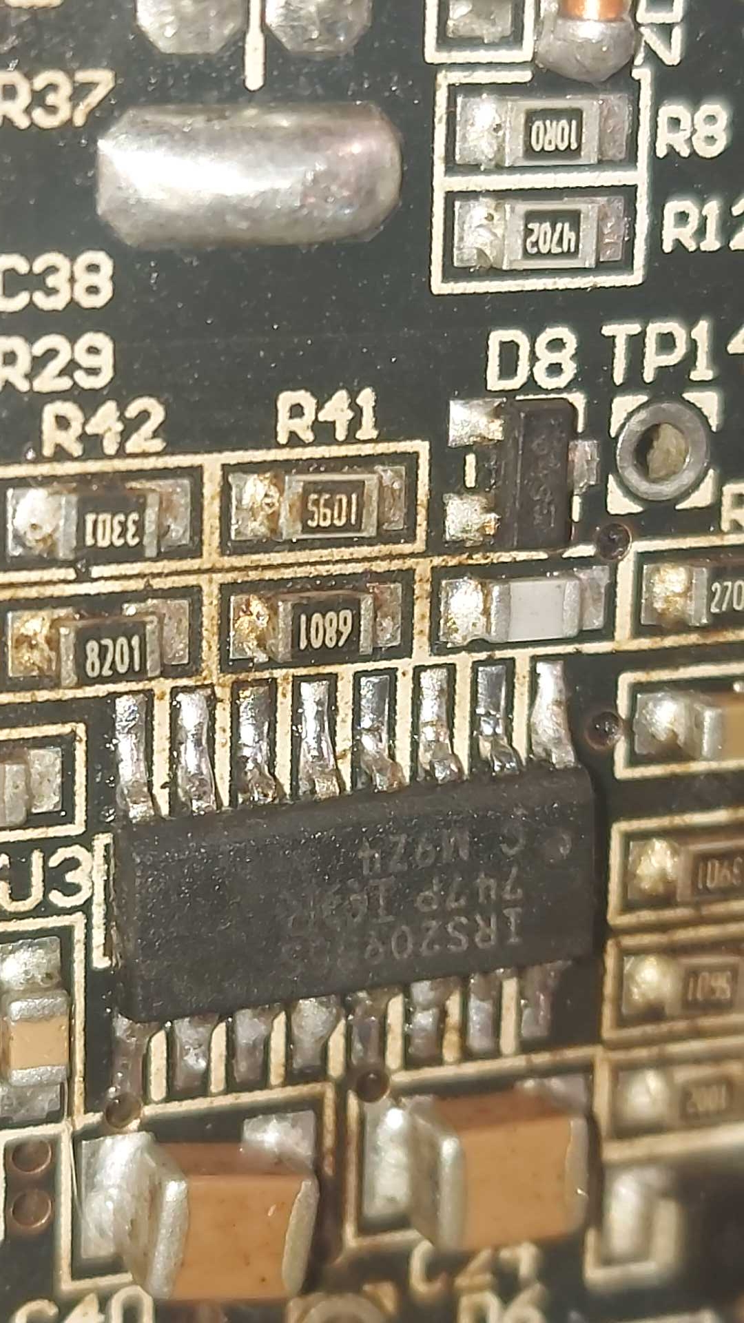

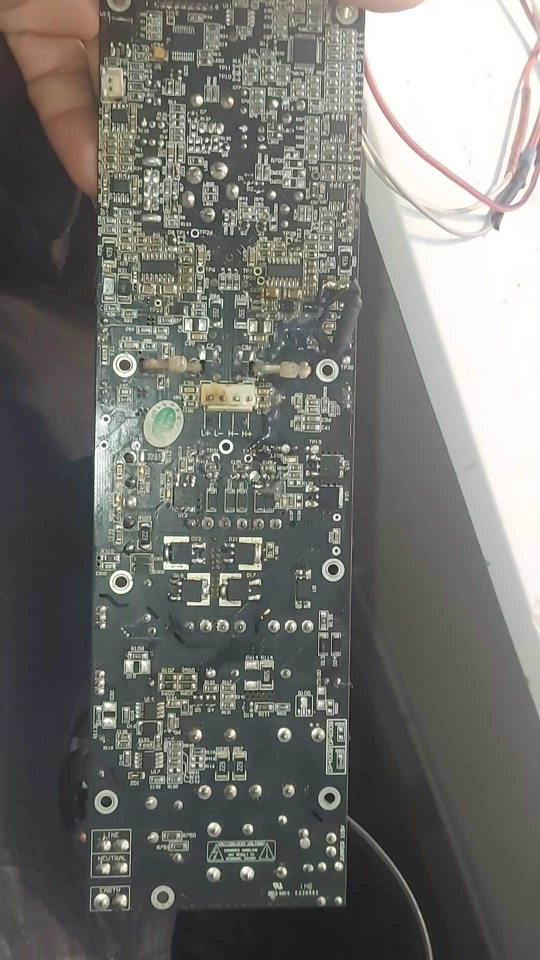

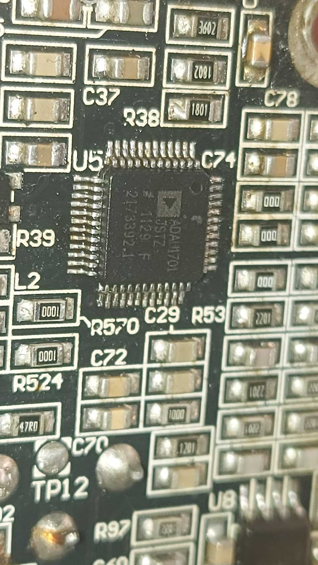

    HI
    rcf art 415a protected.
    The green and red lights are bright together. Gate pin in Mosfets are not enabled through IRS20955s...There is 12 volts in irs . The. It's a problem with the IRS or ADAU1701?

    Amingpx wrote:
    Green and red lights are bright together.
    This indicates damage to the final stage. The problem may be in the half-bridge transistors themselves, but also in some break in the output circuit itself, damaged RC elements there, or incorrect power supply.
    Amingpx wrote:
    about problem with IRS or ADAU1701?
    Unless nothing has been done before, ADAU1701 is the last element that can be suspected.
    Amingpx wrote:
    IRS20955s... Wirs is 12 volts.
    This is not enough, you need to check at least, for starters: Vdd pin 1, Vss pin4, Vcc pin 11, Vs pin13, Vb pin 15.

  • #3 20350129
    Amingpx
    Irs20955s
    Pin 11( vcc) = 47v
    Pin 4 = Vss =directly connected to ground =0v
    Pin 1 = vdd = 10v
    Pin 15 vb = 14v
    Pin 13 vs =2.9v
    Meanwhile I changed adau1701 but the problem was not resolved

    Which LEDs are lit? The ones on the power supply or on the panel next to the potentiometer?
    What is the gate voltage of q2 and q3? They are controlled by adau, high state (3.3V) is IRS shutdown.
    What is the voltage on pin2 IRS? This pin is crucial, it must have a voltage almost the same as on pin2, i.e. about 10V. This is an open collector pin, if it is attached outside the system, the IRS will not rise.
    What voltage on pin9 IRS? On pin11 there should be voltage from pin9 + 12V.
