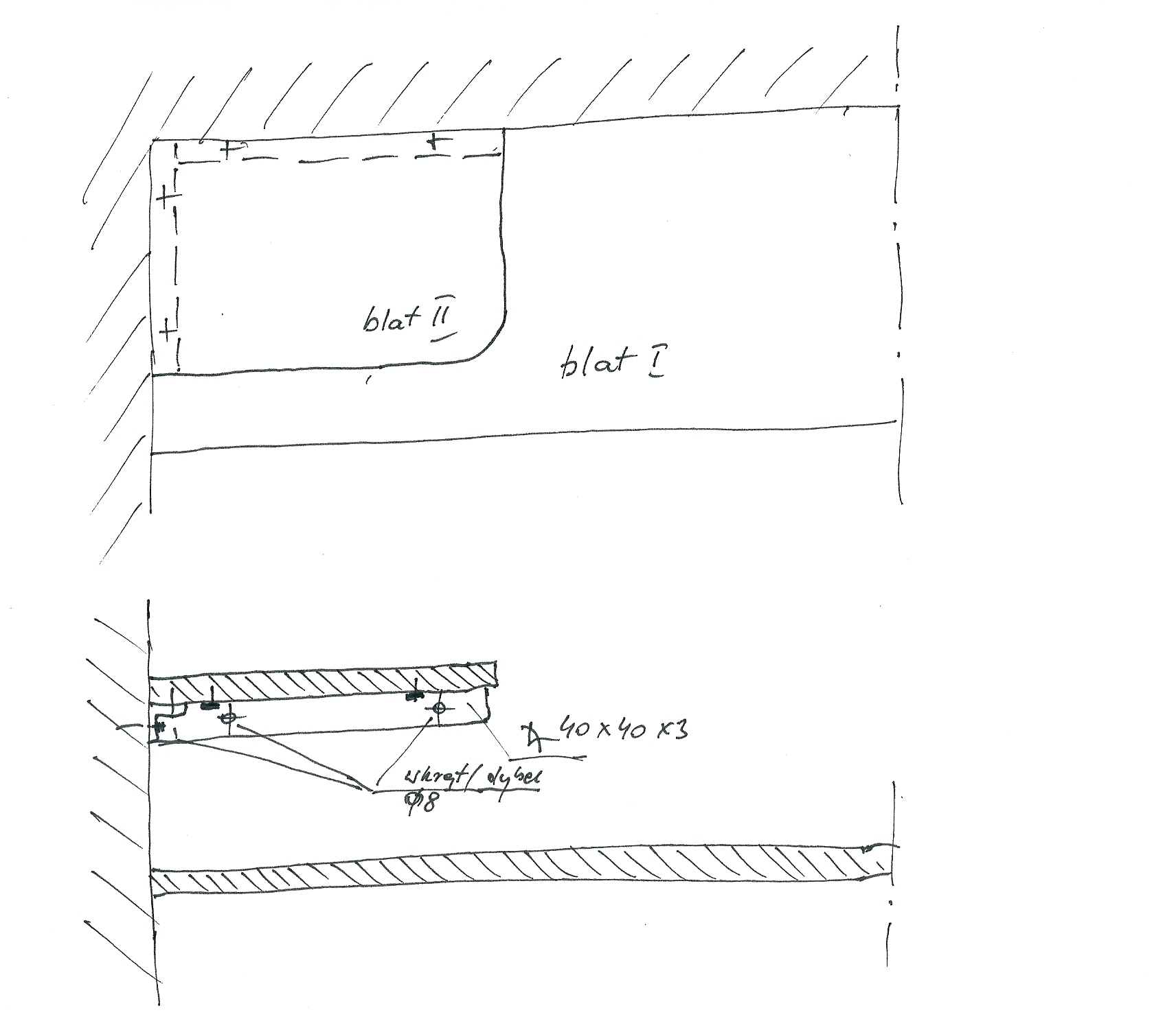

    I have a small kitchen and little countertop. After assembling the furniture, I had a counter top 1 meter. I would like to make it a "piece" 30cm x 100cm and hang it a little higher in the corner above the "normal" top - in this way I will gain some space. Blacik will stick in one part above the floor, but I would like to avoid a long leg down as a support. can I hang it securely and securely on the brackets? The thickness of the top is about 3.5 cm - a 60x100 piece is quite heavy .... but I need half ;)
    Thanks

    Concrete and it's probably ok, because when we drill, nothing flies through (on the second wall when drilling, rubble falls into the room ;) ).

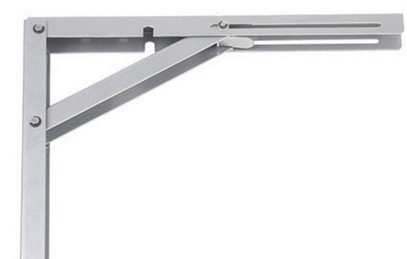

    If the wall is strong, i.e. hard material and will hold the dowel / dowel well, you can hang on such holders. Remember that each handle has its own strength. It is possible to fold the regiment when it is not needed Mounting Secure 30x100cm Kitchen Countertop on Wall: Tips for Gaining Space Without Support Leg
