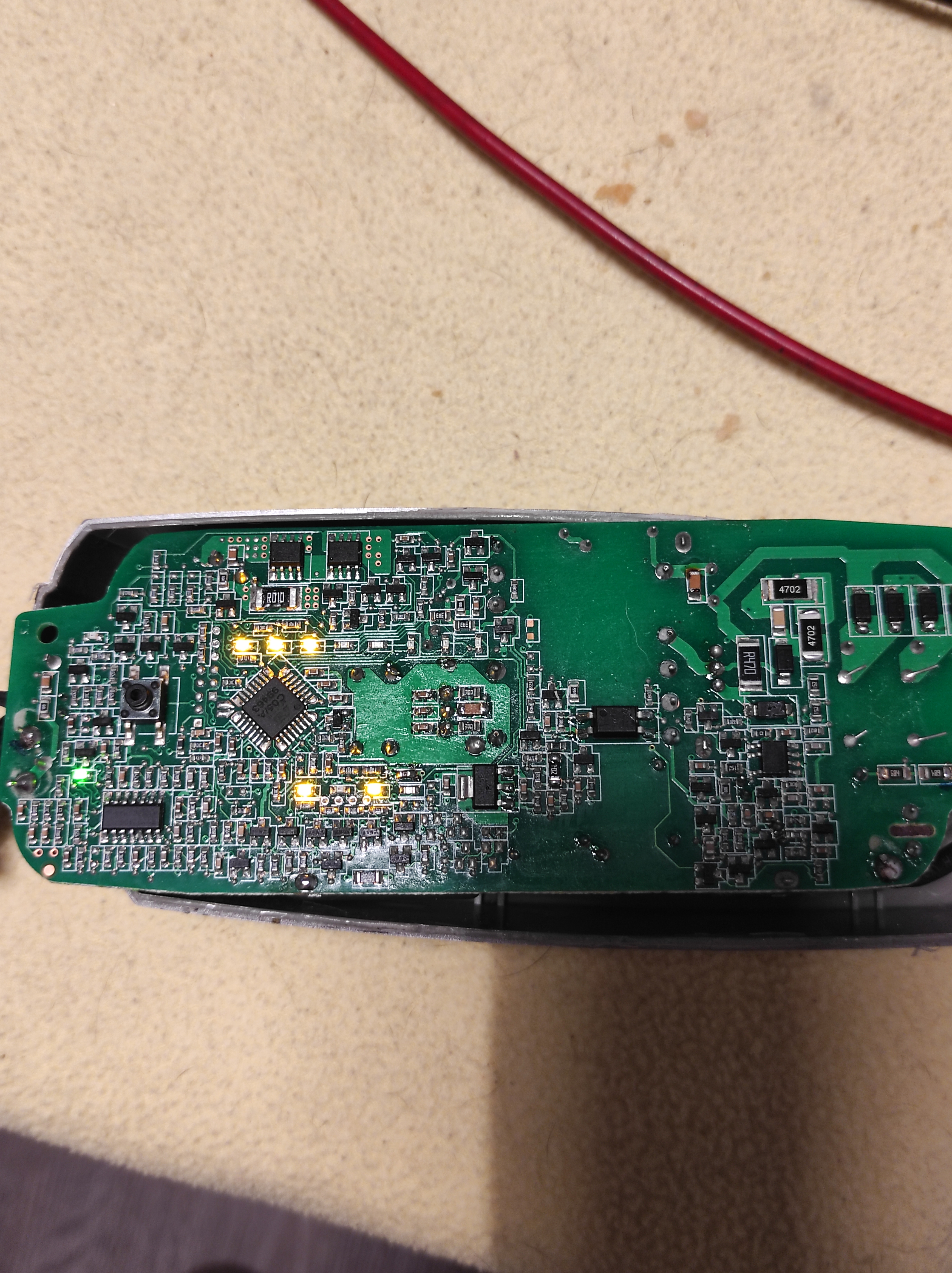

    I have the same in my rectifier, it also stops on the 4th program and that's it. Aku AGM motorcycle. Has anyone encountered such a problem?

    I disconnected, reconnected and it went through all the steps.

    How long does it "stand"? Once I also thought that something was wrong (an ordinary acid battery, a bit worn out), but it took a few (maybe even a dozen, because I forgot about it) hours and moved on to 7 ...

    For me, I tried to change with the Mode button, the LEDs suddenly start to go crazy. And you can hear converters. And when I remove the plug and put it back in, it will click and work properly, but only up to 4 LEDs and the inverter cannot be heard.
    • Battery charger Ctek mxs 5.0 or maybe mxs 5.0 Polar Edytion ?? 1646507459691.jpg (5.49 MB) You must be logged in to download this attachment.
