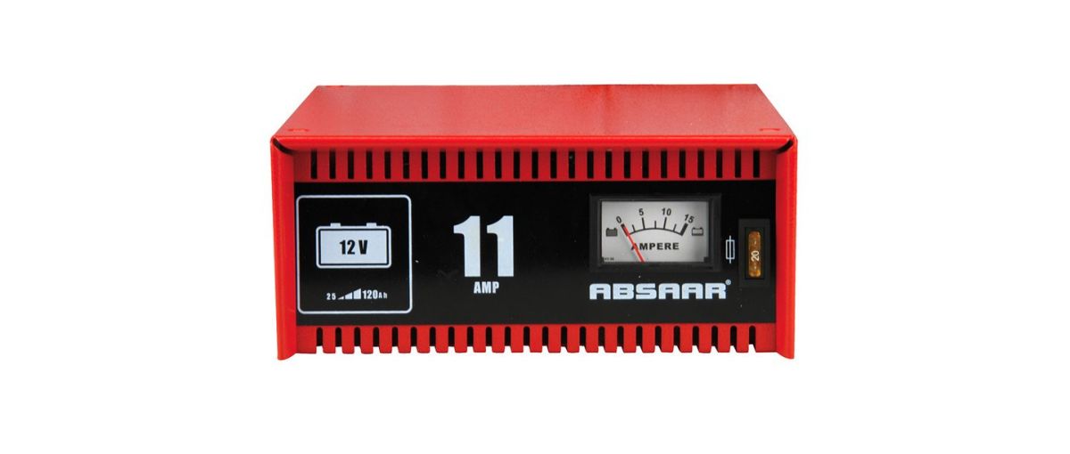

    Today I noticed such a rectifier in a certain supermarket.
    Best Non-Microprocessor Chargers for Christmas Gift: Top Simple & DIY Repairable Models
    11A rectifier from the German brand Absaar. Ideal for charging 12 V lead-acid batteries from 25 Ah to 120 Ah.
    The charger is very easy to use and safe for the battery.
    A durable metal housing protects the charger against mechanical damage.
    The output current is very stable. It has protection against overcharging and overvoltage.
    Input voltage: AC 220V - 240V / 50Hz.
    Current (output): 11 A maximum
    Charger weight approx. 3.3 kg

    It is a pity that I do not have the one I opened - because I would take photos of "guts" and ... I suspect that it is similar.
    What I remember:
    The transformer - by the eye (but copper though) will not pull 10A for a long time
    Bridge - some Chinese KBPC 50A riveted through the aluminum plate to the rear panel.
    Thyristor - 10A
    And crazy :D regulation system on 3 transistors, I think.
    It actually works, but ... with my hand on my heart, I would not give it to my son as a gift.
    For my own - I did it myself.
    The fact that I had the opportunity to make the enclosures in an aesthetic way, but that's a different story.

Can a PLN 150 model fully charge a deeply-discharged 120 Ah battery?
Yes, if it reaches at least 11 A and over 16 V in the finishing phase. The supermarket Absaar does so, though gassing begins above 16 V [Elektroda, adse, post #18363868]

Is the Absaar 11 A internally robust?
Mixed. It uses a copper transformer and 50 A bridge but only a 10 A thyristor; sustained 10 A may overheat [Elektroda, remot, post #18317594]
Do low-cost chargers really “make density”?
Some do. Absaar rises above 16 V on low current and completes charge [Elektroda, adse, post #18363868] Over-voltage accelerates active-mass loss—up to 20 % capacity drop in lab tests [Johnson, 2021].
