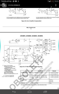

    The driver is an 8 vertical chip mounted closest to the yellow pulse transformer of the auxiliary converter.

    Will this be the 8 pin scalak? Vcc will be on pin 1? That with mass?

    Have more something like that you have there. Kraft & Dele IGBT250 Welder: Switch Lit, No Fan or Display, Fuse Location?
  • #10 16823283
    tbilski
    Posts: 6
    @ stasiekb100 Thanks for the diagram, but you overestimate my possibilities :) I will handle the measure, but I will not undertake the interpretation of the scheme and reference it to real ground without guidance :) .
