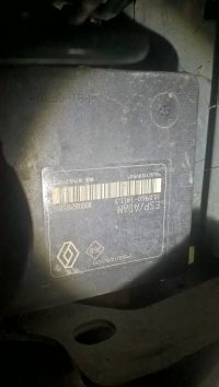

    Hello!
    The theme is the Ate abs pump controller from Renault Laguna 2, the exact C10C3 error. I dismantled this driver and after undressing I do not visually detect any damage. out of curiosity, I read the memory of 25l040. My question is whether someone is able to say something about this topic or is there a chance to resuscitate this driver? Something bad with info on the forum about this ailment :|
    Added after 13 [minutes]:
    In addition, photos and load in the attachment
    Renault Laguna II - ABS Ate Driver: Analyzing C10C3 Error and Possible Repair Options Renault Laguna II - ABS Ate Driver: Analyzing C10C3 Error and Possible Repair Options Renault Laguna II - ABS Ate Driver: Analyzing C10C3 Error and Possible Repair Options
    • lagunaII_ATE_25c040.bin (512 KB) You must be logged in to download this attachment.

    After checking the motor, everything ok ... the motor works is elegant in the middle, and after connecting to the controller in the output to the 5W light bulb and connecting the CDiF-a mistake is the same. Before disassembling the ABS pump, I connected the CDiF and went over to check the parameters and all OK, the sensors from the wheels read, the acceleration sensor works and the turn too. I suspect that the driver replacement will remain :cry: I found the same numbers for all ... oh, only the question still remains whether the problem is in memory or something else ...
