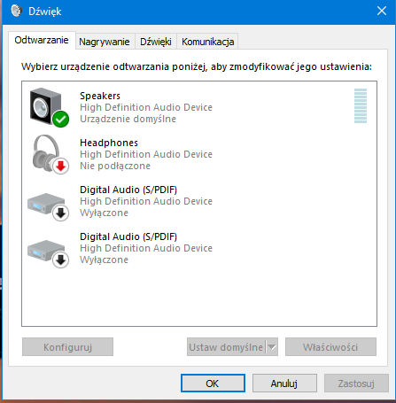

    #3 16391207
    LIVELOAD
    Posts: 9
    Hello, the sound card is a regular card built into the disc, I have no idea how to do it any more, the problem is that I do not have SPDIF connectors for the graphics card so I would connect it to the disc. There is nowhere to even buy it. In the attachments I send additional information because I personally have finished the ideas.
    Ps. Even if I turn these two off devices as default, the bars are green and 'jump' but the TV's sound is missing.
    • How to make the image go through the HDMI cable and the sound through the jack o Zrzut ekranu (73).png (32.87 KB) You must be logged in to download this attachment.
  • #4 16391238
    rtj71
    IT specialist
    Posts: 4983
    Help: 474
    Rate: 353
    This screenshot is made when you have HDMI connected?

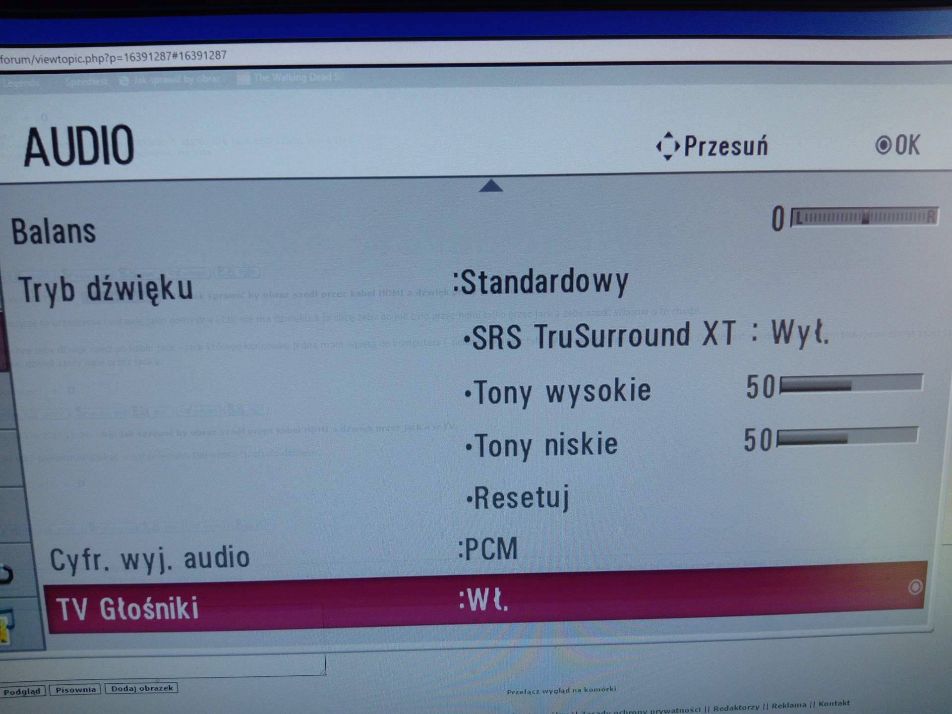

  • Select the TV’s sound source in settings
    #6 16391302
    Kasek21
    Posts: 45661
    Help: 4981
    Rate: 3548
    You should look for such an option in the TV settings, i.e. the sound source.

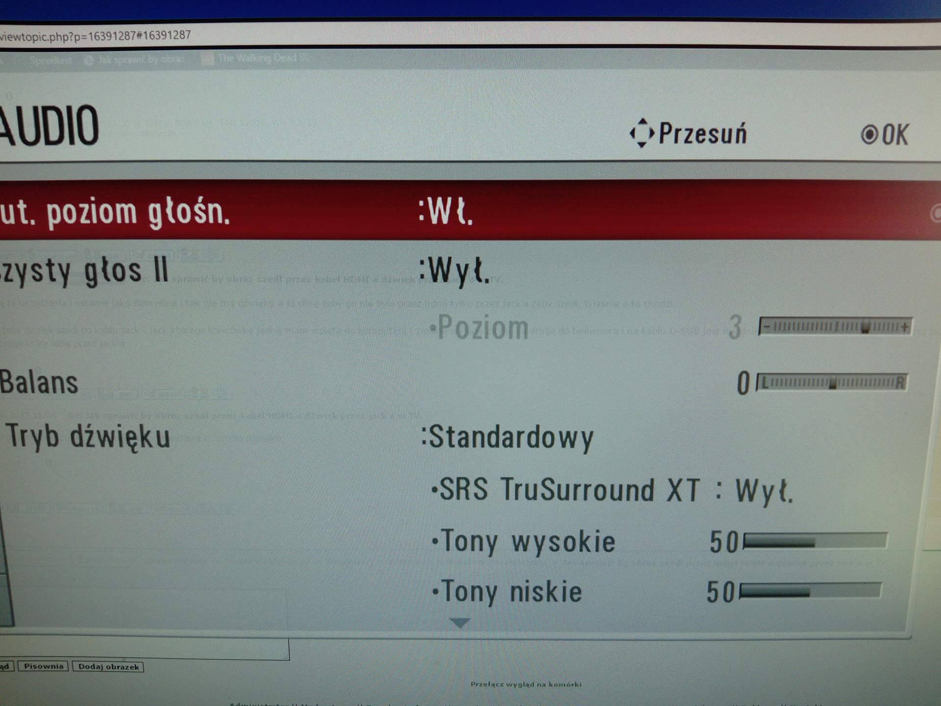

  • #7 16391308
    LIVELOAD
    Posts: 9
    In the TV settings I found only something like that.
    • How to make the image go through the HDMI cable and the sound through the jack o 17778932_747877295375072_1642701983_o.jpg (232.46 KB) You must be logged in to download this attachment.
    • How to make the image go through the HDMI cable and the sound through the jack o 17778783_747877272041741_1720642892_o.jpg (194.59 KB) You must be logged in to download this attachment.
