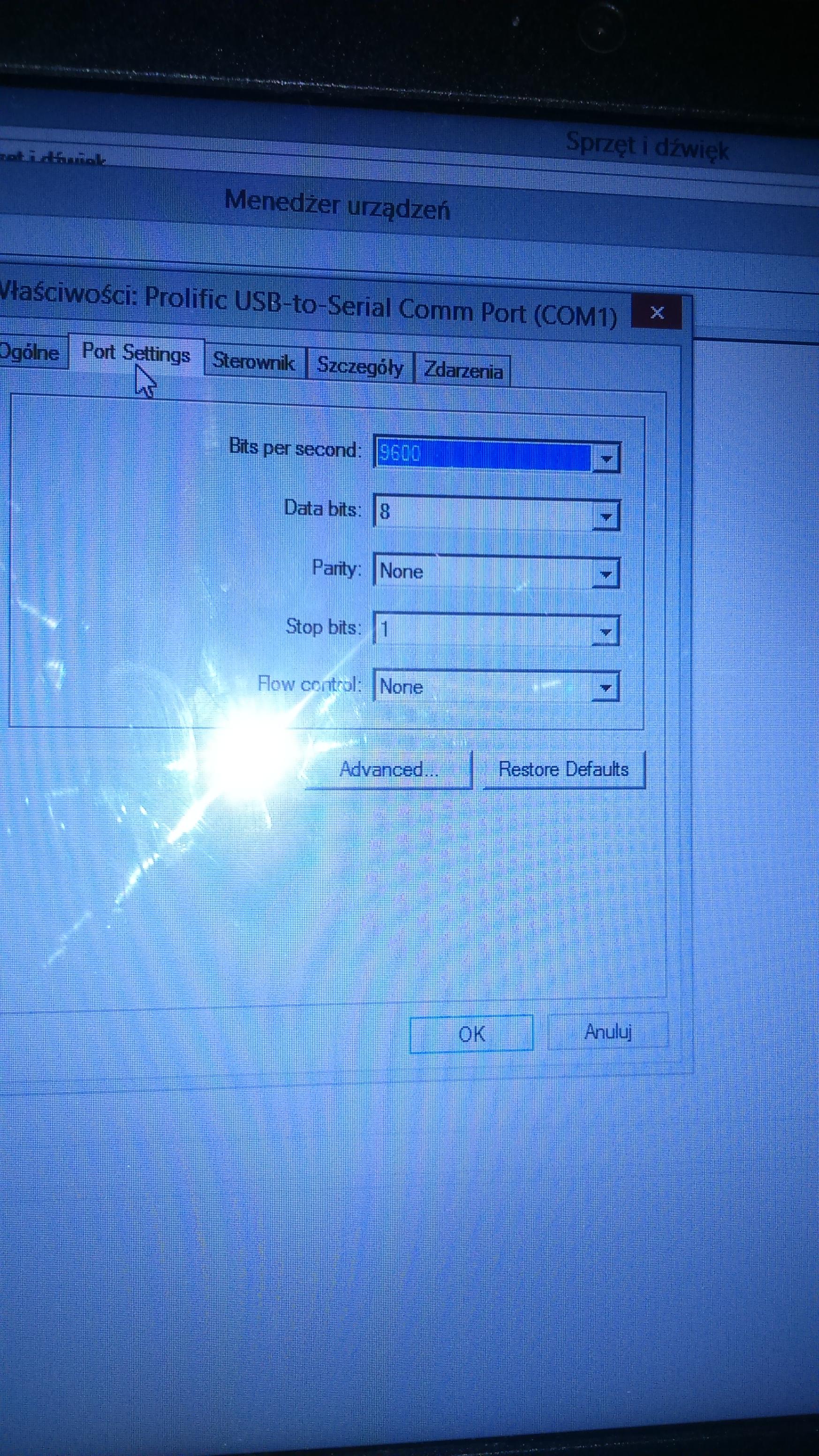

    ] Is the interface correctly recognized in the device manager? Regarding the port itself, do you have the settings as in the picture?

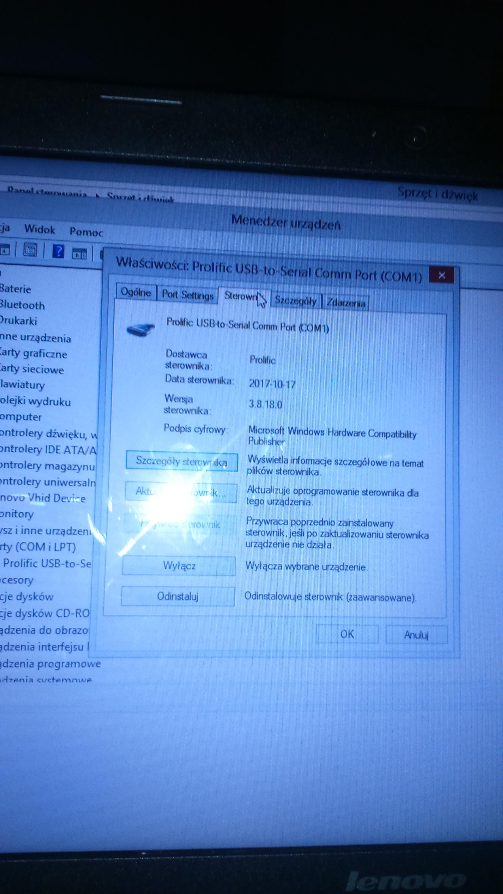

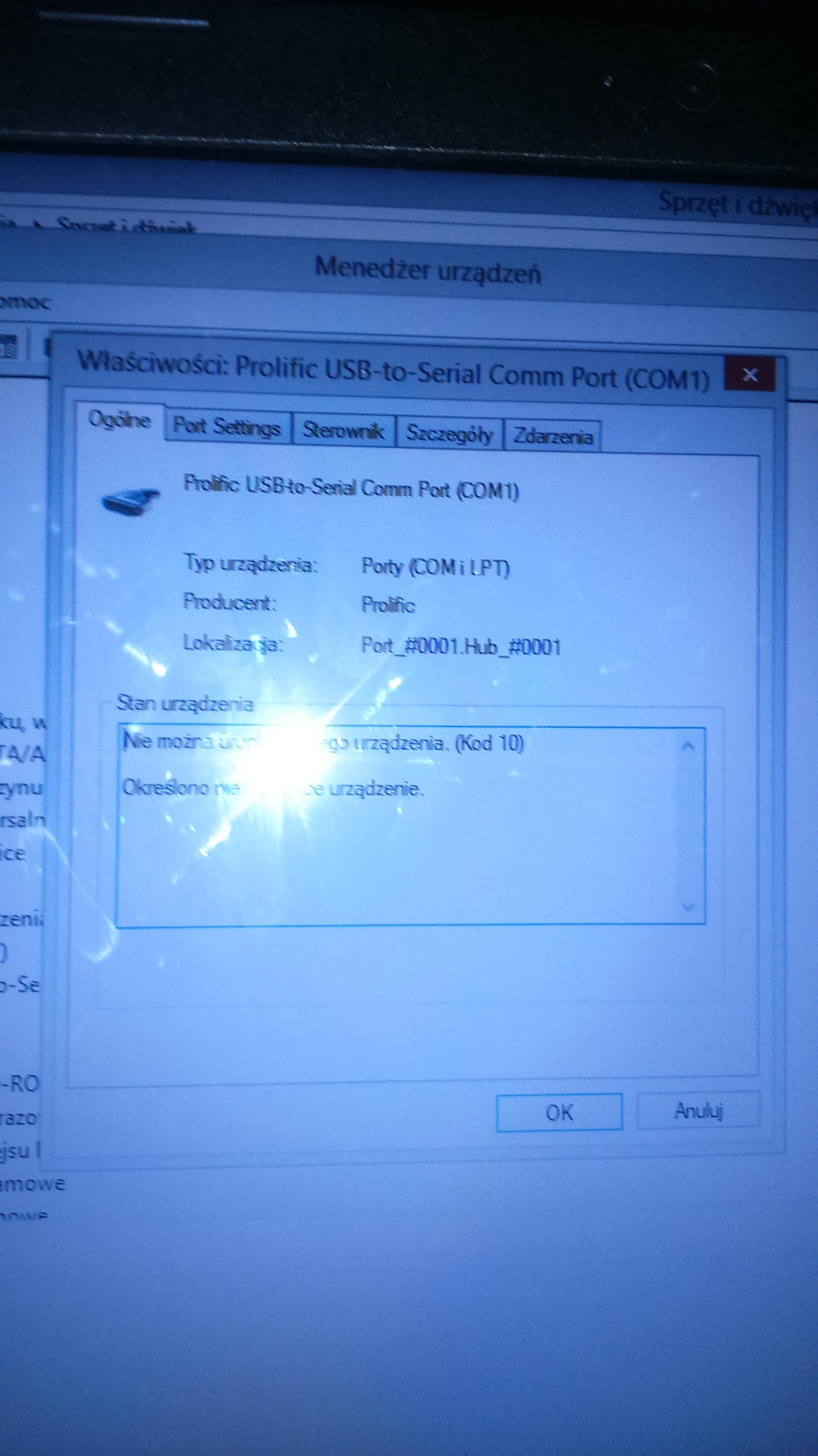

    Tell me if the computer sees the cable you have connected or insert screenshots from the device manager and port settings.

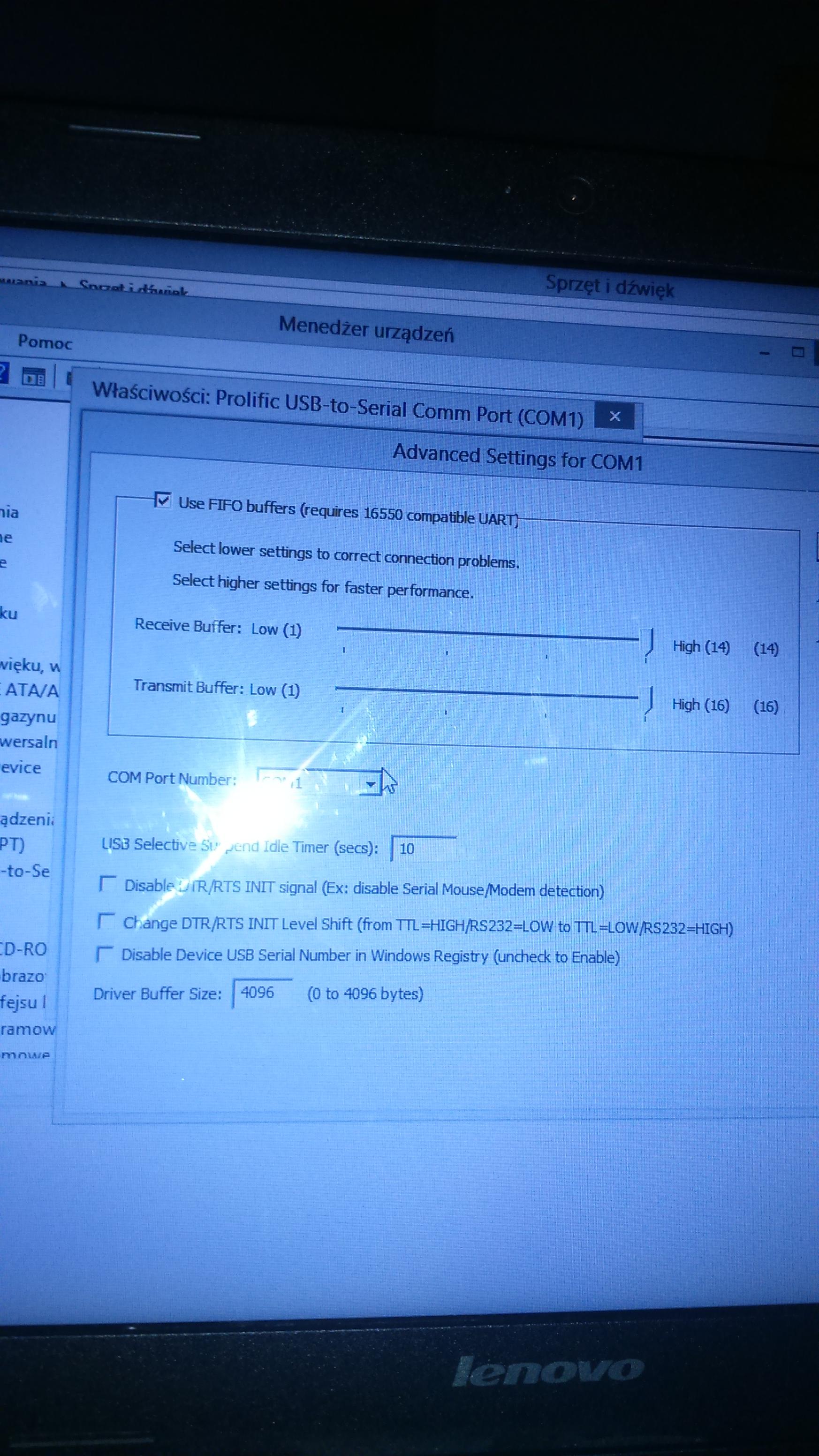

    In the attachments photos of my device manager

  • #10 16820130
    kkknc
    Posts: 23768
    Help: 1915
    Rate: 6709
    Code 10 with an explanation and a yellow exclamation mark. So what do you want to connect to when you don't have a com port?
  • #11 16820268
    mariusz999
    Posts: 178
    Help: 25
    Rate: 42
    Unfortunately, in this case you will not connect. Uninstall the driver and reinstall it, remember to use the same port every time. Do not change the socket to which you once connected the diagnostic interface.
    T you have a program to check the chip and driver. All new and should help. After successful installation like in the manager you will see that everything is fine you can set the port properties. This should solve the problem.
