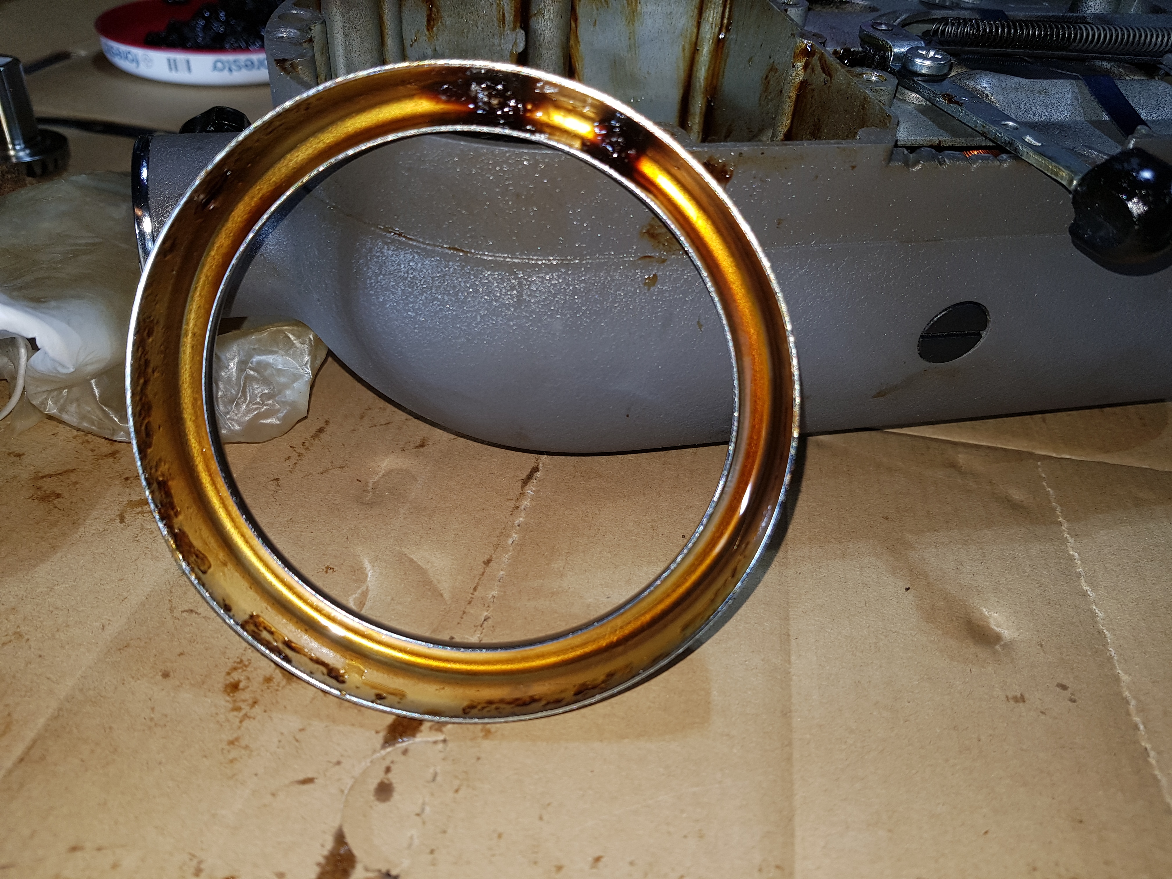

    I noticed on my KitchenAid 5KSM150 Planetary Mixer that grease was leaking from underneath the swivel where a stick or whisk is attached
    KitchenAid 5KSM150 300W - What lubricant for the planetary gear?
    I called KitchenAid Polska asking if I should be afraid and what is the reason, what sealants will be needed. I got a reply to send the device by courier and it will be repaired because the parts do not sell :(

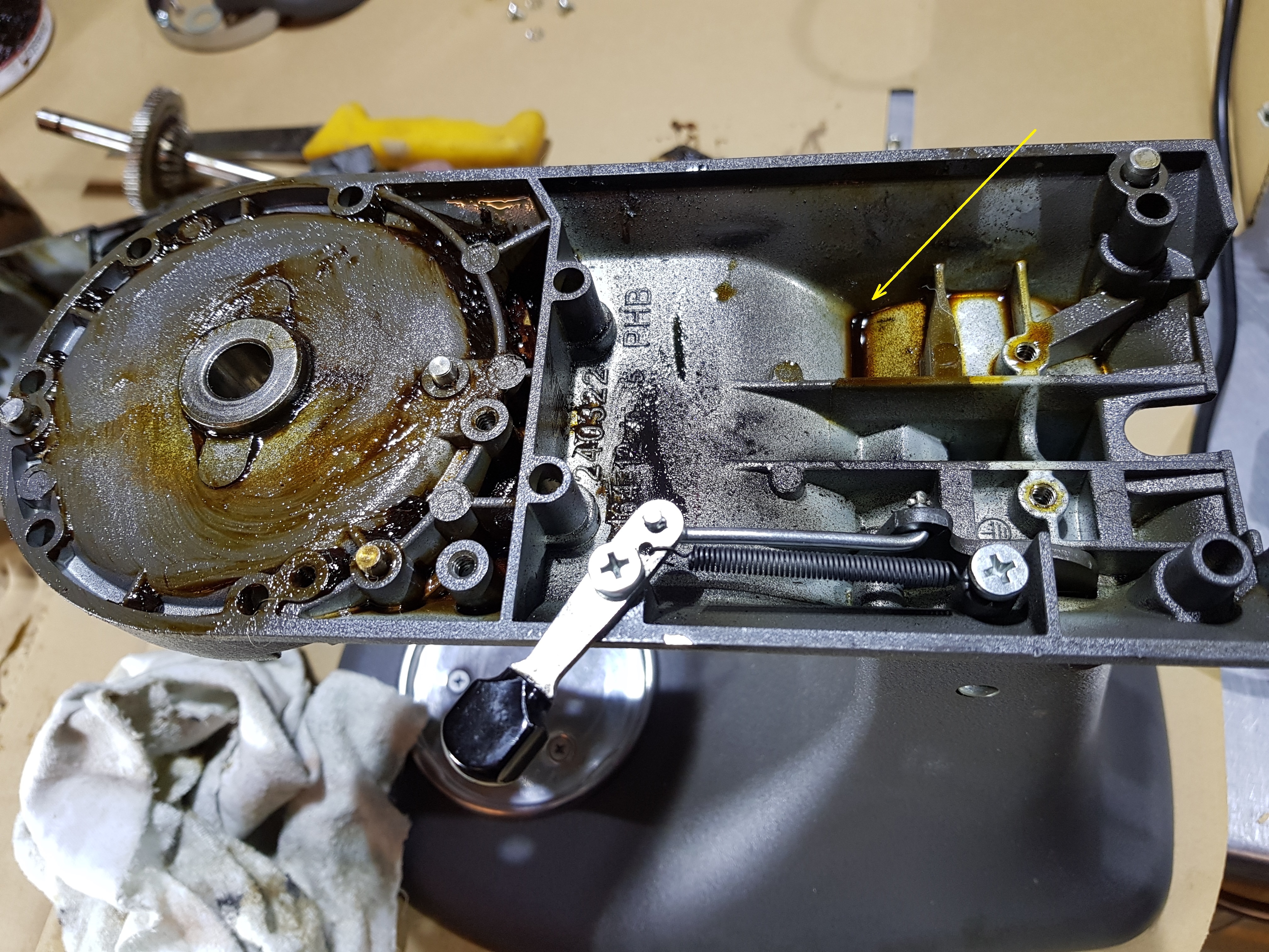

    I decided to look inside and fix the fault myself. I was the first to take off the band and here I noticed something like oil, in contact with the consistency of grease
    I purged the grease from the planetary gear chamber
    I cleaned the grease residue with gasoline and dried it. It turned out that the leakage appeared not only from the axis driving the tools, but also on the motor axis and then on the commutator, to the bottom of the housing. I cleaned everything. I verified the parts. OKAY.
    KitchenAid 5KSM150 300W - What lubricant for the planetary gear? .
    And here the question arises as to which lubricant to apply. It was originally dense brown in color.
    ... not available on the Polish market. I found out on Vivamix that they use some white food grease, I think Shell Barina or something. Will it not come out? The worst for the commutator.
    I wonder why the grease partially delaminated into oil and traveled through the axes to the outside. Not by excessive play. Has the grease gotten old?

    I was doing it too, the grease started to break down and leak out. I fixed on the same gaskets.
    The commutator must be dry, no gram of grease is allowed.
    The same lubricant he used was Orlen's "Gear Lubricant". It works for about two years, it doesn't leak, it doesn't smell. It is quieter than the original.

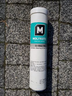

    I am still thinking about:
    - Molykote(R) G-4500
    - MOLYKOTE(R) G-1502 FM SYNTHETIC BEARING & GEAR GREASE
    - Food grade solid lubricant NSF H1 400g Berner

    Michał used Orlen's gear lubricant and he runs for two years.
    After much thought, I used MOLYKOTE(R) G-1502 FM SYNTHETIC BEARING & GEAR GREASE. Why this one? Adapted, among others for planetary gears, to work with plastic / metal gears and approved for use in the food industry.
    I do not close the topic. Someone else write down what lubrication they have applied.

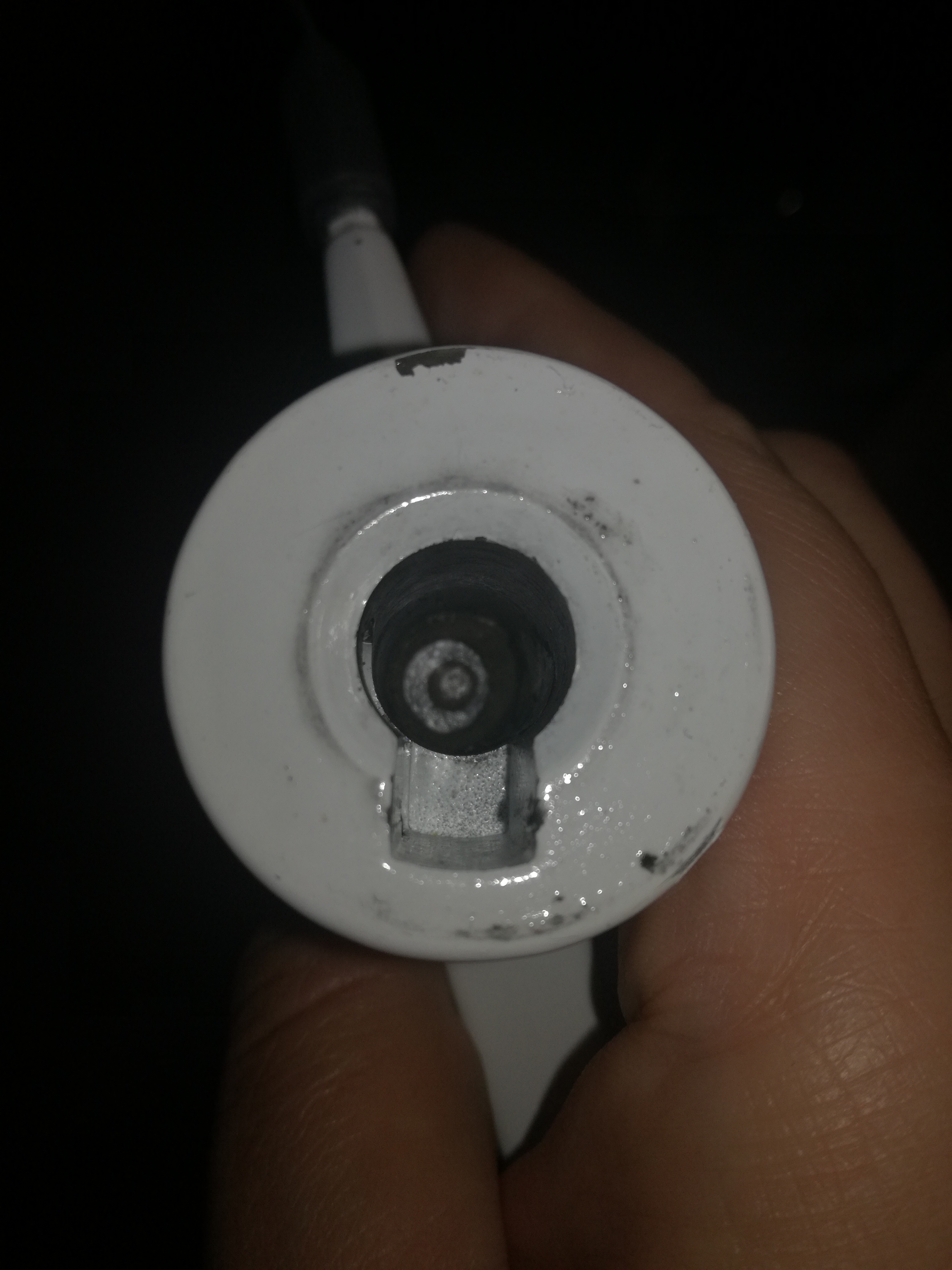

    Hello, I'm hooking up to the topic, the woman washed the ends that are used for mixing in the dishwasher, it probably rinsed out the grease and when you put it on, you can't take it off, it's blocked, do you think this grease will be ok? https://allegro.pl/smar-do-maszyn-do-lodow-sp...?reco_id=f75490cc-e8bc-11e8-8830-000af7f5fff0
    It's not a lack of lubricant, it's corrosion. The tips are not lubricated. But they are made of aluminum, and some salt-water tablets destroy them.
    Examine the surfaces in the center of the tip carefully to make sure it is smooth and straight.

    It looks simple inside, but I don't really know how to check if it is smooth. Only one tip causes such problems, i.e. the one for shortcrust dough, the whisk and the hook go in and out without any problems (the whisk was also washed in the dishwasher). I have no idea what is wrong anymore.
