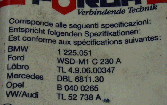

  • #10 2802611
    rasty
    Posts: 734
    Help: 126
    Rate: 23
    Maybe you can find signs such as photo second.
    Equivalents of different companies.
