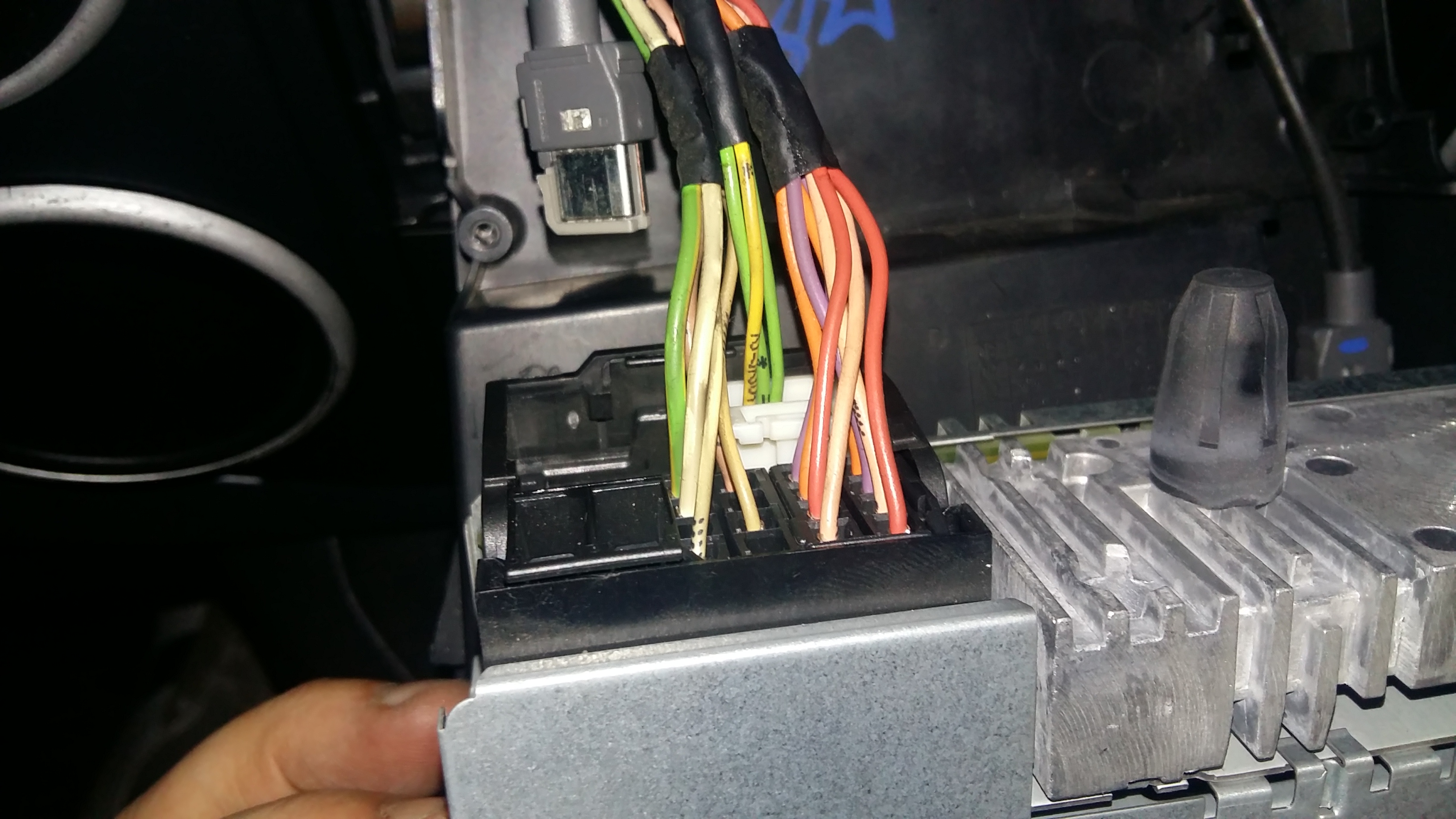

    Hello colleagues. I have a factory radio RD4 RN1 with bluetooth auto Berlingo III 2009. I bought a pocket, a factory shelf under the radio with USB AUX and I have a problem with the connection. There is such a gray plug there. Does anyone have any schematic? I suspect that in section C of the radio cube some contacts are responsible for AUX on the cable, but after activating Lexia, I would like to use USB.

    What you bought is not for this radio.
    The cable fits RT6 (RNEG2) - you don't have this radio.
    Berlingo III (2009) - Connecting USB AUX to Factory Radio RD4 RN1: Wiring Schematic Needed
    As far as I am concerned, the RD4 only uses AUX, no USB.

    This is true. 12 pin aux cube

    The case was handled by replacing the RD45 model with this socket for a radio and there is an option for mp3 with a flash drive and an additional AUX input on a 3.5mm jack :) The topic is closed :)
