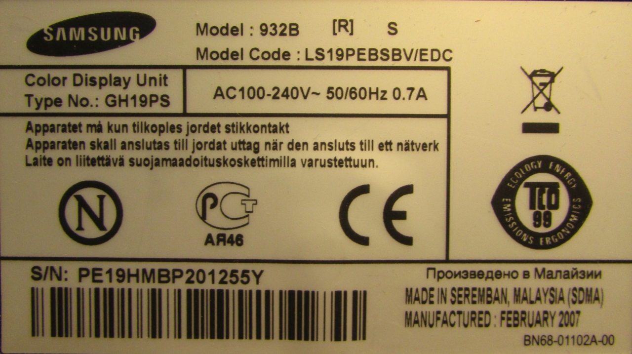

    Left monitor plate:

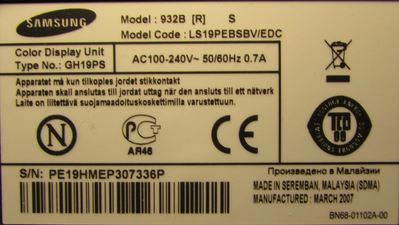

    Right monitor plate:

  • #16 16849951
    safbot1st
    Posts: 21951
    Help: 2719
    Rate: 1585
    Certainly, the production dates differ. S / N also totally different, but that won't say anything.

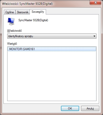

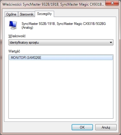

    Below are the hardware IDs for both monitors:
    Two Identical 19 Samsung Monitors - Color Difference on VGA & DVI from MSI Motherboard Two Identical 19 Samsung Monitors - Color Difference on VGA & DVI from MSI Motherboard

    It's about VEN, and here's the code, and DEV, and here's the full code - like here
    https://www.elektroda.pl/rtvforum/topic1228905.html
    There is still something wrong, not to mention the inability to enter the OSD in one of the monitors.
    I still think that these devices are not identical.

    In that case, I dare to say, based on the hardware ID, that these are 2 different monitors, hence the color discrepancy.
