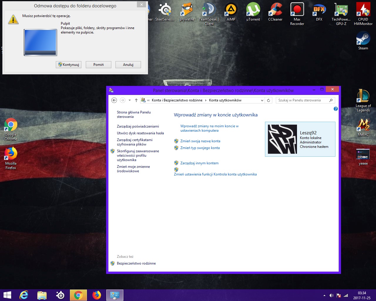

    Hello, I have a problem for some time I can not create a new folder on the desktop, unfortunately I have no idea what's going on. I will add that in other folders and on other disk partitions I can do a new folder in the same way on the system partition.

    • Can't Create New Folder on Desktop: MSI GT610, Asus M5A78L, Windows 8.1 Pro, 8GB DDR3 RAM problem.jpg (278.8 KB) You must be logged in to download this attachment.
  • #2 16847336
    DriverMSG
    Posts: 44094
    Help: 3984
    Rate: 4887
    Check if you have rights to the "desktop" folder. If not, give yourself ownership.

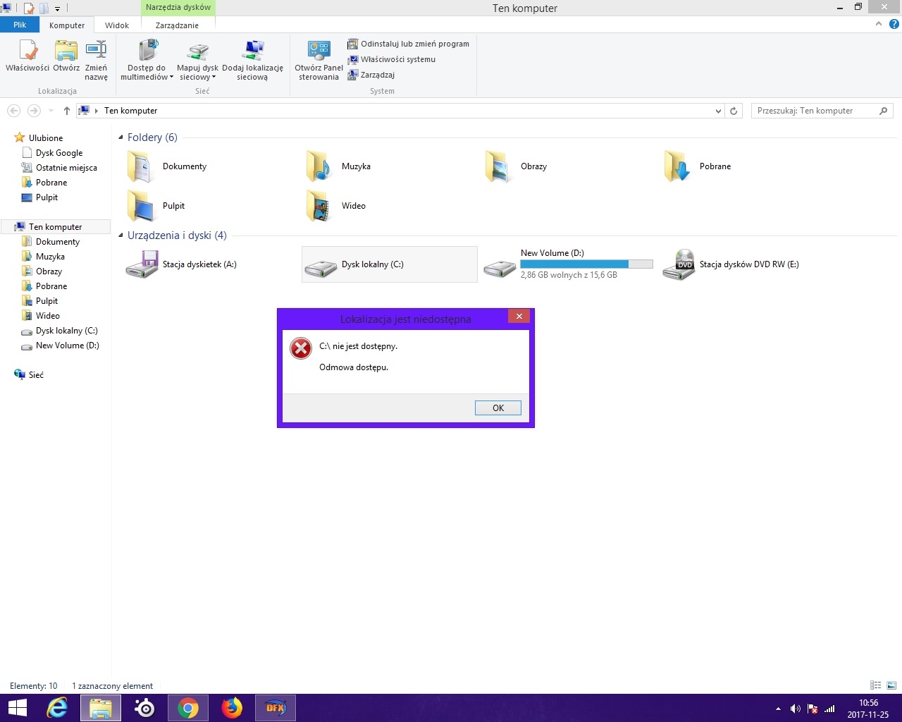

    Unfortunately, after creating a new account another problem arose, namely I do not have access to the C: \ (system) partition on the new account or the old one Can't Create New Folder on Desktop: MSI GT610, Asus M5A78L, Windows 8.1 Pro, 8GB DDR3 RAM
  • #7 16847854
    Kolobos
    IT specialist
    Posts: 85181
    Help: 17174
    Rate: 10460
    As it was written earlier:
    Add your user to C: \ and give yourself full rights to the directory and subdirectories.
