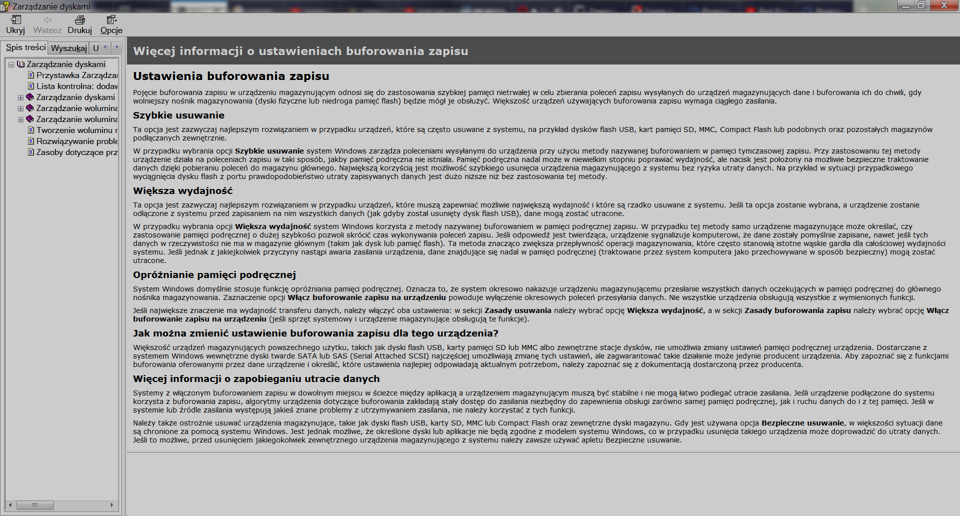

    The MBR boot sector was a problem, I fixed it in a hard disk manager paragon and the installation went, for now there is only one thing that surprises me, the system disk is in the tray on the right side of the beam and can be ejected, i.e. there is an option, but after selecting it it does not happen, the pendrive always goes out and disconnects physically, someone knows what's going on, the system disk should not be visible there.

    This is probably related to write caching.
    Installation of Windows 10 - We could not create a new partition or locate it
