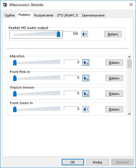

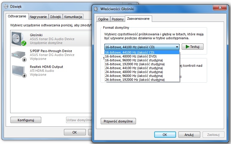

    Have you tried changing here:
    Crackling Noise During Volume Changes: Windows 10, MSI Z370 Pro Carbon AC, i8700k, GTX 1080
  • #12 16849808
    nu33ns
    Posts: 12
    safbot1st wrote:
    Now I understand what type of crackling it is.
    Yes, it did nothing.
    They also wrote to change the power efficiency to maximum, but nothing has changed either.

    nu33ns wrote:
    And how to disable CD/line in?
    realtek mixer?
    Properties -> Speakers -> Levels?
    It used to be under XP normal mixer - a row of sliders. Now it's a "circus on wheels" - not my fault - complain M$ ... ;)

    Whether on Chrome or EDGE and I start "waving" the volume slider (the one in the player or the one near the clock) I have cracks. This is not a hardware problem unless it is contagious ;)
    PS however it doesn't sound trivial - restart your computer (reboot option). Let me know if anything has changed.
    Nothing helped today I checked:
    - Reboot
    - VirtualBox Ubuntu (Firefox)
    -Ubuntu Flash (Firefox)
    -Other Browser (Win10)
    -Change the frequency
    -Change Power Efficiency
    - Reinstalling the driver from the manufacturer's website
    - Windows10 Default Driver
    -Change Output to optical
    None of the points mentioned above worked for me
