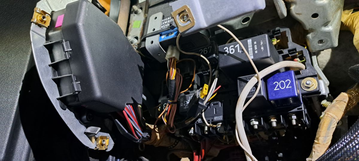

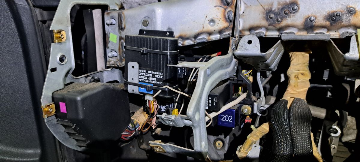

    Under the ECU are the ones on the left next to the fuses?
    I unscrewed the 2 on the left side and one on the right for the 16 key but somehow it still sits stiffly.
  • #32 20396330
    Ireneo
    Level 42  
    Posts: 7845
    Help: 747
    Rate: 2469
    Under the ecu for the cross and from the bottom next to the ecu for the key 10. Sixteen and one from the pedal bracket on the imbus. See the rest if I don't remember

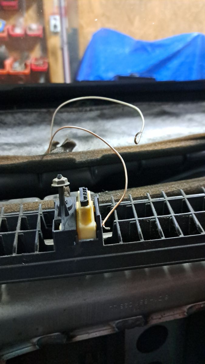

    And one more thing, when I pulled out the board, I tore the cables from the sensor in the grille in the one under the glass.
    How to connect it? :/
    Added after 11 [hours] 8 [minutes]:
    And one more question about the flaps in the air mixer, all flaps should be sealed?
  • #34 20397077
    Strumien swiadomosci swia
    Posts: 27581
    Help: 1405
    Rate: 6430
    post a photo of what you found there

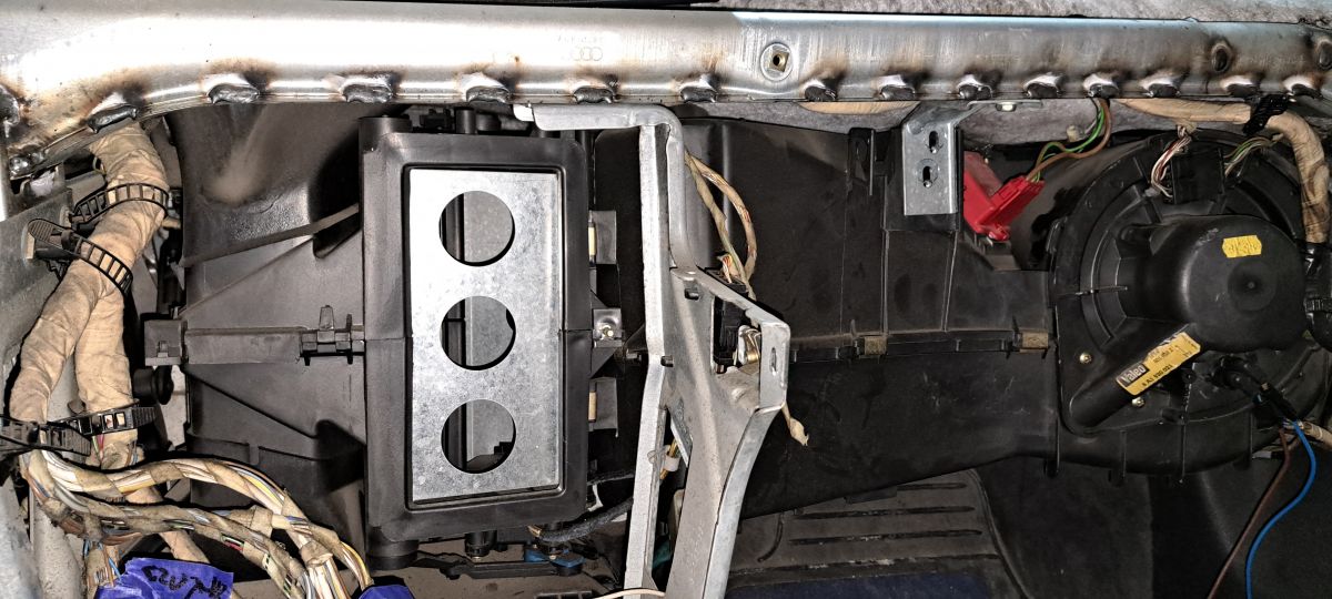

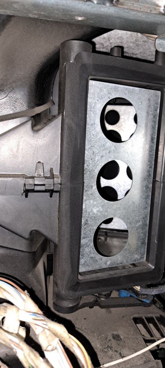

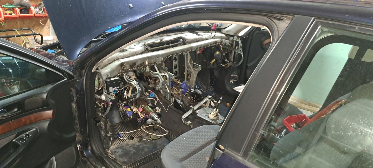

  • Heater core removed, asking about flap sealing
    #35 20397120
    michal8819
    Posts: 121
    Rate: 77
    No Hot Air in 1995 Audi A4 B5 1.6 Petrol: Cabin Heating Issue, Temperature at 90, Loose Plugin No Hot Air in 1995 Audi A4 B5 1.6 Petrol: Cabin Heating Issue, Temperature at 90, Loose Plugin No Hot Air in 1995 Audi A4 B5 1.6 Petrol: Cabin Heating Issue, Temperature at 90, Loose Plugin No Hot Air in 1995 Audi A4 B5 1.6 Petrol: Cabin Heating Issue, Temperature at 90, Loose Plugin No Hot Air in 1995 Audi A4 B5 1.6 Petrol: Cabin Heating Issue, Temperature at 90, Loose Plugin
    Added after 34 [minutes]:

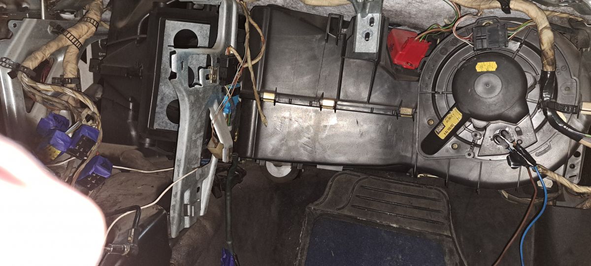

    It holds something on the left side, I don't know where the whole beam is, but on the left side, it seems to hold something and I can't pull it out and I don't want to break something No Hot Air in 1995 Audi A4 B5 1.6 Petrol: Cabin Heating Issue, Temperature at 90, Loose Plugin No Hot Air in 1995 Audi A4 B5 1.6 Petrol: Cabin Heating Issue, Temperature at 90, Loose Plugin
    Added after 49 [minutes]:
    Somehow it went although the left side holds the left side much more.
    Now they hold the wires from the air conditioning, where to unscrew them? The air conditioning still doesn't work.
    Added after 44 [minutes]:
    Okay, I pulled the heater out.
    At the very beginning, Stara beige liquid seems heavier.
    And now with those flaps that need to be sealed?
    All I see or what?
