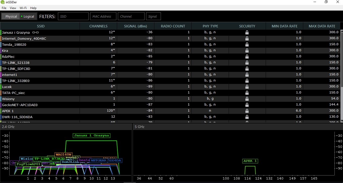

    I have a problem that irritates me more and more. Initially it was sporadic, and now it occurs daily. Well, after turning on the laptop, I can not see or cannot connect to the wifi network. After clicking "connect" several times, sometimes it works. Sometimes I have to turn off the wifi card in the network options, after a while turn on and then connects to wifi. I thought maybe windows 10 updated the driver, but not. All the time the same driver is. I didn't do any windows updates at that time. Any other device in the home connects immediately. I have "solved" this problem now: when I finish work, before shutting down the system and laptop, I turn off the wifi card. The next day, after turning on the laptop and loading the system, I turn on the wifi card and ... connects to the network the first time. It annoys me a bit, I would like everything to connect immediately after turning on the laptop and the first connection. The "connect automatically" option does not help. I always have to turn the card off and on. I tried to update the driver but it says that I have current. What to do ?

    Install inssider 2.x, scan the WIFI network, show results, enter the network name.

    does it have to be version 2.x? I have version 4.x on the disc from some newspapers
    I am asking because I managed (at my age it is a feat) to find the version 2.x but during installation I write that some fremwork 3.5 is required and if I download it when I click, I write that it cannot download :(
    can try this 4.x?
    4 I was able to install it and it looks like this: (my network is Janusz and grazyna) please do not laugh at the network I thought of it :)

    There can be several reasons for this. M.in:
    -weak signal
    -card driver does not work 100% correctly with this particular router (what?), given encryption, on a given channel.

    You can manually download the appropriate framework, but @bogiebog it's probably about
    signal strength
    channel
    other disruptive networks
    If you are able to eliminate these factors / provide helpful information, then you don't need inssider.
    What you can do now is change the channel and disable encryption diagnostics.
    And the swap driver.

    I was able to install version 4 because I have buy versions from some newspapers. I uploaded the scan above but what does this scan mean? I don't know what's going on.
    I changed the channel to the one that was least crowded. The application provided by phone and what channel it was and I did not know if it was good.
    On the other hand, if jeslikanal would be bad, why do others connect? on logic they would also have problems and everyone else (laptop, phone) connects immediately :)
